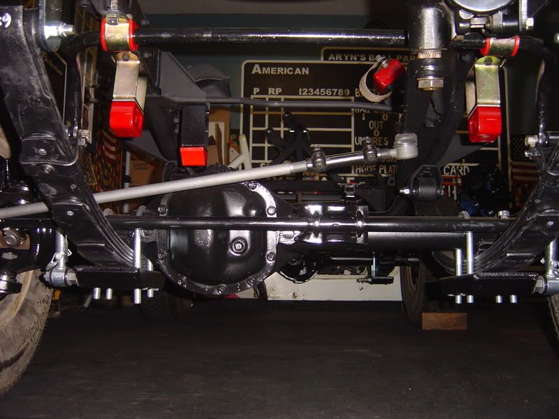

this is what your Dana 30 will look like:
and this is what the 2.72 gear set and carrier will look like
It will be stamped on the side of the gear
3 2084D 620664 A3R991 49 18 .... (the 49 18 is a 2.72 ratio) :
Nothing I own is that clean - WOW - Nice!
