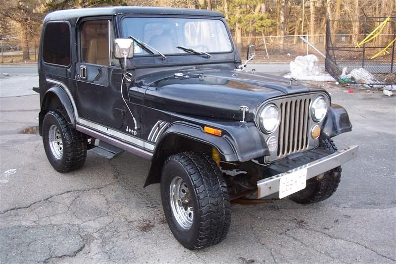

I did that to mine a couple years back.. I spent around $50 bucks on material and lots and lots of time. It works just fine for what we use our rigs for.
Before:
During:
After:
2 years later (now):

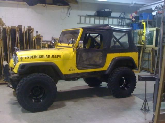

Hehe it's cool man. I needed something to break it up cause all that yellow in the sun was way too much reflection. So the black strip worked for me.
Looking forward to seeing how yours comes out! I think the "$50" pertains mostly to the "paint job" and not all the body work. With everything I probably spent the same amount as you, about $150 on everything.. but as fart as paint supplies go it was about $50 bucks. (rustoleum paint, rollers, mineral spirits, other misc stuff)
The guys at work called me crazy while I was doing it.. they kept looking at it halfway done and doubting the finished product. But everyone was real surprised with how it looked when I was done. I couldn't see paying maaco or someone similar $400-$500 for an "okay" paint job when I was just going to scratch it all up anyways. And plus I found the rustoleum paint is a heck of a lot more durable and scratch resistant in the woods than regular car paint.

Anywho, I reduced it down with mineral spirits. I only used primer in the places that I ground down to bare metal. (to remove the decals and stuff) I planned on doing a clear coat and never did.. it didn't fade too much. I never wash it either.
I think the number of coats is going to depend on how dark the jeep is to start with, and how much you reduce it down. I remember the first coat looked like I was just making a mess. Then the second coat it started looking better. I want to say I did 4 coats, but like I said.. it was reduced down a good amount.
