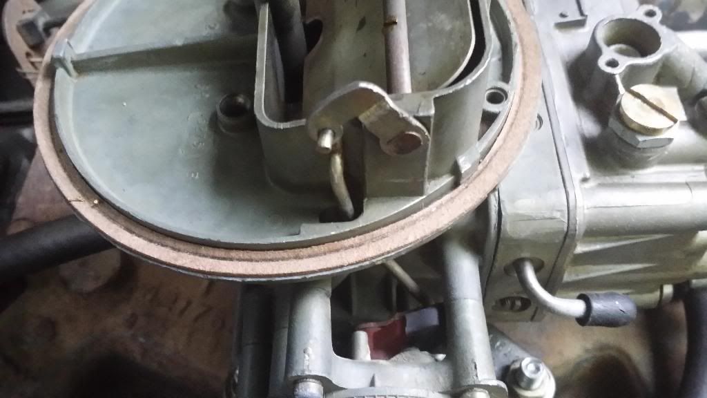

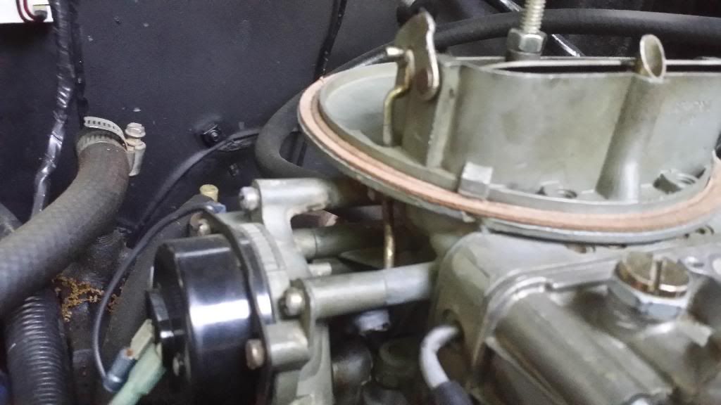

OK, so, we actually had a dry day today. Bad weather coming in tonight.
This morning I went out and took some photos.
Here's what the carb looked like before I did anything:
And here's after I pumped the pedal and then did the half pump (was I supposed to do the half pump?) and I turned the key to ON without cranking:
The angles aren't the same but in the second photo the flaps are less open....but I wouldn't say they're closed.
sabbyATL is offline

Sabby,
The choke plates should close fully, with light spring pressure, when you set the choke. When the engine fires, the choke pull-off should open the plates to about 1/8-1/4". As the engine warms up the choke plates should gradually open until they are straight up and down (fully open).
Your choke's thermal spring appears to be set too light, and isn't closing the plates fully. Tighten the spring until the choke plates close with slight spring pressure, and I bet your cold idle issues will improve.
Matt

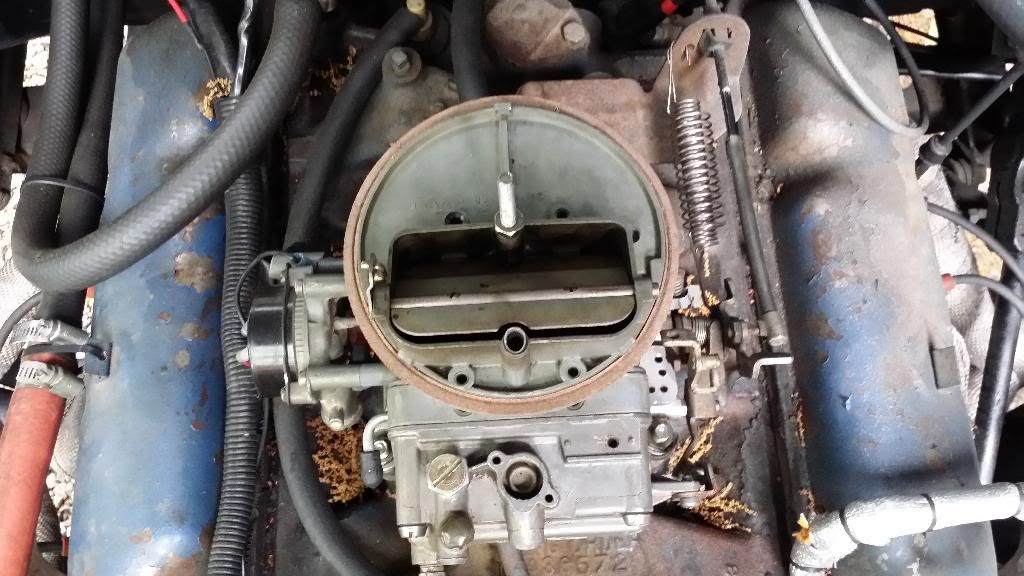

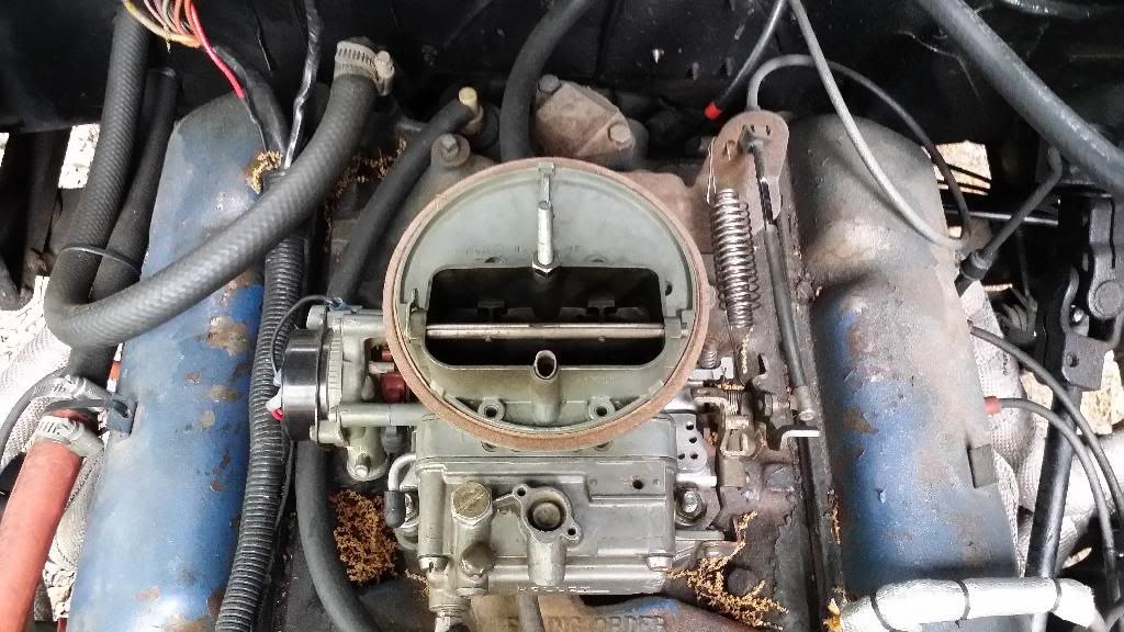

OK, so I thought this would be easy...that I would get out there and see I had to just turn a screw or something and the tension would change on the spring.
But, I don't know what I am doing. I can't see where to adjust it. Also, it looks like the starter (if that's the right name) is blocking the travel of the spring.
Here's what I'm seeing:
sabbyATL is offline
Ok, first you need to see if the choke plate will close by hand. If it will, it is not seized linkage. Then you need to loosen the three screws on that black round plastic cap with the one wire going to it. You then turn that until the choke plate closes with the throttle all the way open and tighten it down again. There should actually be a notch and lines on the edge. It should be 2 lines toward closed from center after the plate touches.
Mike

So, after reading some other guy talking about his choke plate I tried to close mine by hand and it won't budge. It will open more but it won't close more. Meaning, when I press the pedal to the floor and the plate moves to that not-closed position in the photos...from there I can easily re-open the plate by hand but I cannot close it all the way.
You need to maybe hold the throttle open when you are at the carb to let it close more, the fast idle cam hits the screw on the throttle linkage stopping the choke from closing more unless the throttle is open. Or..
That black plastic cap has a bimetal spring under it that moves the choke linkage as the power causes it to heat up. You may need to open it up so you can see what is binding up the choke, or just try turning it (clockwise) once loose to see if it moves the choke plate closed with the throttle held open. Someone may have just backed it off too much. It controls how rich it runs at idle, that is why it has the marks and arrow on its edge.
OK, I'll take a look at this Thursday. We've got those crazy tornado storms rolling through today and tonight and part of tomorrow.
But I'll use a brick to hold the throttle to the floor. If it doesn't close more then I'll open up that cap.
Thanks, again, for all your help!
Umm...there's no need for a brick, you can work the throttle at the carb by hand.
Secondly, you don't take the choke's thermal spring cap all the way off to adjust it. You simple loosen the screws, turn the cap, then tighten the screws back up. You'll be able to feel which direction makes the spring tighter.
Good luck,
Matt
