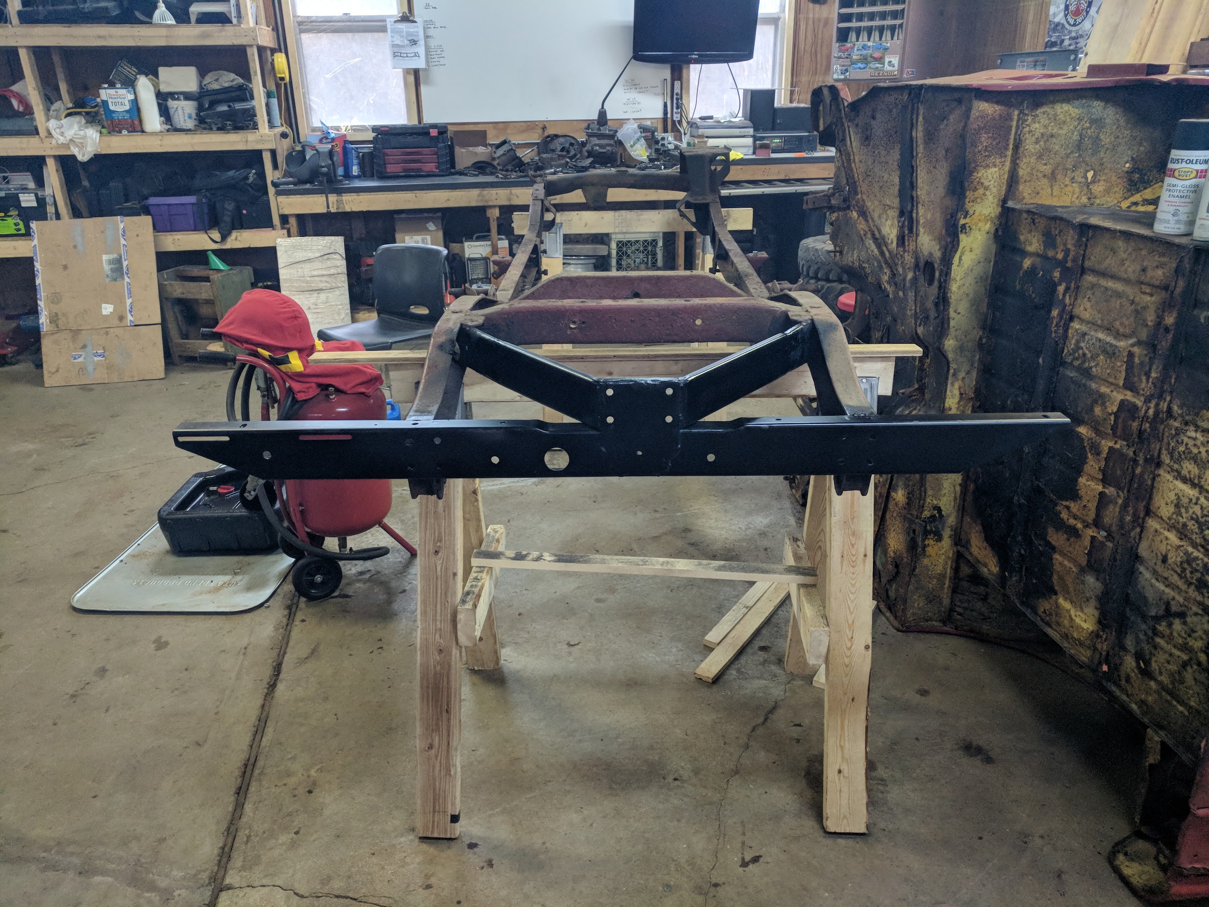

The project sat for about 8 months until January 2018. As usual, life and lack of funding get in the way. We stripped the Jeep down to the frame to ***** the condition of the chassis and the tub.
In addition to being from a CJ2A, the tub is pretty rough. Dented on pretty much every panel. So we're going to look for a CJ3A body or by a reproduction. Our goal now is to get a solid running chassis.
The frame is pretty rough as well. Years of abuse plowing have twisted the front some. The rear cross member and V-brace are mangled as well. Old parts were cut out and replaced with new. Still need to get the frame straightened and media blasted before we repair the front sections.
