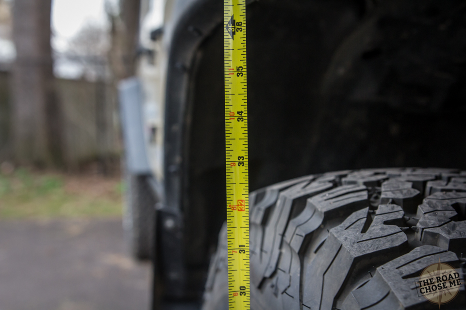

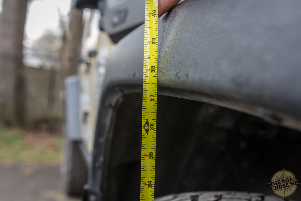

Some people asked for more details on the BFG KO2s in 34x10.5R17 that I'm running
My JKUR is heavy, I have not weighed it yet, but likely 5500-6000lbs I think.
I'm running 36 psi in the tires.
It was hard to hold the tape and the camera, the tires are 32" or maybe 32.25" at the highest point.
And with the AEV 2.5" lift, all four stock fender flares are smack on 37":
Let me know if there is anything else you want.
Height wise these are absolutely perfect for me, I am very, very happy with them now I've put a thousand miles on them.
