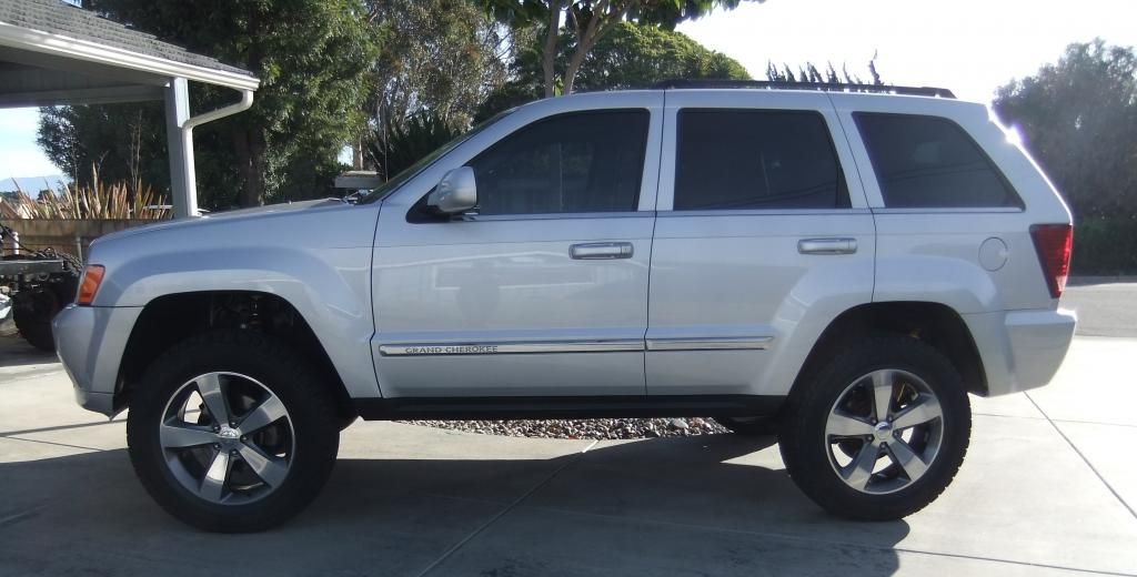

Does anybody have pics of or run 20" Chrome wheels from a WK2 on a WK?

I've seen one around IIRC.
Offset is +56mm and backspace around 6.7" for both the 18x8 and 20x8 wheels.
Spacers would be necessary.

https://www.jeepforum.com/forum/f67/2...-lift-2798202/
1.5" spidertrax spacers to eliminate rub with 275's

Thanks, this is a good start for me.
