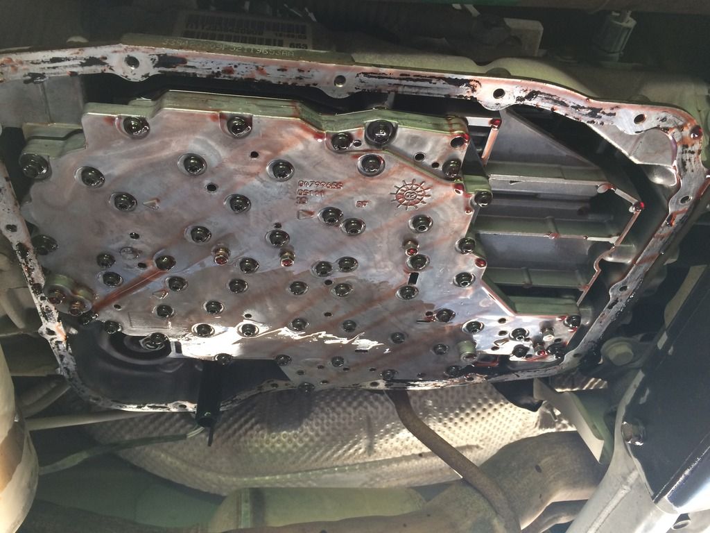

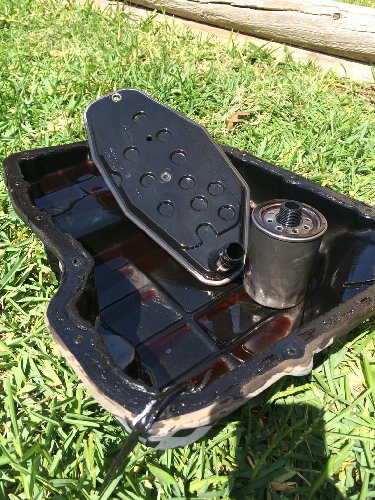

This past Saturday, I changed the engine oil/filter and the transmission fluid/filters.
Anybody know if the trans pan is sealed with black RTV from the factory? I thought it was supposed to be a gasket. Mine had sealant on the pan and no gasket. Just wondering.
Fluid didn't smell burnt, but it also wasn't a bright red color either. 171k miles and adding up quickly! Trans fluid change was about $85 worth of peace of mind!

When I did mine there was just sealant on it. When I put it back together I used a light coat of RTV to hold the gasket in place. I also bought a new trans pan with a drain for the next change.
