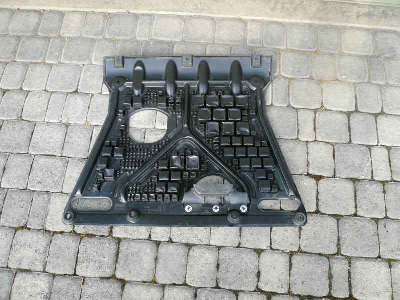

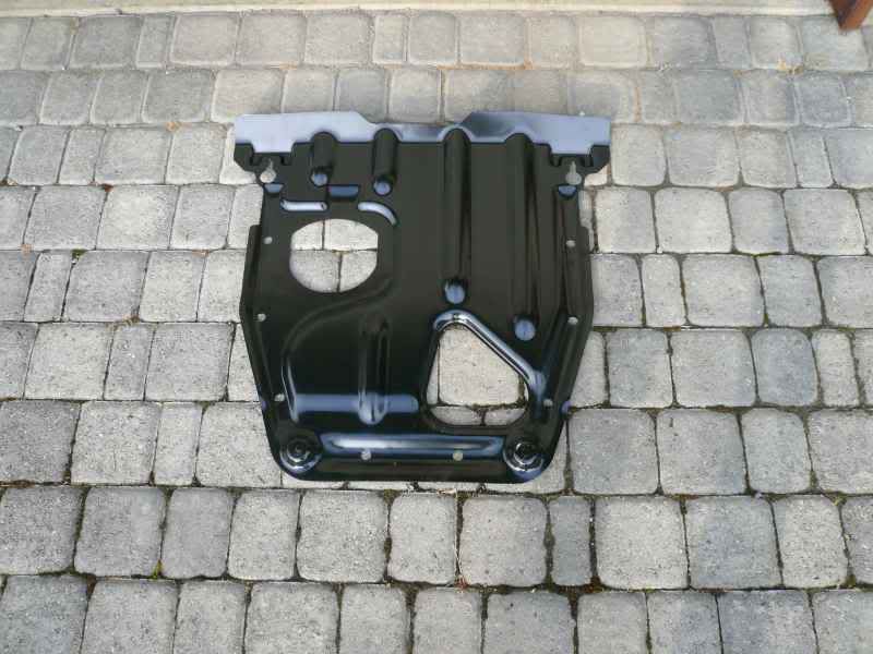

I replaced the plastic engine skid plate with a metal one on my 2007 CRD (left hand drive). Here are some photos of the old and new versions.
Old plastic skid plate:
New metal skid plate:

Thanks for that it was a great help, i would have to say they look identical

did the other plastic splash gaurd behind this one still fit? it looks like the rolled edge at the back end would stop the other splash gaurd from fitting?
is the plastic engine skid plate from an 07 and the metal one from an 08? or are they both from an 07 and the metal is an upgrade?
you see on the 07 crd skid plate, it has the oil drain deflector that I have on the 08 crd skid plate? My 08 crd skid plate also has a noise deflector padding, all it does is hold the dirt and oil.
I should crawl under my jeep and take a closer look, it seems to me the front of my 08 skid plate has extra holes for some deflector that is under the front air dam, like what you see on the plastic skid plate. Also, I thought my 08 skid plate was wider at the back. I've taken the skid plate out twice, but I've not taken any photos.
I was able to tuck the plastic splash guard under the edge of the metal skid plate. The mounting holes don't line up but it seems to be captured very securely.
yeah, that is at the front. as I said in my other post, my 08 metal skid plate has holes in the front to attach plastic guard that goes under the front air dam.
