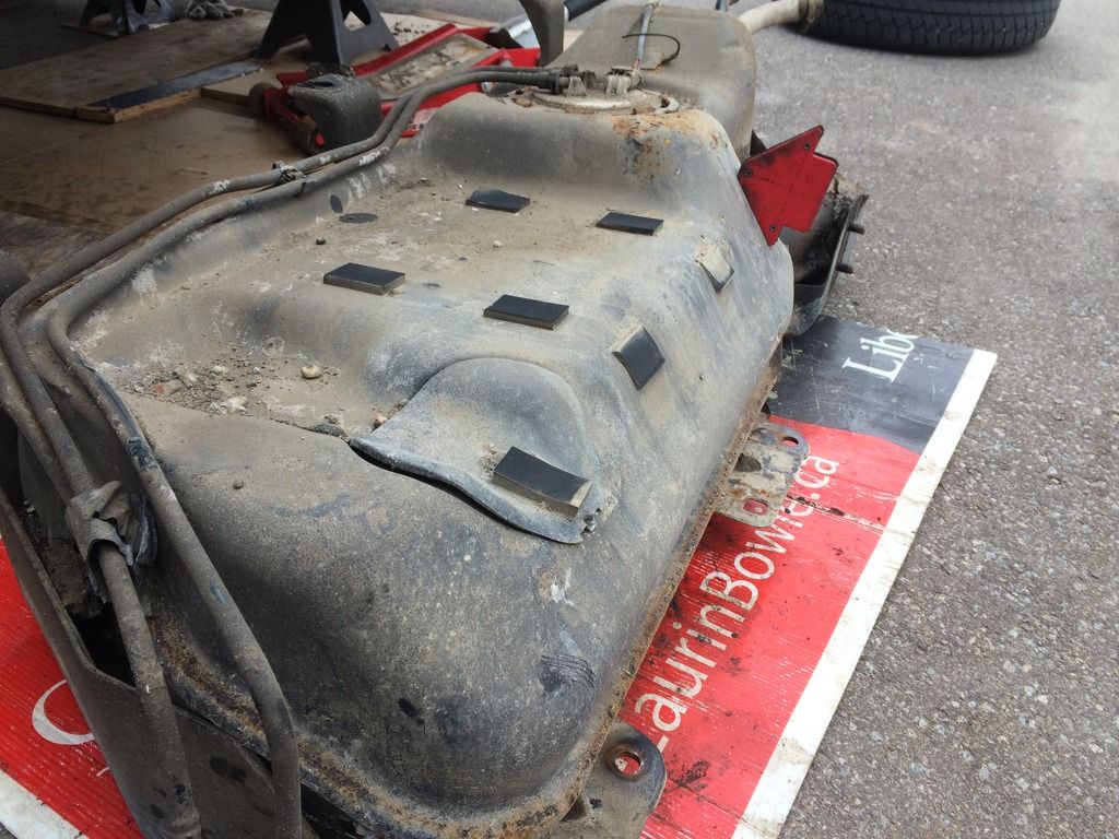

That pic is just to prove to some hard headed people on here that yes, it IS a steel tank, you can see the welding magnet stuck to its side.

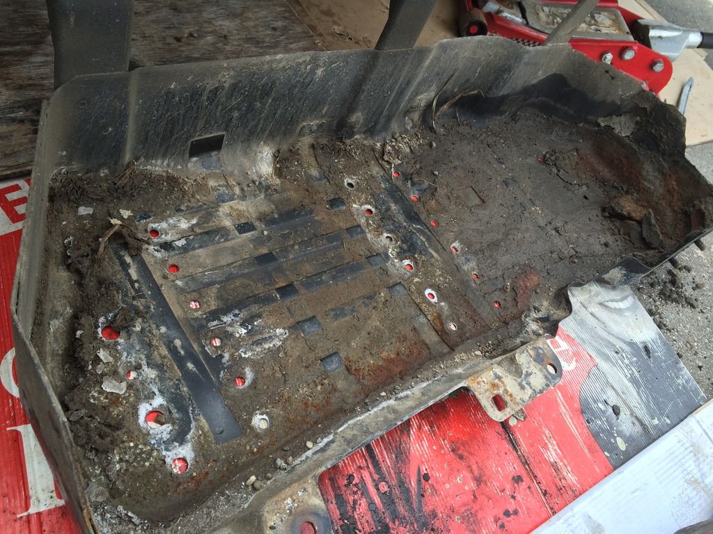

This is what was under the tank
I scrapped up and took out over 10lbs of sand, mud and pebbles from under the tank.

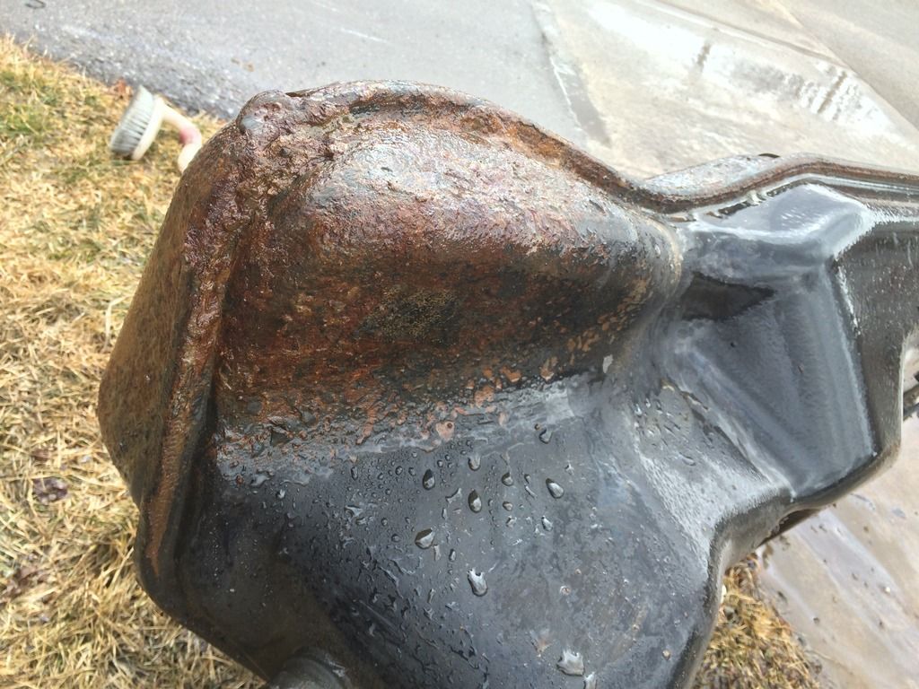

After cleaning it off this is what welcomed me
I was hoping that it was gonna be a small pin hole leak or something i can fix real quick but now i'm not so sure.

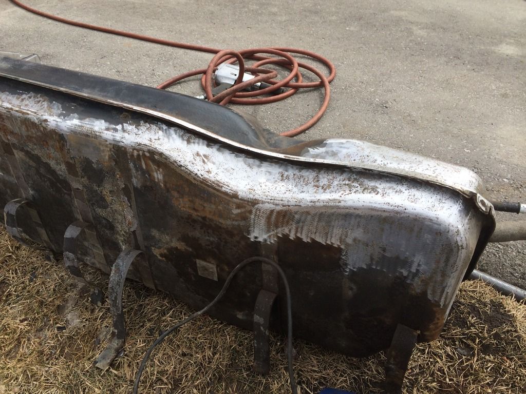

Here's what it looked like after 2 hours of grinding away rust

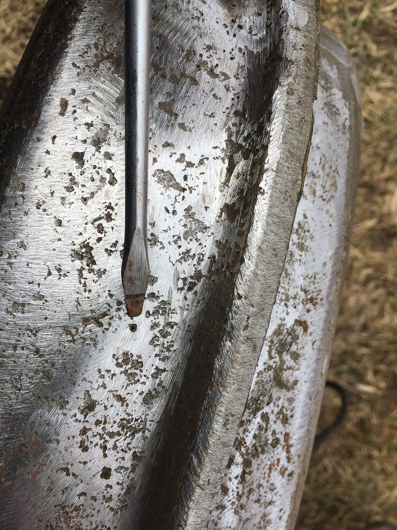

Thats the actual hole
Its on the side of the tank on the upper "clam". There are several more spots that have rusted enough to be problematic.

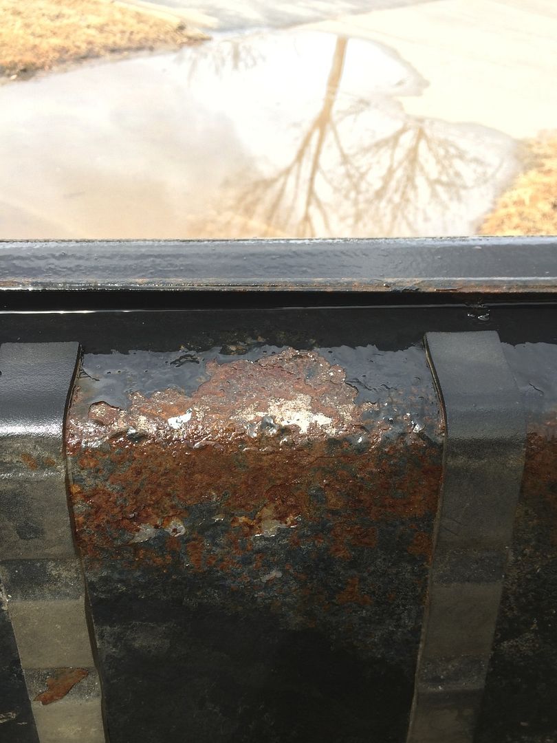

I've welded the pin closed and ground it down then covered all exposed metal with PRC 1422 class B. Its aircraft grade sealer i used while doing aircraft maintenance. Its the cats *** designed specifically to seal aircraft tanks. Jet A and Diesel are so close to each other that for all intents and purposes they are the same minus the lubricity additive to diesel.

cant really paint with it. Its hella expensive (this is where still having boys in aircraft maintenance comes in handy), and it has consistency of JB-weld.
Cool thing about it is that it comes packaged ready to mix, you depress a plunger which shoots one mix into the other then the outer portion of the plunger becomes a mixing rod that you pump in and out to thoroughly mix the epoxy.
I'll take pics tomorrow but anywhere it was rusting on the sides and underneath i ground down and pasted on the PRC.
Once cured i will spray bed liner on the skid and tank to finish the protective layer.
