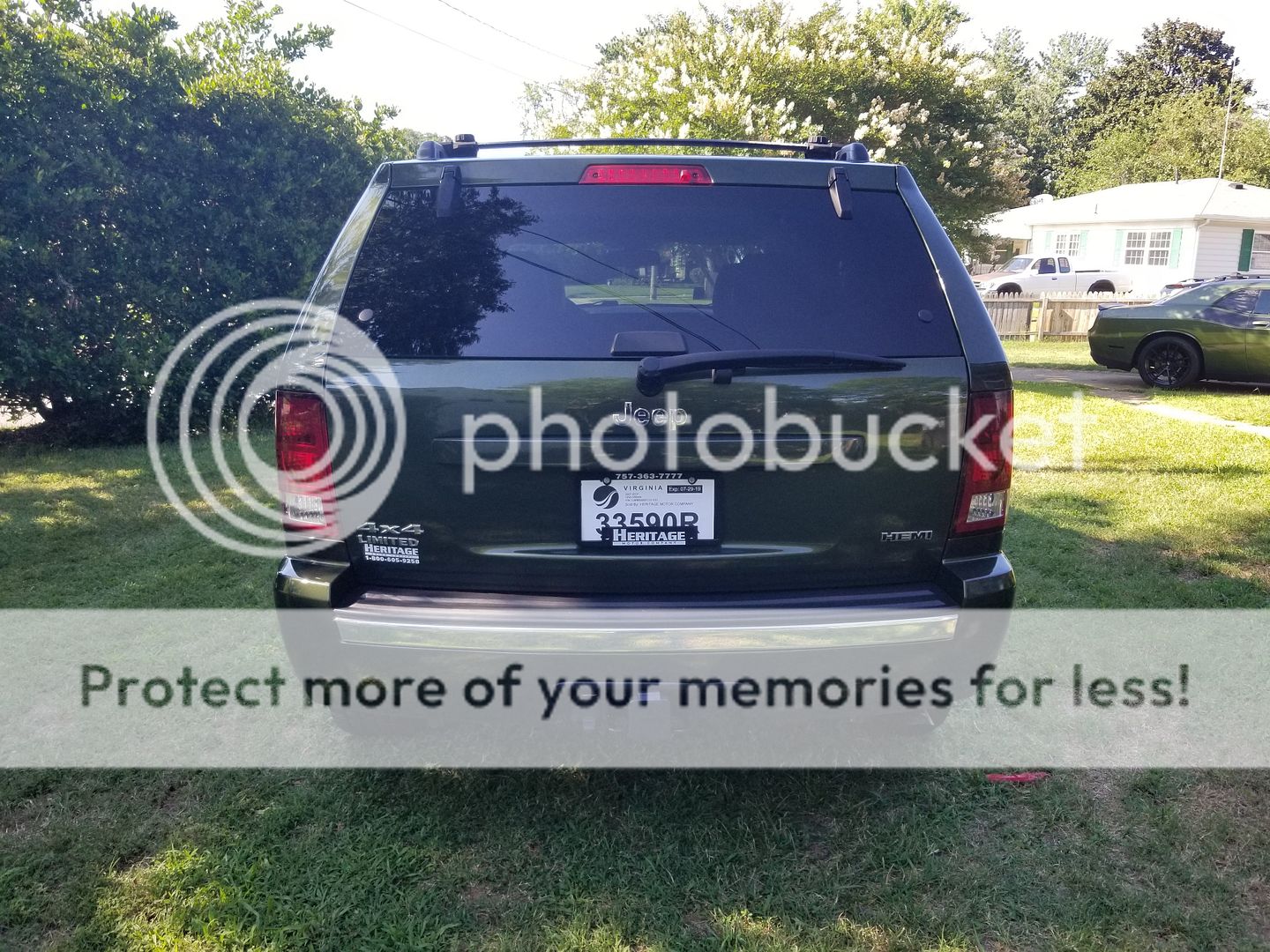

I plan on using this thread to document things as I go.
Purchased 29 June 2019 with 114,421 miles
[front quarter picture] [IMG][/IMG]
[head on picture] [IMG][/IMG]
[rear quarter picture] [IMG][/IMG]
[rear picture] [IMG][/IMG]
