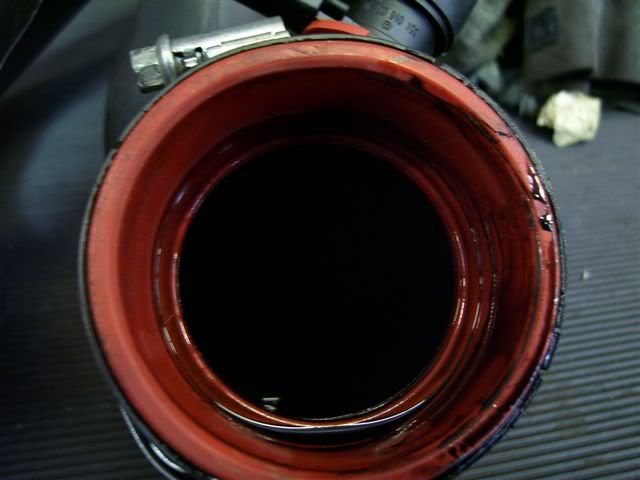

Ok see if this works, I do miss being a member.
you will see the new one (black) the pipe will go face to face with the turbo and the seal only goes around the outside.
Also I fitted this one to an 05 under warranty for an oil leak that I had already change the pipe before to try and fix this issue.

0.3 to fit (1 bolt 2 clips) part number 53013672AE if you have an orange seal it's the old pipe black new pipe. The oil is most likely what you smell, see my swirl motor post to see the oil mess burning this leek makes. The oil will then go into the intake so still not good but better then a swirl motor.

As I understand, the new seal & air intake tube design just fixes the issue of the blow by oil seeping out of the connection where the air intake tube fits onto the turbo. But "Blow By" vapors/oil from the crankcase still move from the passenger side valve cover, thru the black round PCV valve, and thru the black hose that joins the air intake tube right in front of the turbo. The blow by gases (oil/water/fuel vapor) still get sucked into the intake and then into the turbo. Still a bad thing as I understand it, it now just doesn't leak out all over the engine. The CCV filter system is still needed to eliminate the blow by oil/vapor from re-entering the engine...
