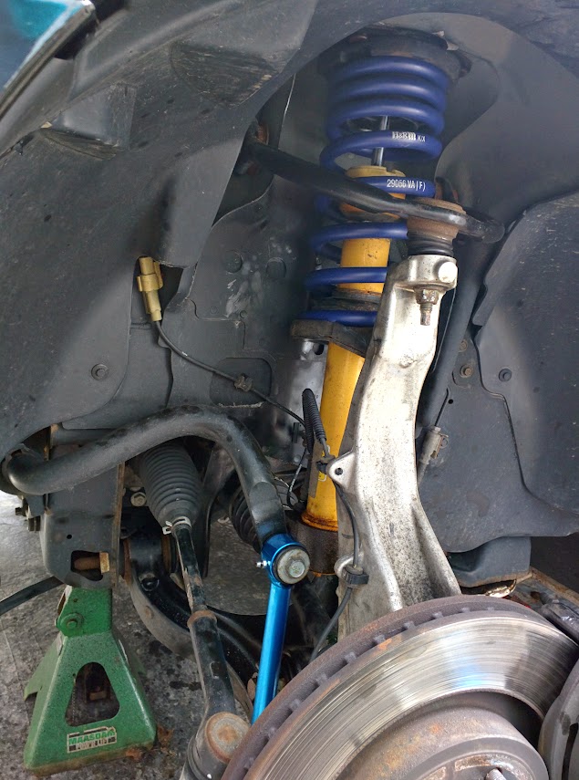

I started off with the driver side front, I knew that was the biggest *****. The fuse boxes and fuse box retainer are all in the way of the strut mount bolts and getting to the UCA bolts was a huge problem working on my own. I ended up using vice grips to hold the UCA bolts to act as a second pair of hands as I also did not want to lean on the Jeep's paint trying to hold the nut on one side and spin the bolt on the other. With the UCA out, sway bar disconnected, and the strut bolts disconnected, I was able to drop the LCA enough to compress and remove the OEM coil spring without removing the entire strut assembly. I was really happy with this because I didn't have to remove the clevis bolt in the LCA which is almost always seized in there. Then I just used a few layers of masking tape when compressing the new coils to protect the finish. It was smooth sailing from there!

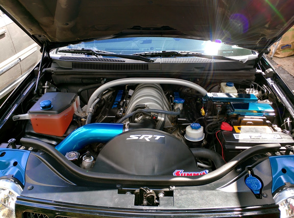

Next was the passenger side front. With his Bwoody CAI, the UCA bolts were extremely easy to access and the only thing in the way of the strut mount bolts was the antifreeze reservoir. I probably spent half of the time on this side that I did the last.

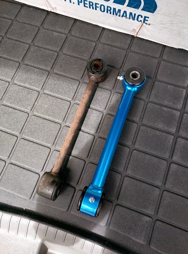

The new end links were almost twice as beefy as the OEM ones and make the old ones look silly.

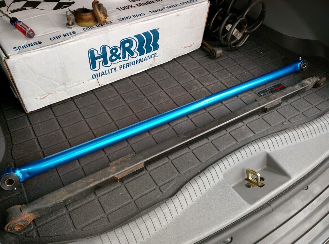

Last was the track bar which was noticeably lighter than stock.
