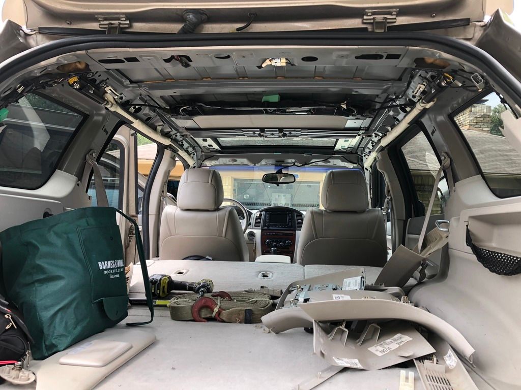

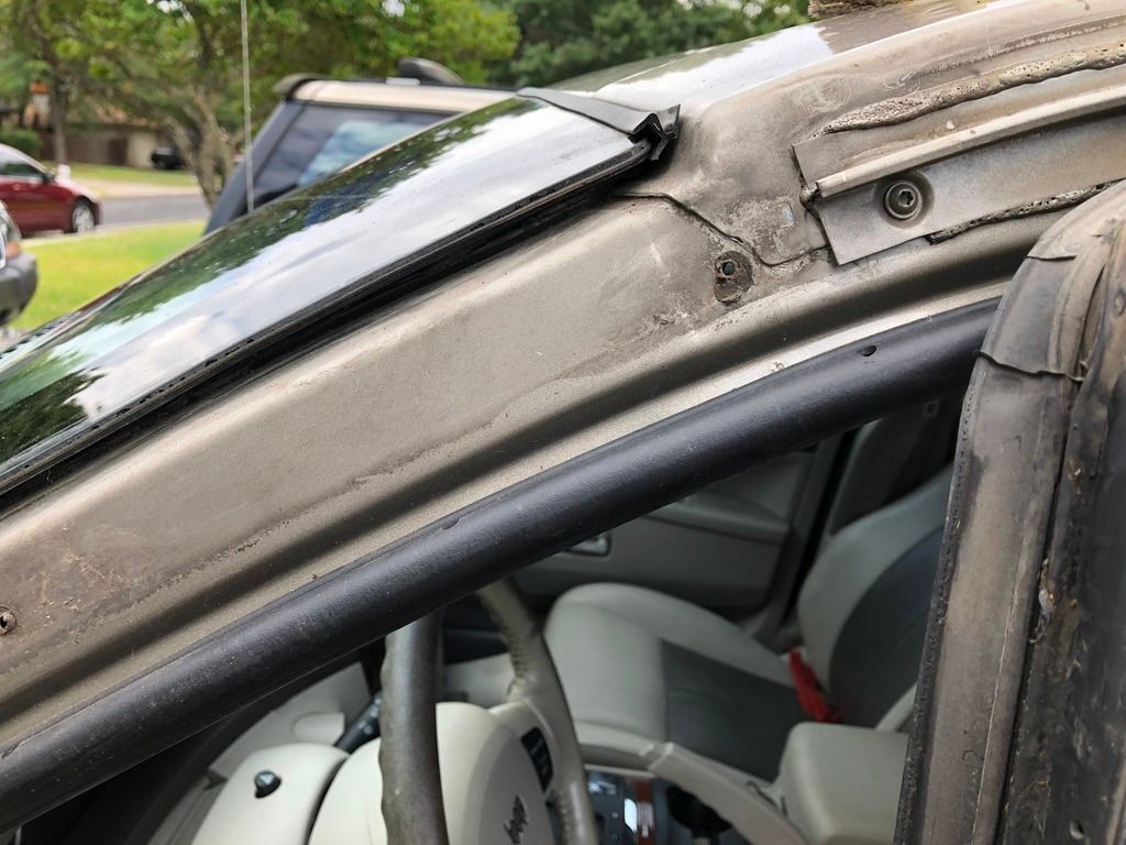

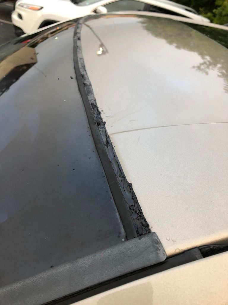

New item to be added to list:
So for about 8 months now, I've noticed a small leak coming off the top portion of the Driver's A-pillar when going thru a car wash, or after a hard rain. Just like you're thinking right now, I originally thought if was sunroof drain related. But I've been blowing out the front drains for the last 2 years now and I know they're clean. Also pulled the drain out of the floor and it has no restriction on the end. But I still get a leak, although somewhat inconsistent.
Fast forward to this past Monday morning (9/3/18) and we get a much needed heavy downpour. I was already planning to change the oil that day and I get in the Jeep only to find out that water has dripped out of the upper mounting bolt location on the driver's A-pillar and into the dash cubby and then on to the floor.
Oil change morphed into pulling the headliner to try and track this down.
After a couple hours with a hose running trying to pin-point the actual leak (my sunroof drains stayed dry this entire time), it finally showed up. My windshield is leaking from around the top driver's corner under the sealant and then seeping in through the body seams just above the sun visor mount. (Not the screw hole that you see here, but under the glass)
Time to fix it...
Had to hit a 2nd time last night, but I think I've got it all covered now (cross my fingers). I squeezed this window sealant into, behind, and completely on top of the upper windshield seal and then down the sides. I also ran a long bead of it inside along the top of the glass/body seal.
It's not my best work, but this stuff is very sticky until cured, and clean-up is a real pain. If this doesn't stop the leaking, then my only other option is a full replacement of the windshield...

Wow, you really hit it hard!!! You tore that headliner up!
I know that black strip on the top was deleted after 2005. I hate to ask after the fact, but do you think you could have removed that black plastic strip before applying your fix? It looks like you've filled that void with caulk so you probably nailed it.

How difficult and how long did it take to remove the headliner?
If you notice on the side-view pic of the windshield, there is a lip that appears to sit under the top edge of the glass. Well, it does and is subsequently stuck in the goo that the factory used to seal the glass to the body. I tried... It didn't budge!
After the first attempt at putting sealant behind that strip ultimately failed, I decided to fill it up and extend it at least an 1/8" onto the paint.
As of this afternoon's car wash and last night's dowsing with a hose for 30 mins, I have no more leaks!!! Time to put it all back together.
It was about 1-1/2 hrs total to take it out. I've done this sort of thing before, but I still spent about 10 mins studying it ahead of time so I didn't get stumped mid-stream.
A-pillar covers, C-pillar covers, and rear D-pillar covers have to be removed. C-pillars can hang as seatbelts go thru them. The B-pillar covers I loosened, but used them to help hold the headliner while I disconnected all the wires. You can then push them in and out of the way of the headliner as they don't tend to want to move much because of the seatbelts and the lower portion of the covers (to the floor).
I have a sunroof control in the upper console and a DVD screen that all had to be removed also so that took an extra couple minutes. Lots of wires... There is a wire harness that runs along the driver's side of the headliner that plugs in at the D-pillar in the back. 3 plug connections, although I'm still unsure what all I disconnected - radio/speakers all work, rear defrost works, rear wiper works. You'll also have to disconnect the rear-wiper-spit tube. It has a disconnect right behind the 3rd brake light on the hatch, and also on the driver's A-pillar.
At the rear most side-window portion of the headliner, there is a small plastic strip that is screwed in place. It is about 1" wide x 14" long and on both sides of the headliner (Right & Left, and top & bottom - 3 screws each). Once removed, you'll see 3 oblong holes in the headliner in line with each other. You will have to fold over the outer edge of the headliner at these holes in order to squeeze it out thru the back of the vehicle. There is no other way to get it out. Any crease in the headliner because of the fold will be covered back up by those plastic strips.
I did it by myself, but it definitely would have been easier with an extra pair of hands...
