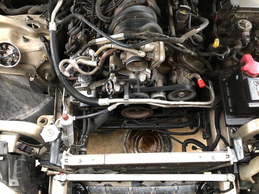

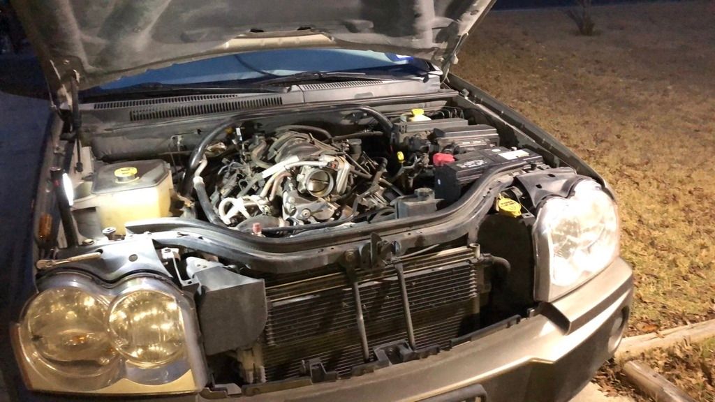

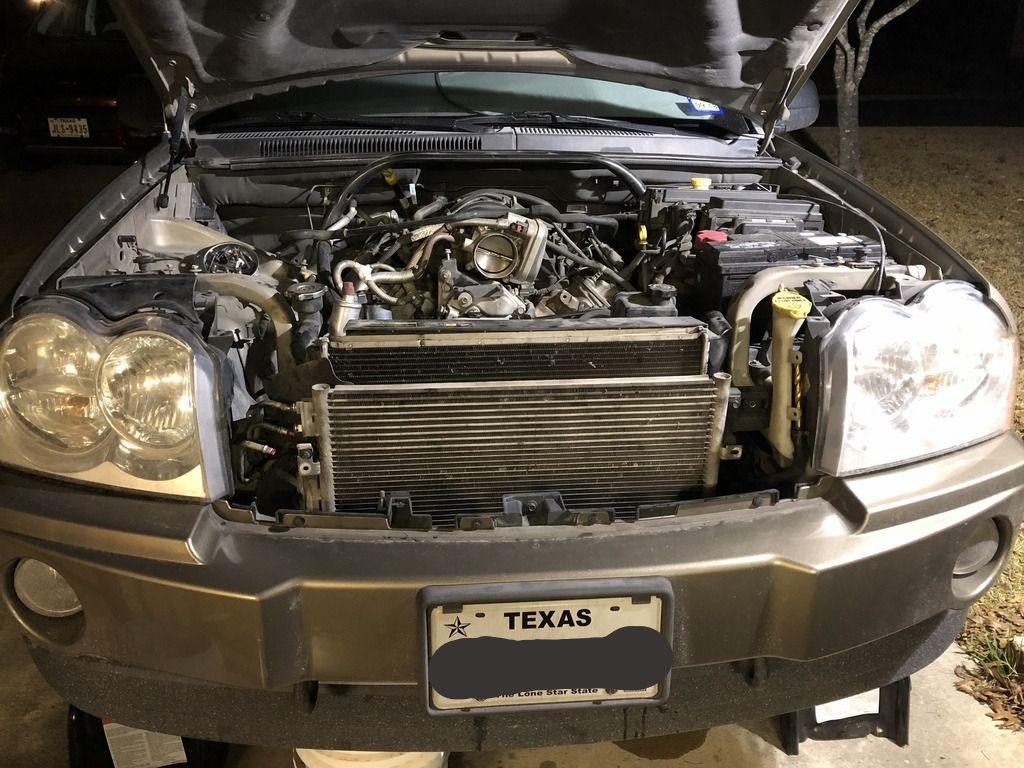

Hemi radiator replacement
Started the process of removing my radiator out of the GC last night.
Got started at 6:30 pm with this...
At 8:15 pm, I decided to stop for the night and was at this point...
2 hrs of work and it really doesn't look like much is done! But...
I have the power steering cooler removed, air box removed, coolant tank removed, core support cross-member removed, trans lines disconnected, radiator unbolted, fan shroud unbolted.
The radiator is very close to coming out. But I need to disconnect the power steering lines from the fan shroud and move it out of the way. With an extra set of hands, I could probably pull the radiator out as it sits, but that would required holding the fan shroud back towards the engine enough to wiggle the radiator out.
I'm going to take my time and do this the right way... Plan is to continue again on Saturday morning. (We have rodeo and a concert tonight!)

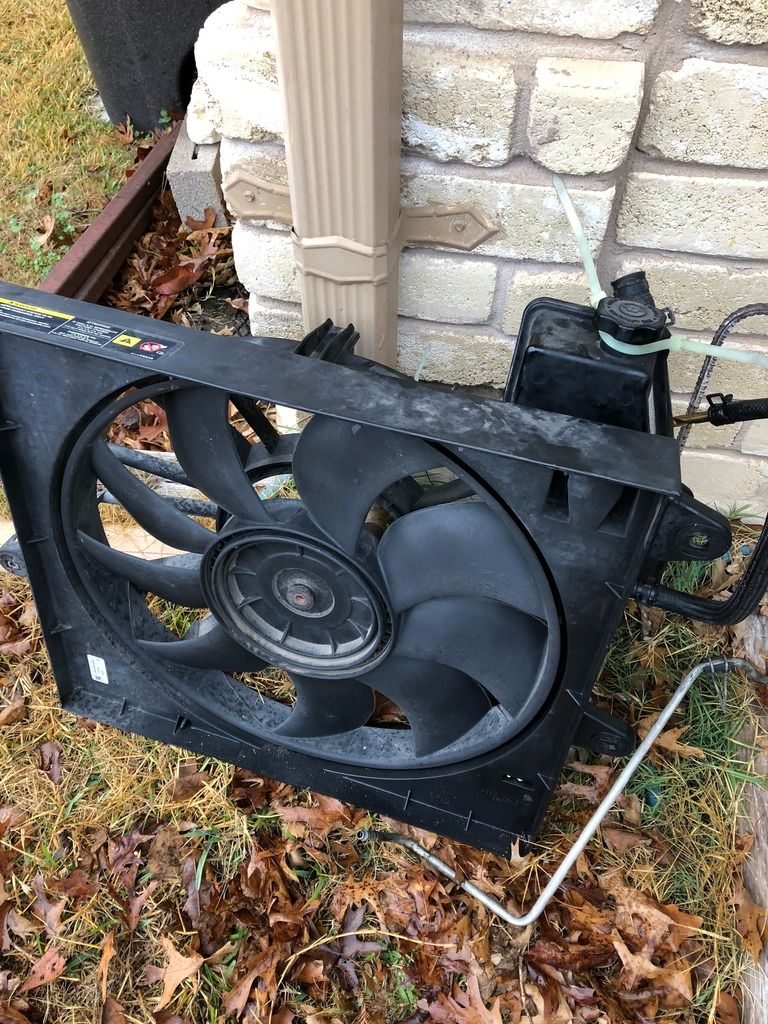

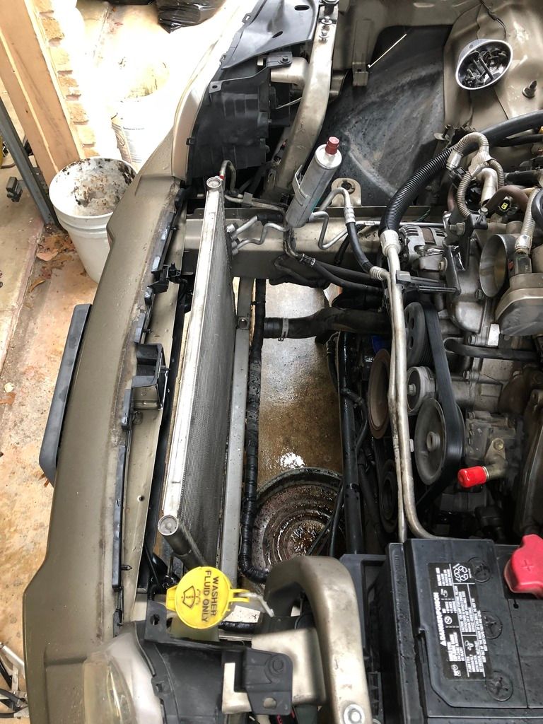

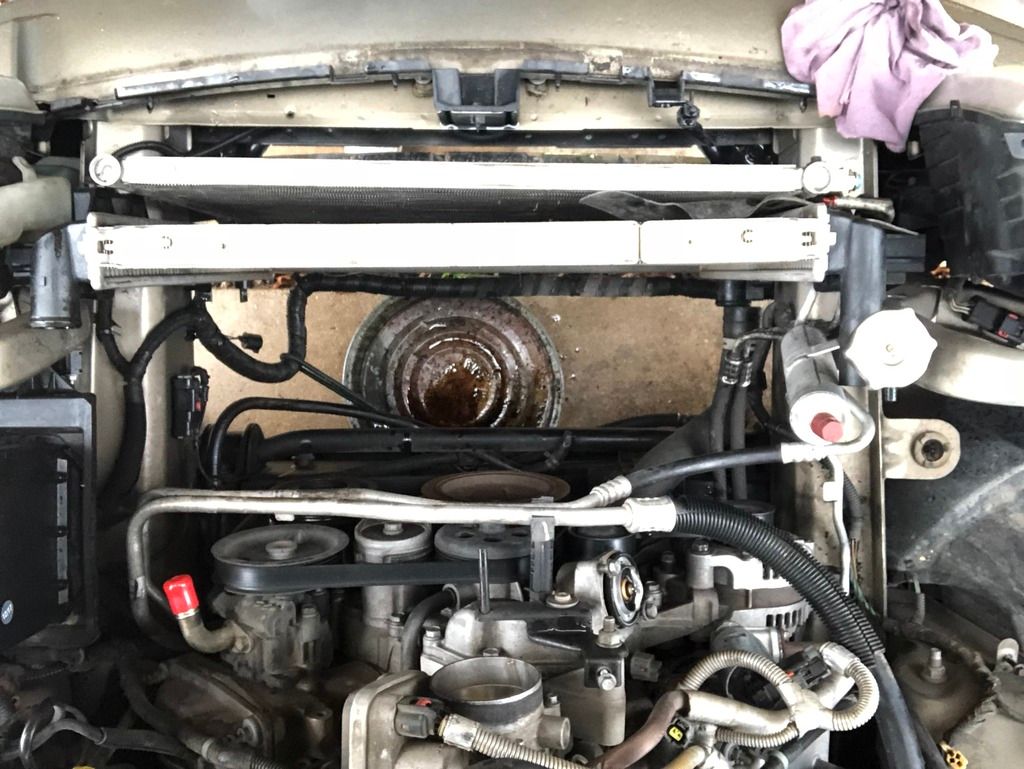

Got back into my radiator replacement struggles again on Saturday!

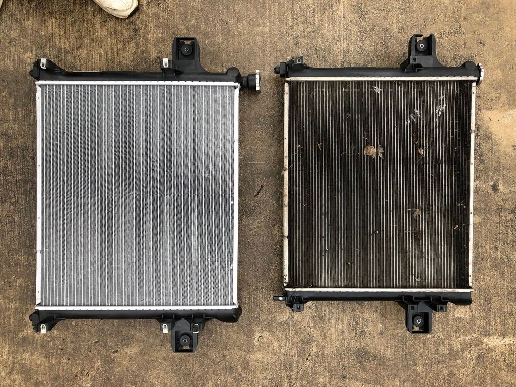

Decided I wasn't going to half-a** the process and went ahead and pulled this ugly beast out of my way. It really wasn't hard to disconnect all the lines. I did not use a tool, just used a pick on the retainer clips and it all came apart relatively easy...
Once out the way, you can really see how much more room you have to work the radiator out of the way. Now I don't have to worry about damaging the AC condenser...
Radiator is out!
Side by side comparison. New replacement (left) is a Mopar unit. Looks bigger in the pic, but they are identical. Older & dirty one on the right.
After a total of 6-1/2 hours of work (3 hrs to get out, 3 hrs to get back in, plus a little clean-up time...), it's was finally all back together!
I initially figured on between 6-8 hours to complete the job. Taking the fan unit out added some time, but made all the difference in making the job easier! I wouldn't suggest trying to wiggle the radiator out with it in place. Just not worth the struggle.

post #22 of 54 Old 02-12-2018, 08:38 AM Thread Starter
99sajeep
99sajeep's Avatar
2005 WK
Location: San Antonio
Posts: 641
One other thing...in pulling the fan unit out, I discovered a damaged o-ring on the pressure line coming off the power steering pump. The o-ring was hard and had a small kink in it from previous work done by others. This helps to explain why some of my power steering lines always had some oil on them. Never was a big enough leak to worry about, but at least I now know the reason.
If I hadn't pulled the fan out, I never would have seen it. Now I have a new o-ring and everything is clean.

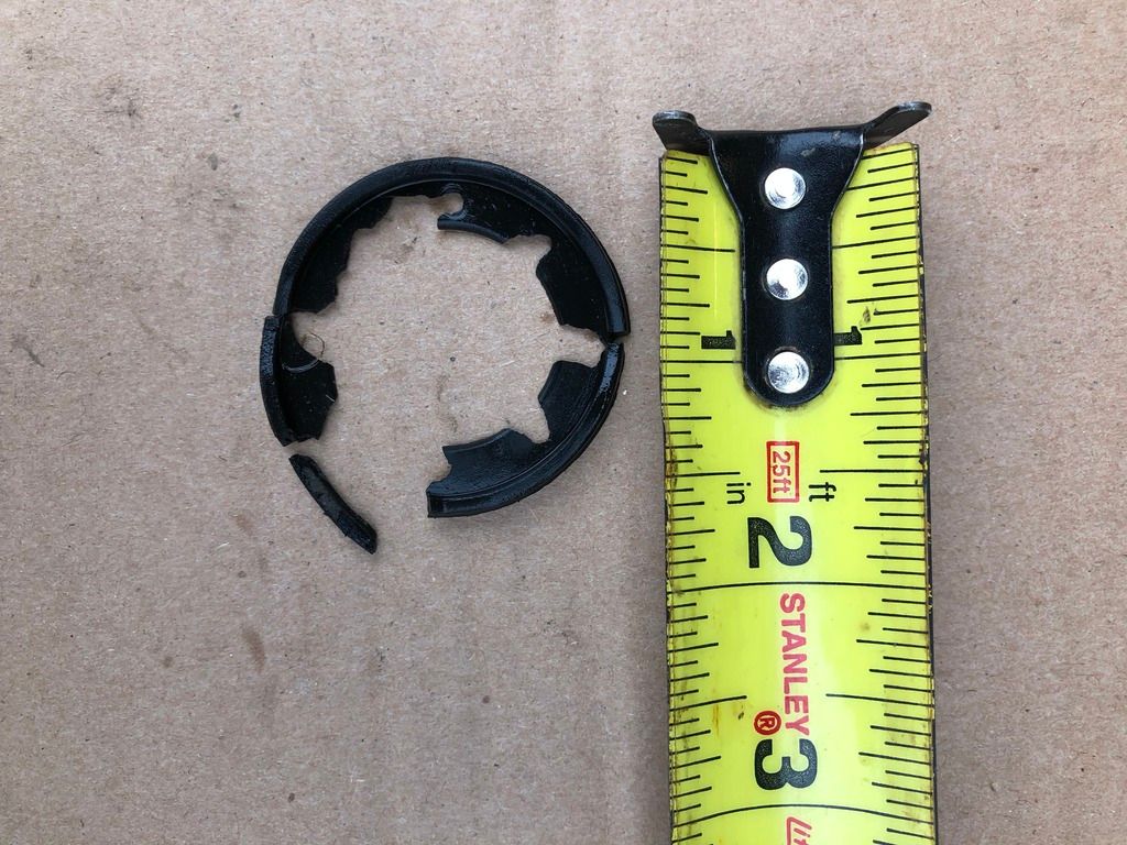

So...
I was tearing my old radiator apart last night (1) to see what it looked like inside for corrosion, etc., and (2) to take the plastic tanks off so I could scrap it at a recycle place.
It was pretty clean in the core, but down at the bottom of the driver's side tank, right near the drain, I found this:
Parts of it were wedged into the core tubes, but most of it was lying in the tank. It is rubber, fairly thin, and still pliable.
Anybody have a clue what it is for and how it got into my cooling system?

post #26 of 54 Old 03-17-2018, 12:06 PM
brent_m
Join Date: Apr 2016
Posts: 135
it looks like it was chopped up in the impeller. but could it be the remains of a failed radiator cap seal? or perhaps a thermostat seal?

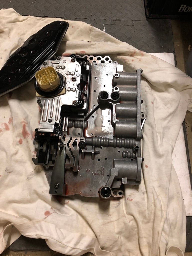

post #28 of 54 Old 04-06-2018, 08:11 AM Thread Starter
99sajeep
99sajeep's Avatar
2005 WK
Posts: 641
(This is mentioned in another thread, but I'm putting it here also...)
Well...
The code did come back. On 3/25 it hit again. This time it stayed. Jeep continued to stay locked in 3rd no matter how many times I cleared the code. Same code: P0750 Switch Solenoid A
So I ordered a kit: http://www.cascadetransmissionparts....icekit4wd.aspx
Only took about 4 days (free shipping - Priority Mail) to get to from Oregon to TX. I went ahead and ordered the kit with the filters even though my current filters had less than 15k miles on them. One of those "I'm in there already!" moments. I also ordered a drain plug kit ($17) to mount into my pan.
But then life got in the way and it took me a few days to get started on the replacement.
Pulled the valve body out this past Tuesday evening. Was able to save most of the fluid, and got it all put back together last night.
Driving to work this morning, all appears to be normal and the tranny is shifting really smooth.
I was having some hard 3-4 shifts (at light throttle) last year after replacing my fluid & filters. Those shifts got better with mileage, but would still creep back every once in awhile. Driving around last night and this morning, I can't remember when the last time this transmission shifted so smoothly!
Also, at highway speeds, it doesn't appear to "hunt" around between 4-5 as much as it did before. But I might be a little over-critical right now.
Maybe that was all a sign that the switch solenoid was starting to go bad...
I'll keep putting some miles on the Jeep over the next few days and keep an eye on things. I'm trying not to get too excited too quickly!
'99 WJ 4x4 Ltd 4.7L (sold)
'05 WK 4x4 Ltd 5.7L (mine) 200k+ club
'01 WJ 4x4 Laredo 4.7L (daughter)
99sajeep is online now
post #29 of 54 Old 04-06-2018, 08:57 AM Thread Starter
99sajeep
99sajeep's Avatar
2005 WK
Posts: 641

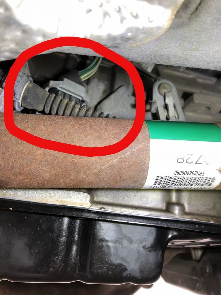

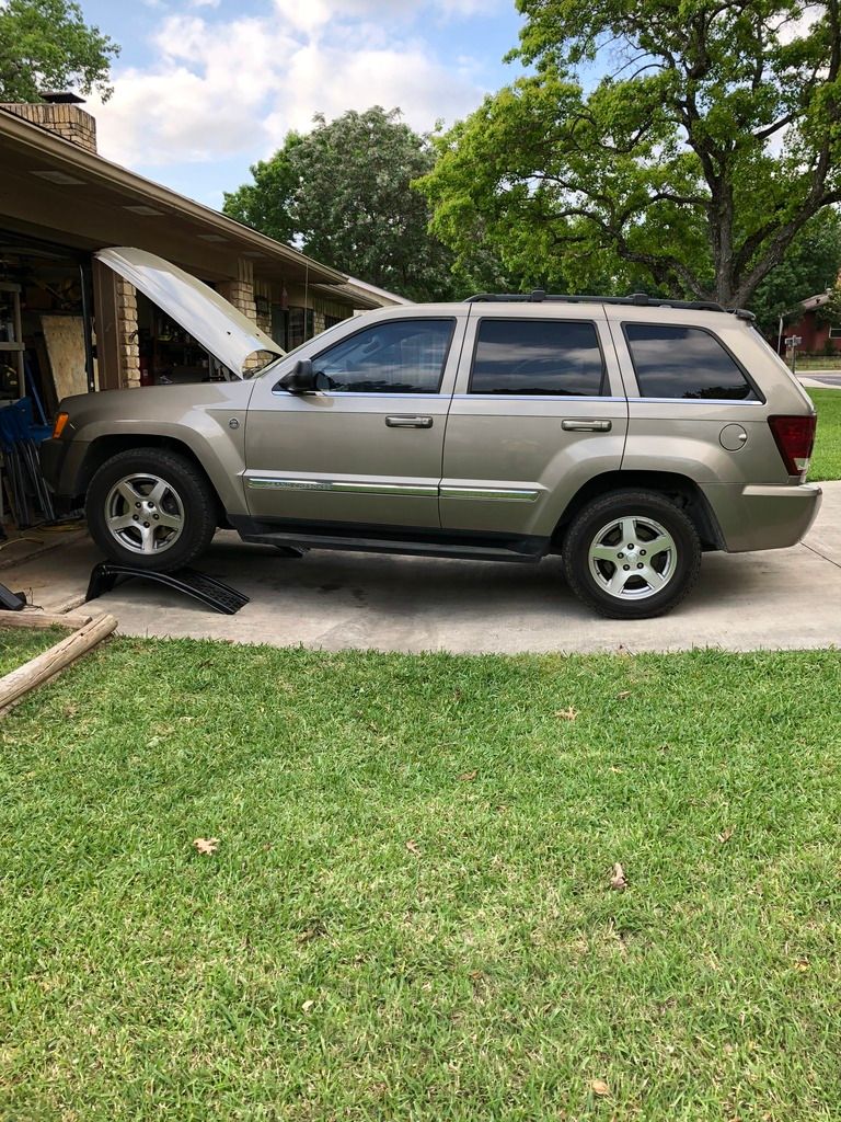

I'll include only a few pics of my transmission work with the switch solenoid.
Mainly because I read that many people have said that the front drive shaft has to be pulled in order to reach the wire harness plug.
Maybe it's because of my driveway setup, but I was able to reach up and pull the harness plug out very easily. No issues with the drive shaft being in the way.
My drive has a slope to it. So when the front of the Jeep is on ramps, it basically sits level. This does provide quite a bit of room underneath...

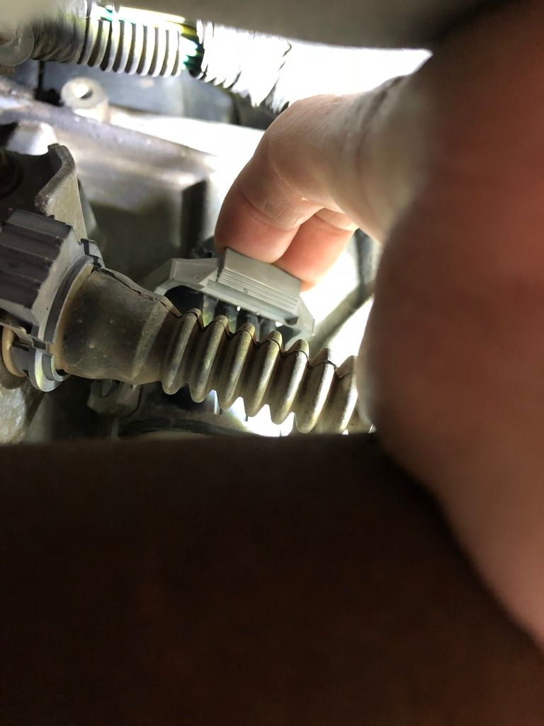

This shows the location of the plug behind the front shaft...
Enough room for 2 fingers to lower the plug latch, then I was able to reach up, grab the plug, and wiggle it up & out.
And the valve body after it was removed...
