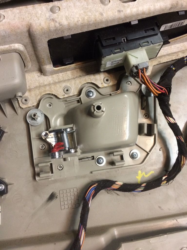

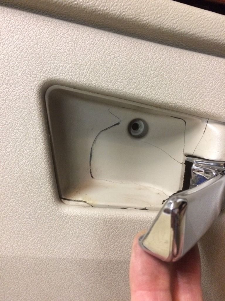

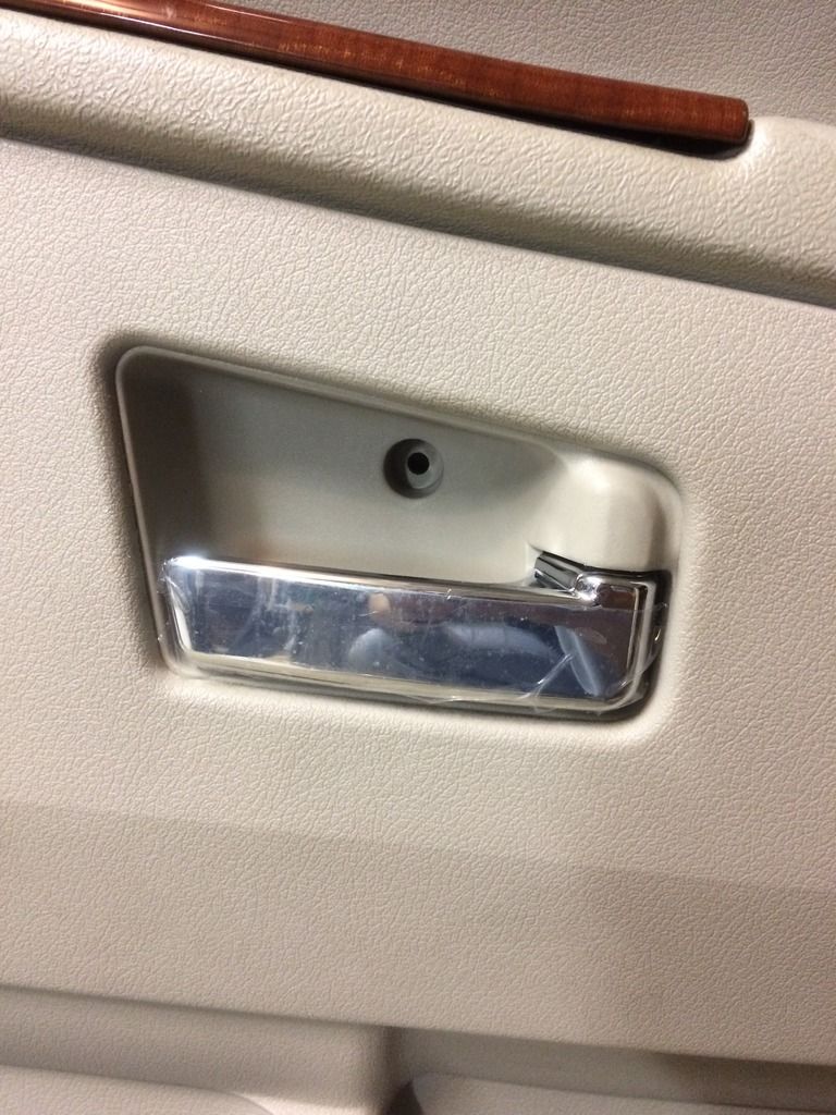

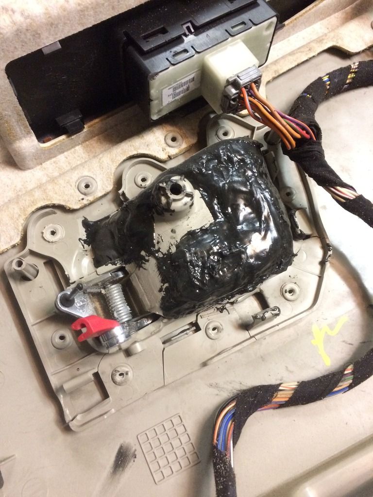

Door handles from http://www.thrasherhandles.com went on last night. All four doors took about an hour to complete. Very easy. Also found out that the front passenger handle had previously been "glued" back together by a PO...
Before:
After:

Looks nice! And it's a good color match to the existing trim!

That looks great. (Minus the massive amount of spooge the po put on it.) I'm gonna have to order a set. Every handle on mine is broken. Three of them still work, but they are missing some plastic so I'm sure it won't be long before they are inoperable like the one in the back.
