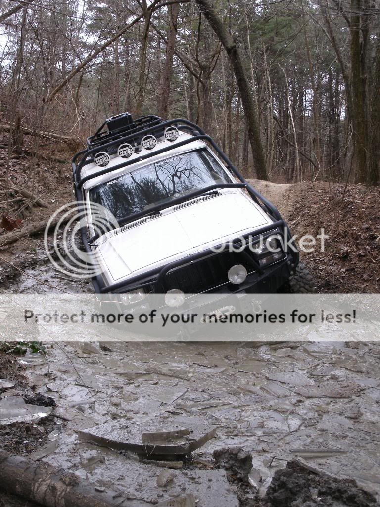

Me too.
***Chris***
chris87xj is offline

Nice look Chris.
