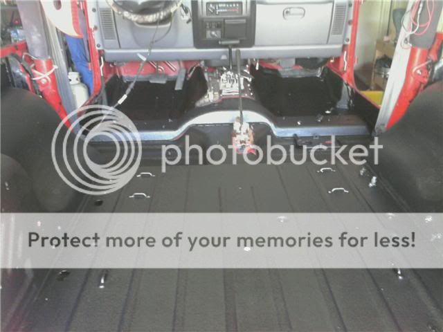

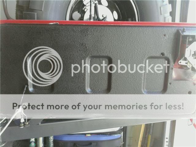

sprayed with universal non sanding primer (light grey)
sprayed black
wanted to show the black and pink together
rolled barbaric
The primer was sprayed with a gravity fed spray gun. It took about a 1/2 gallon. The black monstaliner was sprayed using the walcom shutz gun. I used about 1 1/2 gallons. It was thinned with acetone. I didnt measure the acetone so i dont know the exact amount that was used. The interior took about 3/4 gallon maybe a little bit more.
