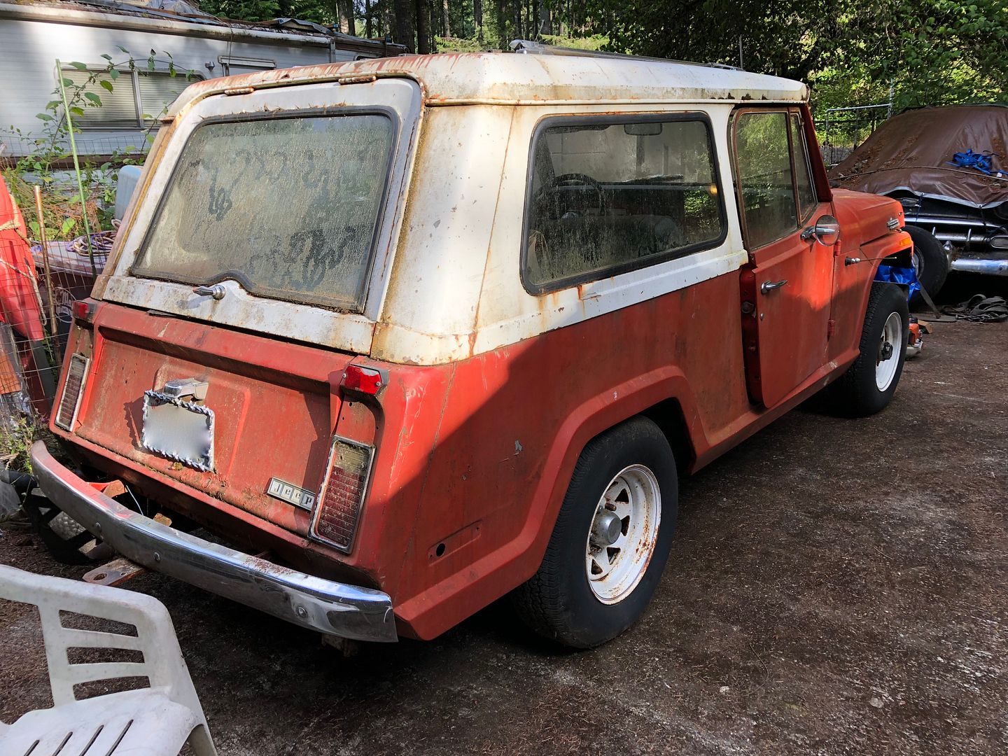

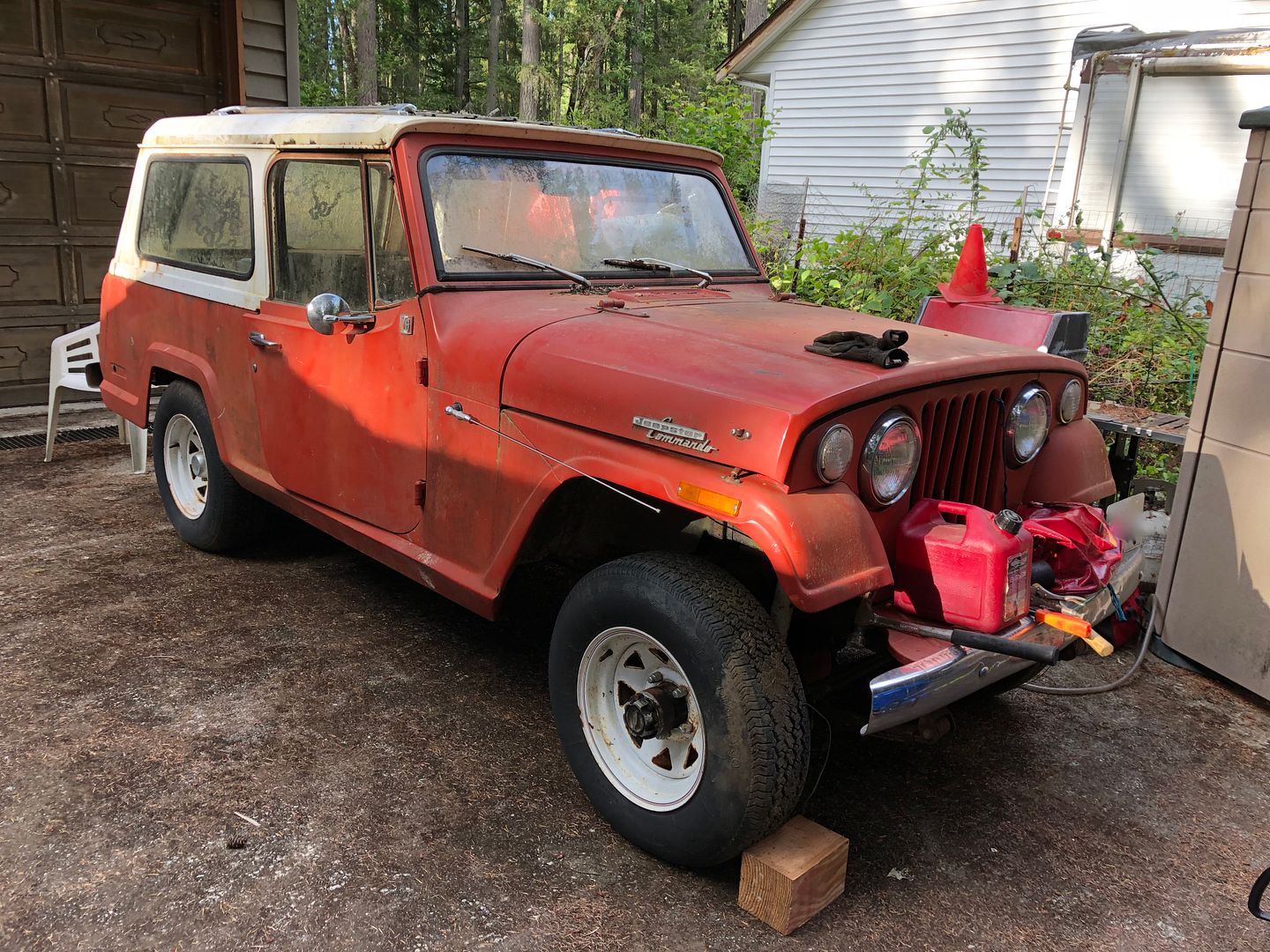

New to me Jeepster Commando
Going to go pick this up next Thursday! It belonged to my hubby's friend who passed away a couple years ago. His wife gave it to me. (Hubby has been helping her clean her 3 property's for since her hubby passed) We have to make a trip to Washington to pick it up (we are in CA). The trip is going to be basically paid for by her, so not to bad of a deal. We are also brining another one of her cars back to CA. That is why she is paying for the trip. The Jeepster was a bonus for me. LOL
Not sure what all is wrong with it, but I know it has been sitting for several years. Can't wait to get it and get it home to start reviving it.
I will post more pics when I get to WA next week.

Do a close inspection of the tailgate and rear fender areas for rust. That is the biggest issue with these rigs.

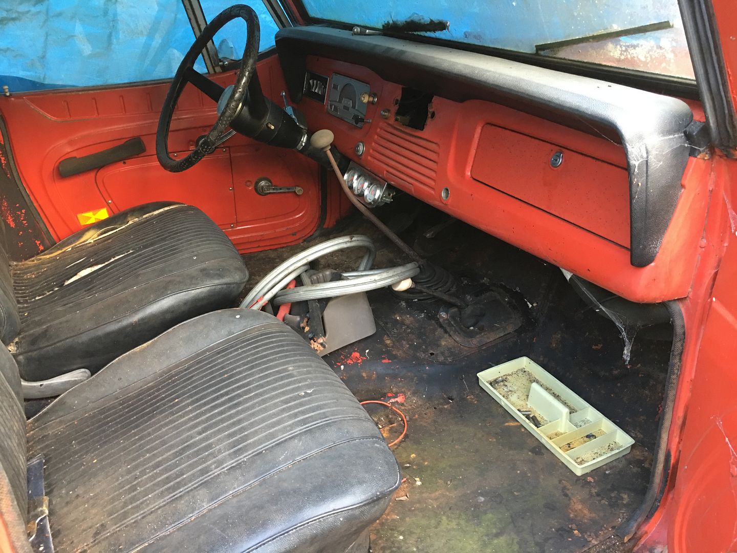

If memory serves, some of the dash components are interchangeable with the Waggy/J series of that era.

Most of these have the Buick V6. If so, earlier models will have the T86 (unsyncro'd 1st) transmission. Later ones will have the T14 (syncro'd 1st). The T86 is balky but relatively strong, and can be rebuilt using T90 guts. Show care if it is the T14, as these are marginal behind the Dauntless and replacement parts are just about nonexistent.
Wagoneers of the same era came with the TH400 auto behind the Buick 350 offered, and if you can find one, it shouldn't be a hard swap.
The beauty is the extended wheelbase will allow you to install just about any transmission in there you want.
Take a good look at the rear end. Many Commando's (for some reason) came with a D30 in the back. These are serviceable, but marginal under heaver wheeling.
The steering will be a Ross style system and while beefier than the CJ's of the same year, will still be prone to slop. They can be rebuilt or upgraded to a Saginaw (power or manual) system.
I see somebody has "added" a turn signal regulator. The stock one should be a GM truck unit of the same year.

Looks late 60s or so. I had a '72 model this same color but with the "ugly front clip" instead of the Jeep style grill. I would think it would still have the v6 badges if it has the Dauntless odd fire v6 in it. but they may have been removed. You can take a pic of the motor and post it and we will be able to narrow that down. Commandos are rare and not seen very often now days so it is a good restoration project to do....unfortunately you have Cali emissions to deal with....yuck

Someone told me it was a 71 or older because of the reflectors on the fender. That is all I know.

'71 or older due to the flat "Jeep" seven slot grill. '72 and up have a different "Bronco" or "Blazer" style front grill. Original late 40s Jeepsters (which are 2wd only) were a pointed grill like the Willys Wagons. Then they went with the flat grill then the rounded full grill look for the last generation.

I think it's a '70- '71 because of the rear reflector on the side of the tub. (But that's a guess)

Guage cluster and controls are the same as the J-trucks for the same years.

This is the '72-73 version of the Commando. It's quite different than '71 and older.

Yah, those are called Bull Nose. I thought it was 73 that started the bull nose, but if it is 72, then mine is definitely not one of those years. LOL If 70 models didn't have the reflectors, then mine has got to be a 71.
