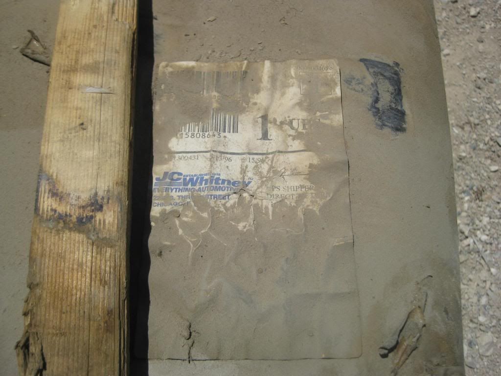

Over the winter I collected a mass of parts I knew I need, fuel tank, filter, lines, sending unit, filler & vent hoses, radiator hoses & heater hoses, t/stat & housing, coolant sending unit, all filters and fluids. I also ordered some more parts while there on vacation, but they didn't arrive in time, smog pump & belt, air injection tubes & check valves. Will have to do all that later.
When we unloaded the truck off the tow rig, there was a pretty good fuel leak from around the tank area, so I just figured I'd replace everything. The tank had been replaced before due to someone drilling a hole in it and stealing the gas.
Fun laying in the dirt by yourself in the wind and rain under a half full tank of gas (couldn't siphon it all, ran out of containers). I used some wood blocks to hold the tank while I disconnected the hoses/wires.
Why were those pieces of wood up there? I will find out later.
JC Whitney circa 1996 wow!
Spaceball is offline
