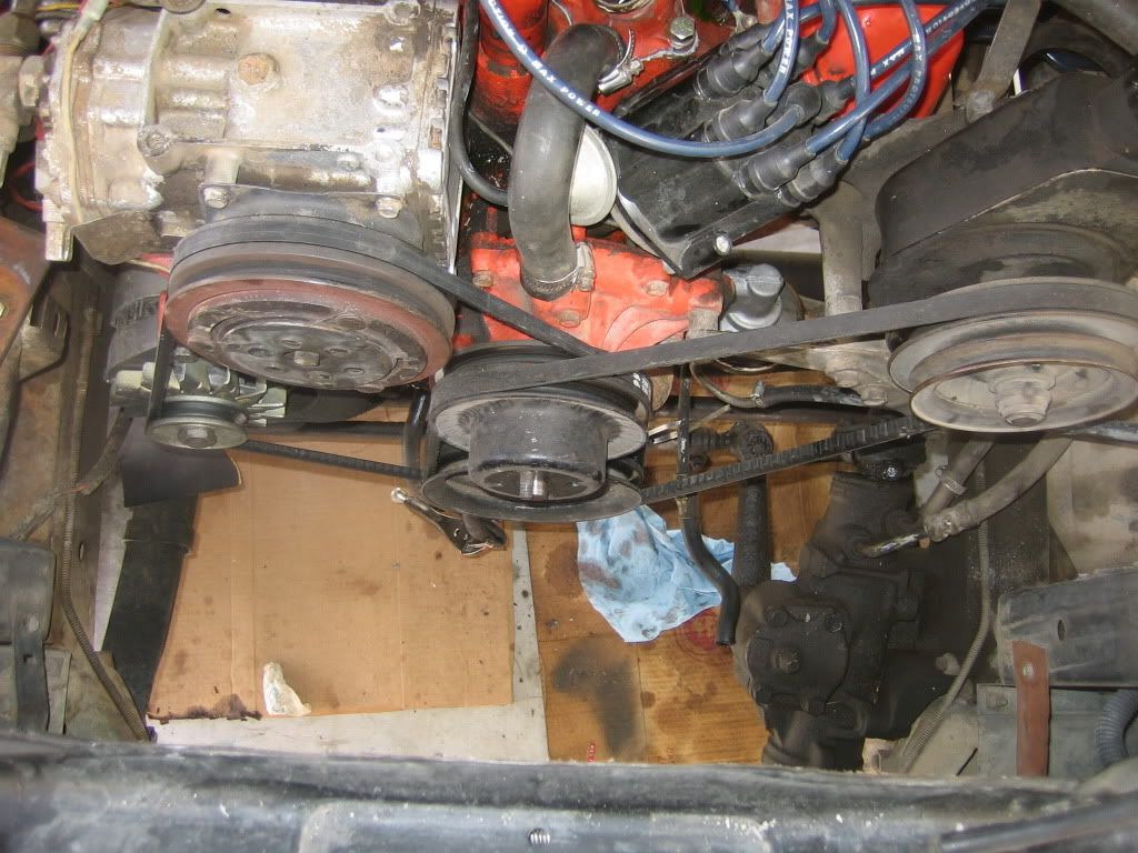

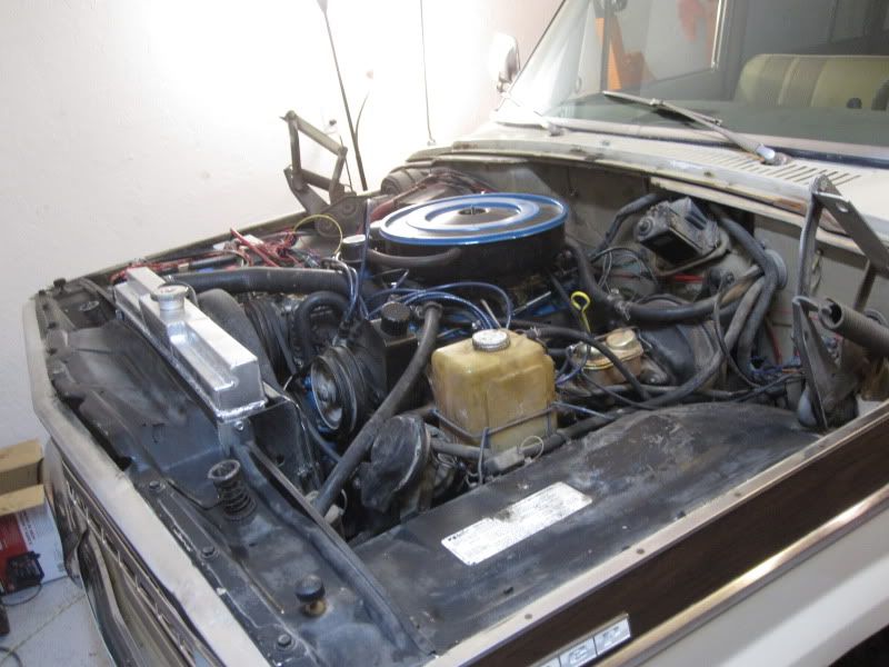

Here are some pics of my engine compartment:
(radiator out)
Accessories coming off:
new engine going in
Sorry, just tried to give you as many complete angles and shots as possible, haha. That's how the compartment on my 73 is set up, the only thing that changed with the engine swap was the ignition system for the new motor is electronic (from an 87) and not a points system as was original in 73.

Yeah, It goes (from rear to front) Radiator, AC condensor, Transmission cooler (it's a b&m plate style).
I replaced the engine because I was getting alot of noise from the old one, knocking, tapping, sounded like both top and bottom noise, so I just pulled it. The original motor (orange one) will get rebuilt and put back in eventually. This motor is more of a temporary setup.
Perhaps the pump you have is a smog pump, for air injection. You can see the big bolts on the outside of my exhaust manifolds. Even in 1973 they has emissions crap on these trucks, and the manifolds are setup for air injection. The smog pump pushed fresh air into the exhaust, in order to get the cat to burn hotter.
That is most likely what you're seeing under the PS pump, I believe it was on the driver side of the engine. I dont have one, it (as well as all other emissions crap) has long since been removed, which is now causing issues for me passing emissions.
