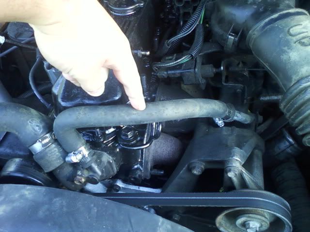

No the one Im talking about is on the left side of the engine (left side of the vehicle). My heater hoses of course go to the right side of the vehicle where the heater core is. The hose Im talking about is rubber that goes to the intake manifold, there it connects to a hard line.

I'm confused... can you take a pic of it?

Also I discovered the shop did not plug the coolant temp sensor back in, though I wouldnt think it would have anything to do with the actual cooling system, more how it runs than anything. I ran it some today with the rad cap off trying to bleed any air. It ran for 5 or 10 minutes, all the while spilling coolant out the radiator, it never did go down like the thermostat opening. Also, after I shut it down, i felt all the hoses. The heater hoses, whatever the hose is im pointing to in the above picture, and the lower radiator hose were warm, but the upper radiator hose was cool, as was the radiator. Would this be a thermostat problem, blocked radiator problem, or is there still air in the system?

wow, I guess I never paid attention to the 4cyl engines. But after looking at pics of other 4cyl on the net that's how they look. I guess that's how the 4 cyl's cycle the water until the thermostat opens up. Someone smarter than me will have to tell you where exactly that goes and why.
