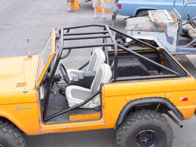

*Official* Cage idea/pic/discussion thread
Ok, it seems to be a well debated topic of how to build a cage for your jeep. So post up your ideas, questions, pics, whatever and lets see if we can create a central location for all this knowledge.

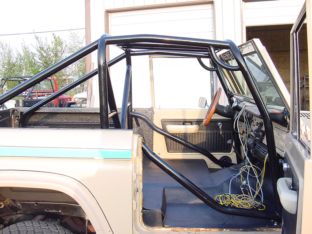

another cage.... with the X brace on the B pillars

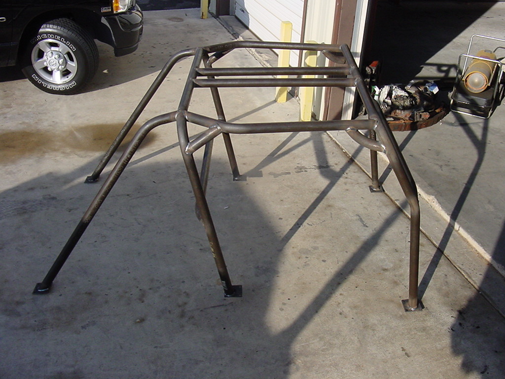

This is what I plan on fabin for my jeep.......

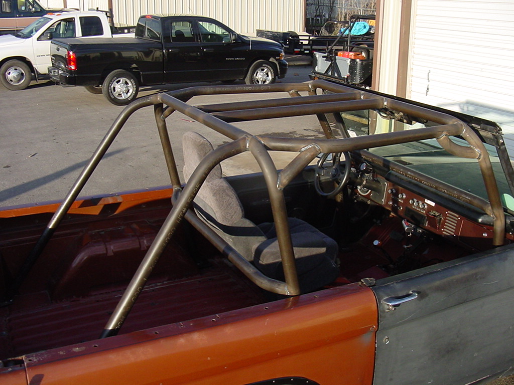

AtoZ Fabrication................................

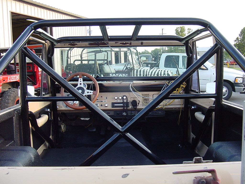

A to Z fab again
