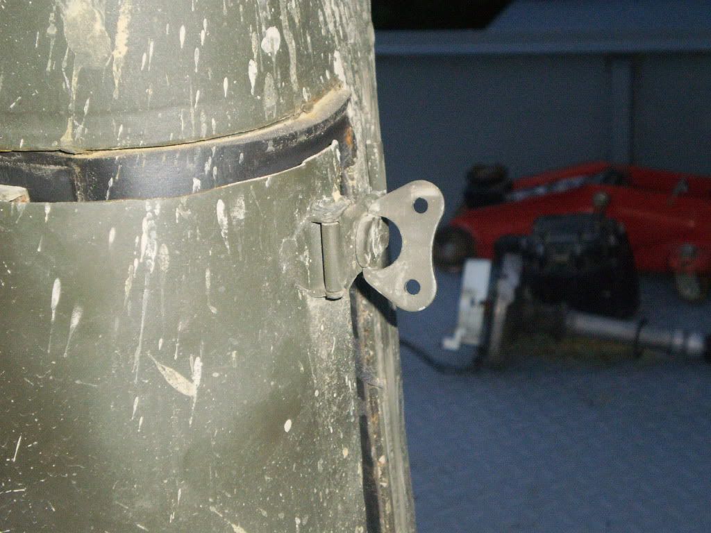

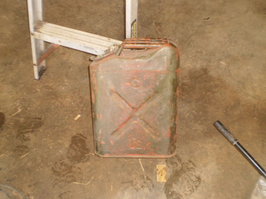

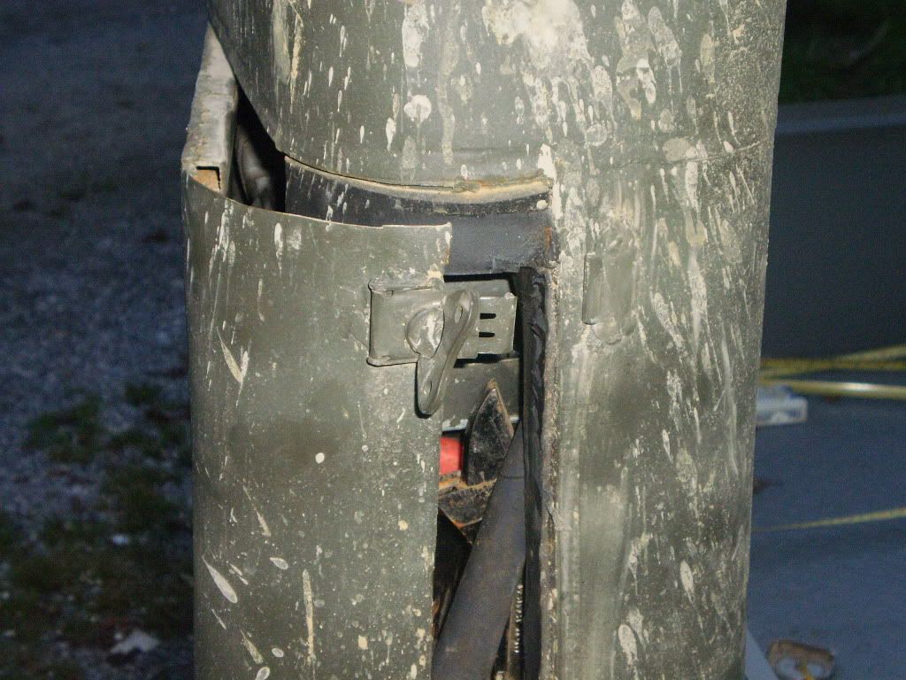

OK here goes. this is my 1st write up so bear with me!! i will try to be as detailed as i can.i'll start with how then pics. i had an old jerrycan given to me, i tried to clean it to use,but there was to much rust in side. after many cleanings(to get old gas out) i filled half with water(safety). then with 4 in grinder with cut off wheel i found 2 straight edges(front& side seam)then cut the can open. after opening i put 2 shelfs in, thay had to stop 2in from side so door would close.(this worked great as it leaves room for longer tools).the shelfs have a 1in. lip,to help keep tools in place.as for the door hinge its a simple piano hinge. i welded small angle around door & door opening so i could put a seal around door(i used camper shell foam tape).as for the 2 latches i'm not sure what thay are called my dad had them in the garage.
then prime & paint! i hope this helps everyone wanting to do this
if you need more info just ask,i will try and help!! thanks guys! ok ok heres the pics, ENJOY!!!!

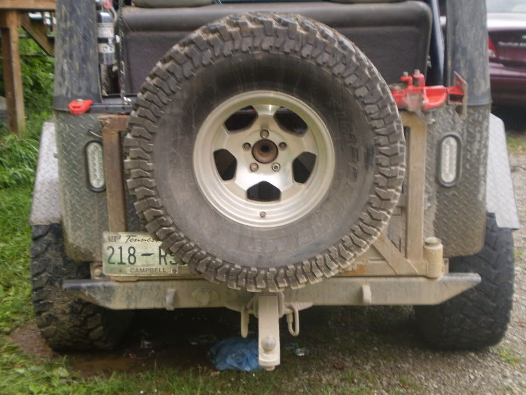

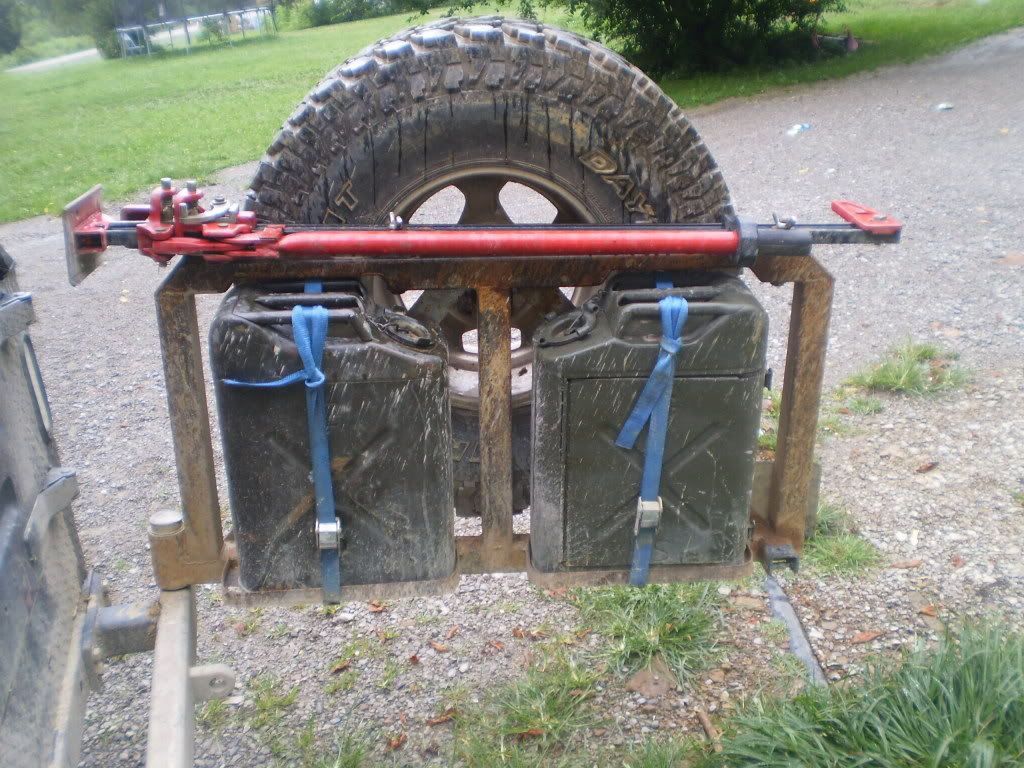

this has worked great for me,it holds most tools needed for a trail fix.
thanks for the interest in this simple mod.good luck

Very nice. How is the weather hold from it. Knowing you just did it...Maybe drill a few really small holes in the bottom so water doesn't collect and will be able to drain out. If the seal holds off well...I'm wrong. Good write up. Simple.

its been on the back of my jeep sence july 6? 3 trips mudding,rain almost everyday,some days very heavy!! no water yet! but do plan on maybe a hole or 2,just think that might give mud a way in?so far getting damp inside a little

give a picture with your gate closed

sorry it took so long for your pic. cant see to much,but both cans are there!!
