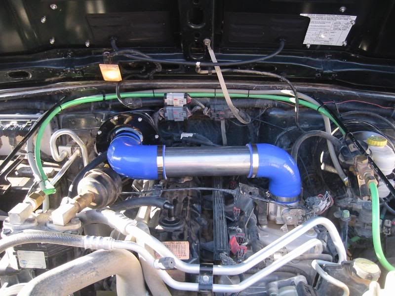

Is this the thread you are referring to?
Thats the one I would follow if I didn't like folding my windshield down so much.

I think that is what he is looking for. But I don't understand why he runs the tube all the way to the Hummer inlet deal. Sealing the cowl is real easy. Mine is sealed. The only problematic area is where the windshield wipers come out. Cover the cowl opening that is open now and let the engine and AC air come in the new inlet. It would be simple to do that.

yep thats it thanks, but im goign to dumb it down alittle bit.
And i really never have the windshild down, so im not worred about clearence. But it will sit semi low.
