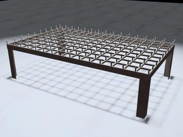

While that spike table (looks like some sort of torture table) works, it's alot easier to make a table that uses replaceable "slats" of flat bar. My table uses rows of 3/16"x3 flat bar laying on edge 3" apart. I can get a month or two out of the slats before I flip them over and use the other side.

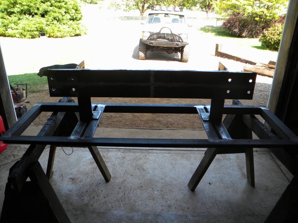

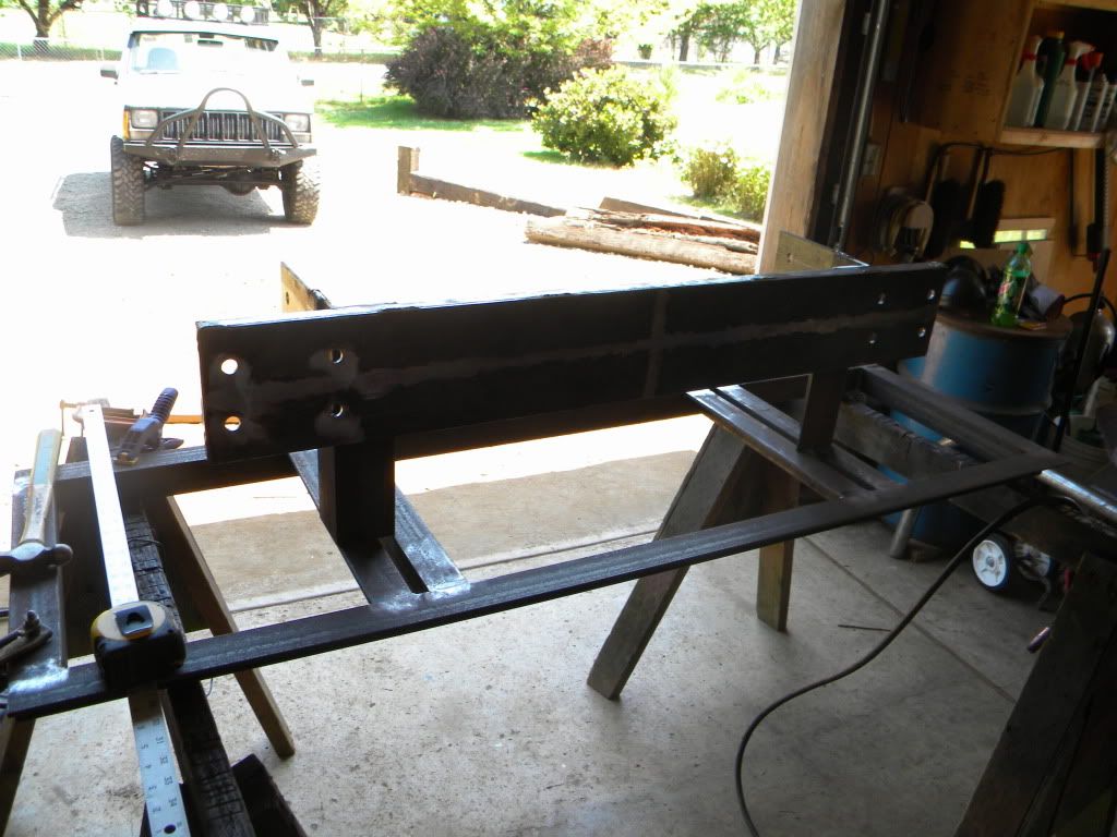

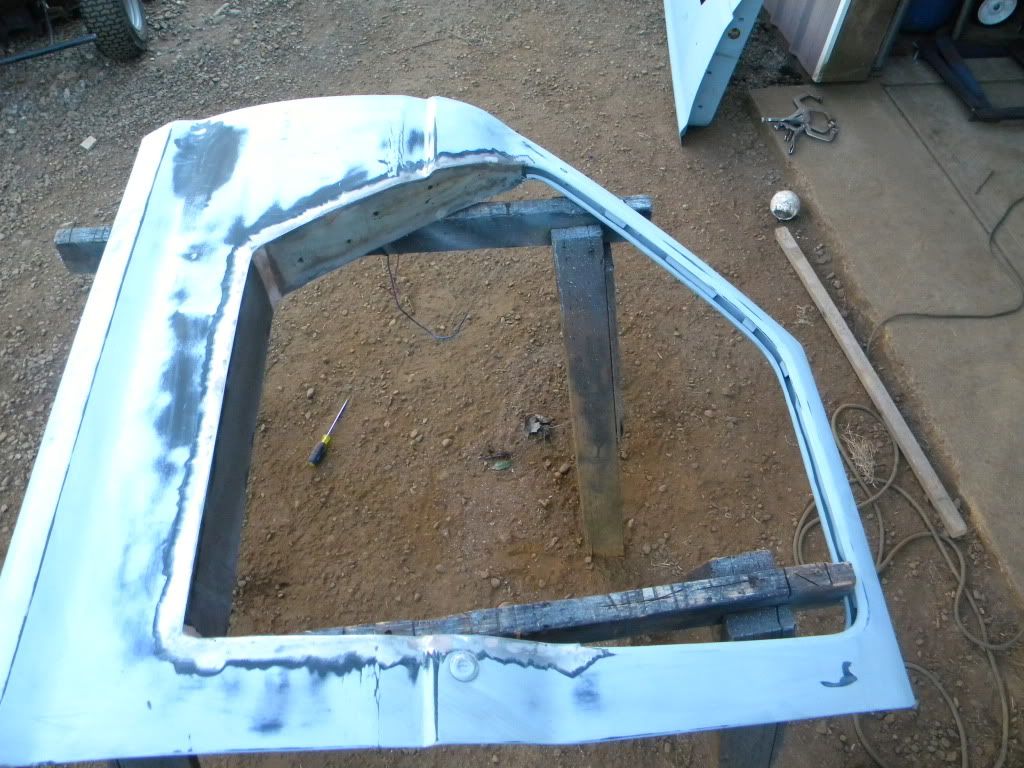

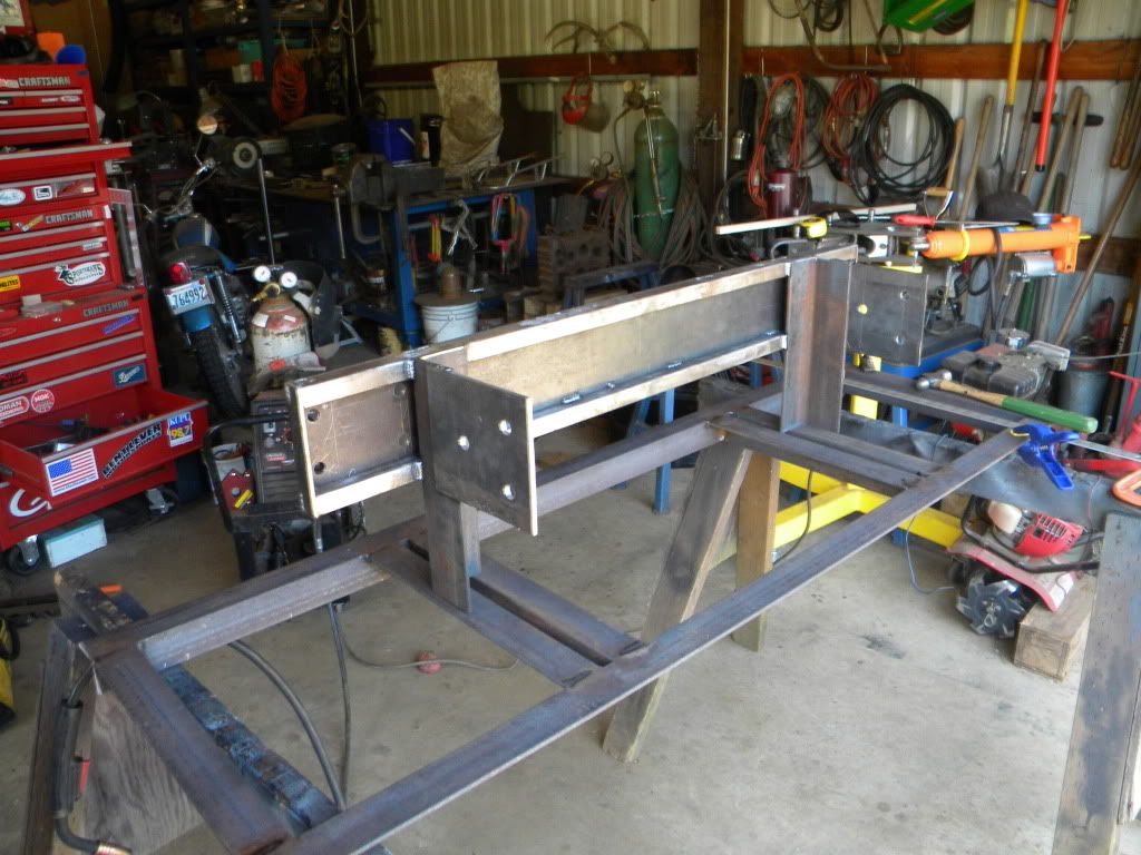

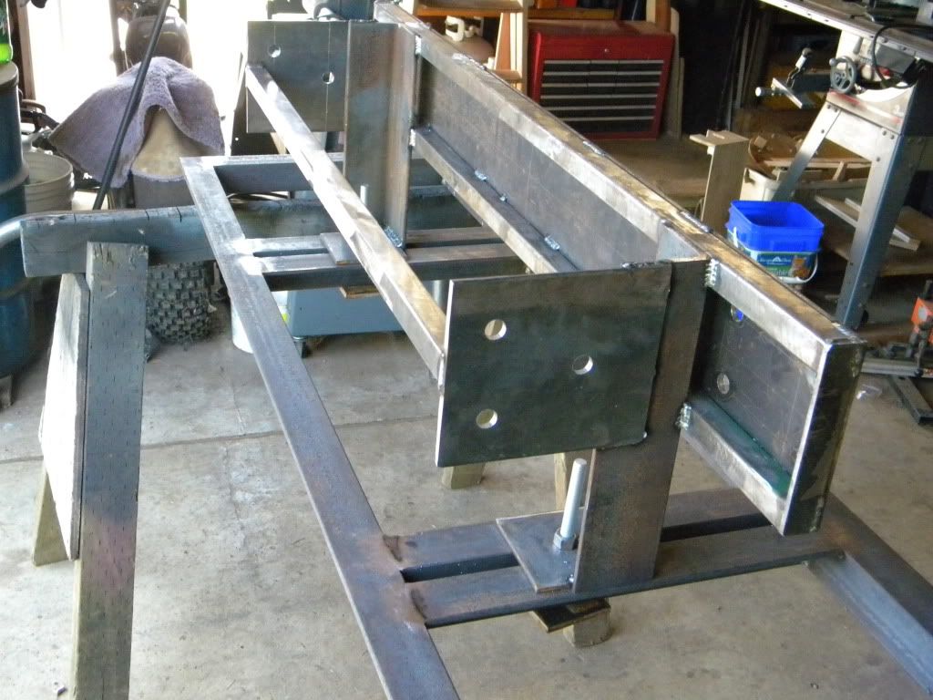

here some pictures of what i have done the last day or so ignore the crappy paint it was used in place of primer, the doors will be colored the same color as the guys B2 here in a few days is what he said.
