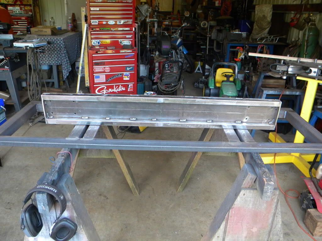

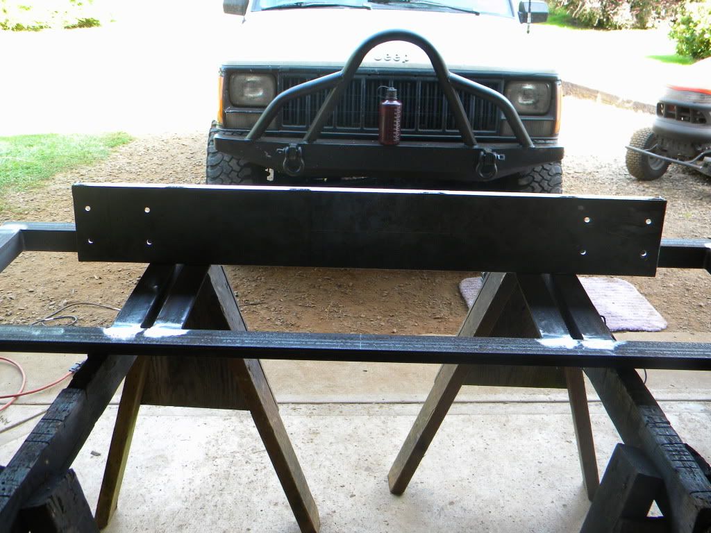

got the rest of the jig built for the rear bumper, will have pics up tomorow and hopefully the rest of the front jig built,
Bersk that would be great if i had the room in my shop for a hole front and rear end of a jeep, unfortunately i dont so the jig is how it will be for now and it havnt decided if it will be on casters or not, or even if i will build a stand for it, may just use it on saw horses so i can set it in the corner when its not in use, plus i think having it on casters would make it a little harder to work on if it has the ability to roll, however my bender is on casters and i havnt had a problem maybe i am over thinking it!

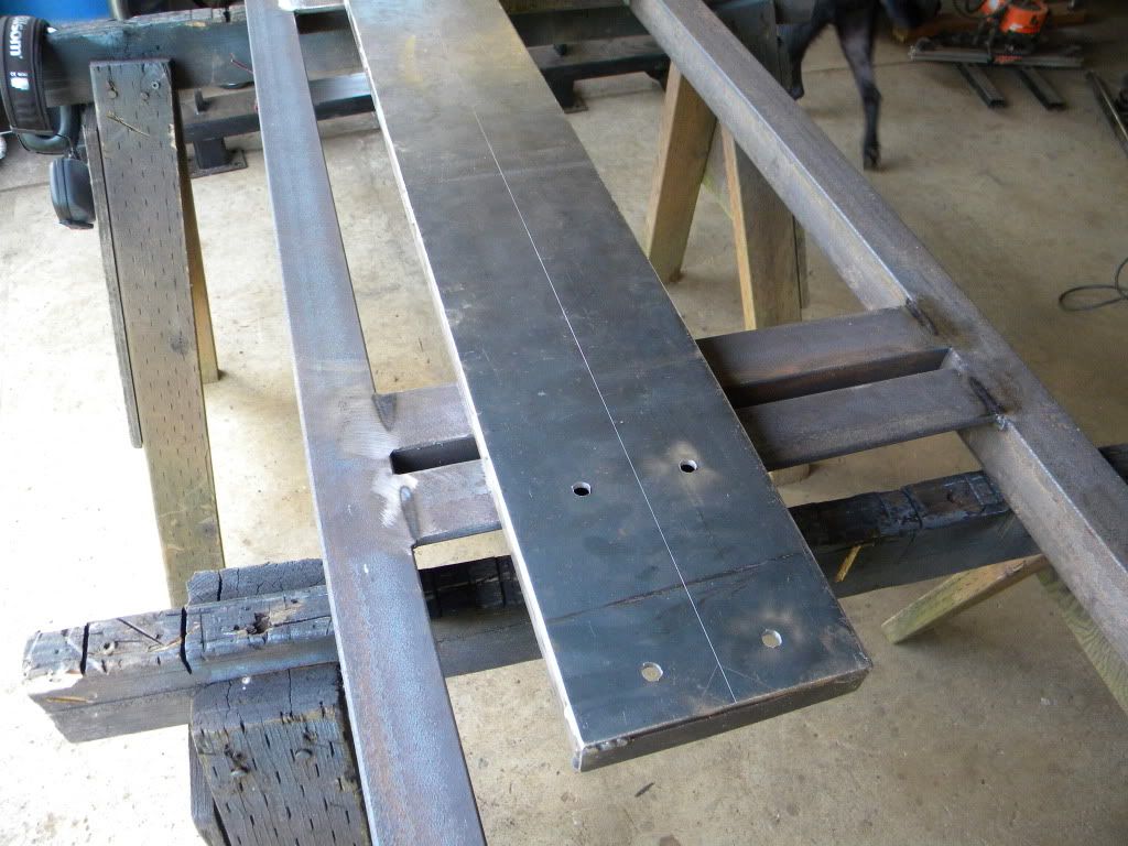

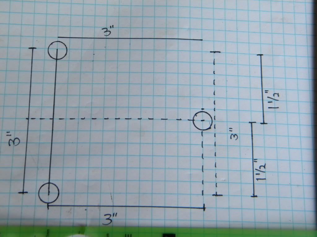

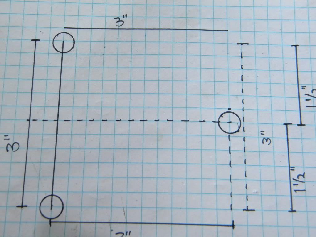

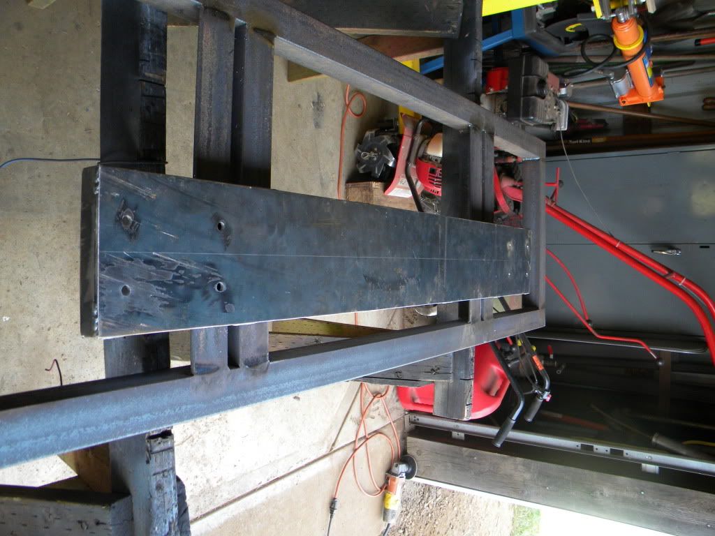

got some more done on the jig today, laid out the holes for the rear bumper mounts as so, making sure it was ever so perfect, haha i actually had a guy argue with me in my math class, that using soap stone was more accurate than using a scribe. what a dope the front is 3/16" and the back is boxed with 1"x1"x .065 to make sure it is flat then capped at the ends with a 1" strip of 3/16" the entire length of the piece is 44"
I layed out the front bumper mounts as best as i could, but were my front bumper mounts has seen better days as far as being towed and tugged from and the numerous times of removing and installing bumpers on it, will cross check my measurements on another xj by buddy has that hasnt had such abuse
on the back side i will us 3"x3"x 1/4" angle to bolt to the bottom of the jig, there will be plates on the bottoms of the angle that coincide with rails in the jig, and those will be spaced apart just as far as a stock jeep so that on the other side i will be able to have a jig for front bumpers as well. will post some more pictures tomorrow.
still open to any other advice on this situation!

One thing that I would highly recommend is to leave some room for error in your final product such as slots instead of holes. That will give the end user some room for adjustment if their rig is out of whack.
I made a front bumper for my 93 YJ and used my 89 as a jig only to find out that the front frame horns were not exactly identical and had to enlarge the bolt holes (with a die grinder) for my bumper/winch plate to bolt up.
Knowing this now, when I build any more bumpers I mill a slot out for the mounting holes instead of just drilling them. It allows for quite a bit of side to side adjustment and does not effect the integrity of the mounts.
Just something to keep in mind.

Exactly. That is on a frame vehicle too. No two Jeeps are the same, and putting a perfectly fitting part on one may not end up fitting at all on another. Being a unibody XJ, it will have moved some. You will definitely want room.

the holes on the jig are for 3/8" bolts so thats what i will build bumper with originally then when its all done i will drill them to 5/8" thats what i have been doing just using craigslist, and it has seemed to be ok except for one guy but he neglected to tell me the front end of his jeep and hit a power poll, anyway he was pissed and i didnt care because well. what can a guy do at that point. so thats what i will do i will build the hole thing using 3/8" and then at the very end of the build i will drill the to 5/8" which is about a 1/4" smaller than the washers on the stock bolts so it gives people a little bit of play to be able to adjust just how they want but still leaving enough material to be able to work with the stock bolts and not have to do something special.

If you're going to oversize the bolt holes, I would suggest building your jig to accomdate the large bolt hole size and just use larger bolts during building. That will allow you to just drill your brackets to the 5/8" size once.. especially if you're doing it on a drill press. Otherwise, I'm assuming you're going to use a hand drill to oversize the 3/8" holes later on?
On my rear bumper jigs, I welded "studs" sticking up thru the jig to drop my mounts on. I just drop the mounting plates in place, center the slotted holes, drop the bumper on the mounts (against stops) and tack the mounts in place. Once I double check everything, I pull the bumper, toss it on the welding table and burn the mounts in.
Another tool that really helped me cut my bumper building time nearly in half was a rotating welding rack. It fits my bumpers both laying on their face and standing up. Basically, I welded a solid spindle to one corner of my welding table. I bored a piece of thickwall tube to slip over the spindle. I then welded a rack to it that the bumper sits in. I slather some grease on the spindle from time to time and forget about it. I can weld one end of the bumper, spin the rack, and then weld the other end... without having to change my position. Weld in a clevis mount, move over and weld the other clevis mount, flip the bumper over and do the other side. The rack holds the bumper at about chest height while I'm sitting on a swivel stool. I kid you not, next to CNC, this is the tool that has knocked the most time off my bumper building.
