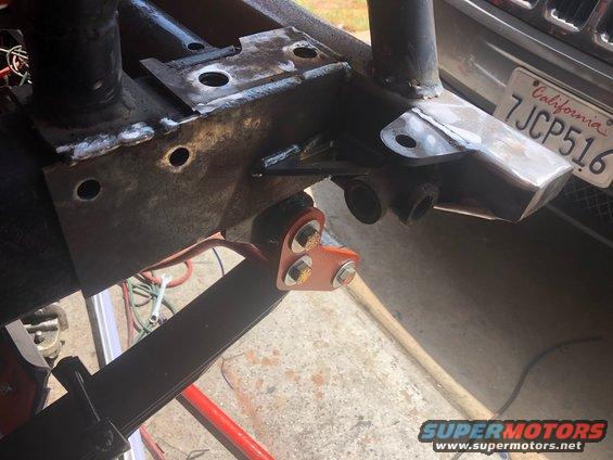

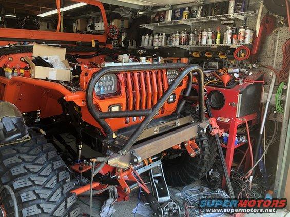

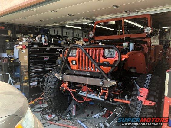

I knocked up this guy for my YJ today.
2x4x3/16 steel. Plumbed and sealed for air, mounts with 8 1/2” grade 8 bolts
