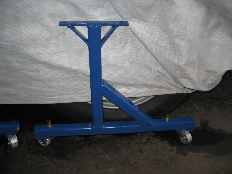

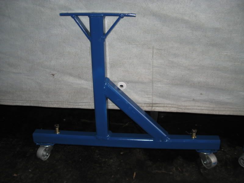

Ok I ended up buying some 1.5" 3/16" wall square tubing and some metal casters. Welded it up and painted it Ford Blue. I will use this when mounting the flywheel, clutch and PP. I will also mount the bellhousing trans and case, but I will use a jackstand to support the back.

I like it, the Ford Blue sets it off Rob.
