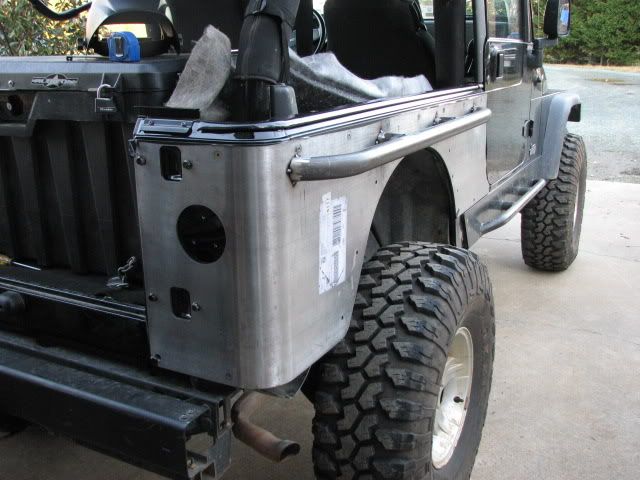

Well I finally got my Jeep fixed from a trail accident. I ordered Rokmen's corner armor despite their refusing to give me the vertical height dimension of their armor above my rocker guards. Turned out ok anyways.
I liked their "strykers" but wanted to save the money as well as use my welder. So I ordered their normal full length LJ armor and then bought some tube bent from Eddie.

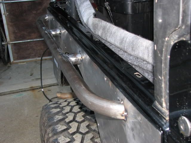

Here is the passenger side how it came.

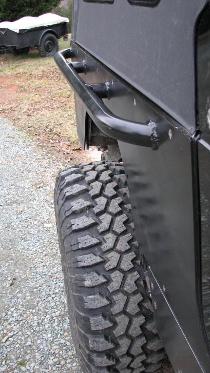

Did a LOT of grinding and fitting. Then finally got them tacked in place.

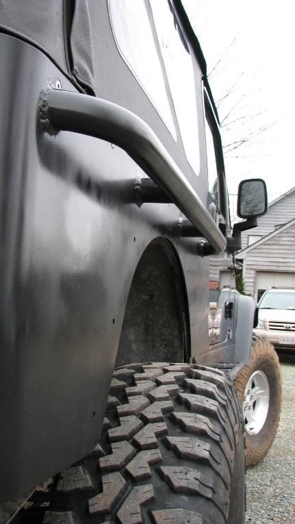

Took them to a friends shop and shot some gloss black on them. Ended up getting over spray on the from touching up the edges but I can hopefully polish it out some. If not Ill just get it dirty.

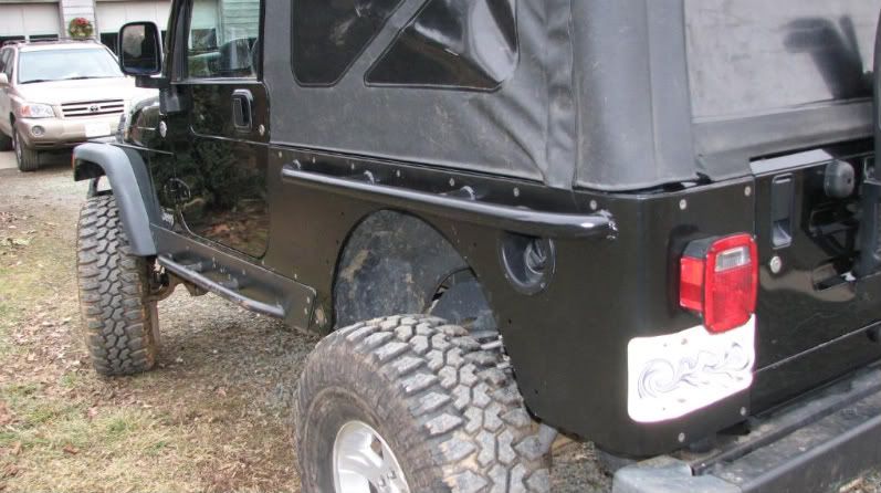

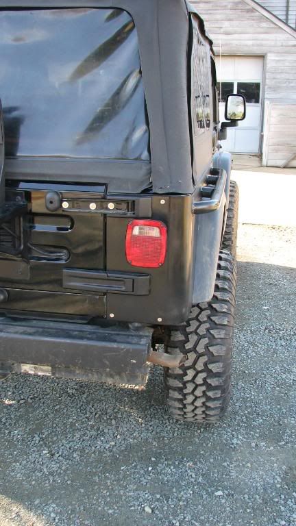

Bolted them up on Christmas day. Loved the 50 degree weather. Then got the lights and license plate mounted.
For the final mounting I put silicon around the heads of the counter sunk bolts. My rockguards have rust around the bolt heads and I hope this prevents it. I suggested this to a friend when he installed his guards and it seams to have done the trick. I also put a bead along the top, front, and rear edges.

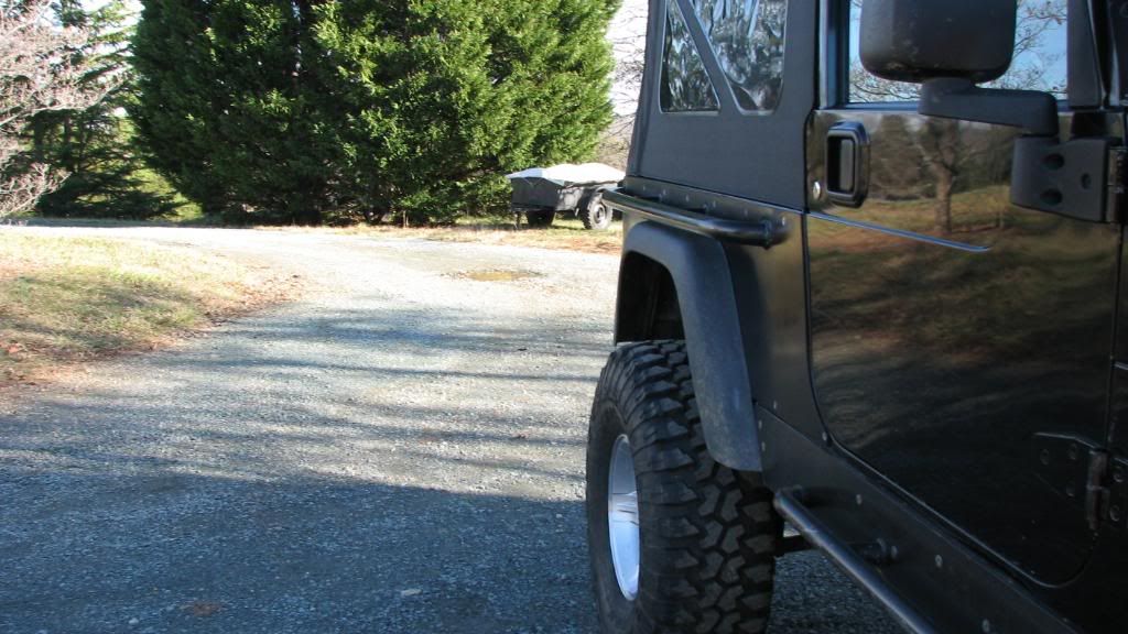

I plan to put my flares back on eventually but now its raining and cold again.
Thought I had pictures of my welds but I can't find them. Some turned out really well. Although I got some splatter from welding outside in the wind. Wish Santa had brought me a heated shop.
I see why the "Strykers" cost so much more. Its a lot of work fitting the tube so you don't warp the guards. Plus their TIG welds would look much better than my MIG.
The fit was pretty good. Although some holes were on the edge of the acceptable limits but that could have been from damage on both corners of the Jeep. Got the correct amount of hardware as well as some extras

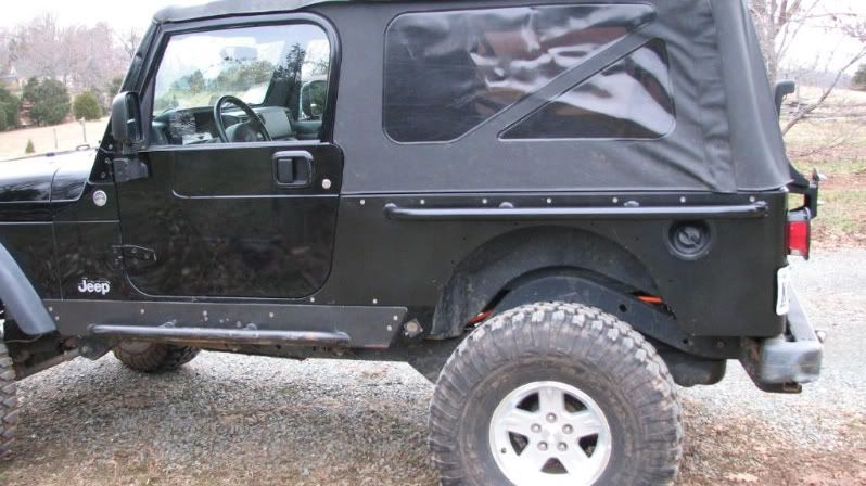

Nice! I like that! Are the stock flares still gonna fit?
Yes they still fit. Its close though. I had both flares on when I tacked them in place. Now I have to decide if I want to paint them before I put them back on.
Thanks for the tube.
Eventually I want to extend the rocker guards or trim the body where the gap is. As well as weld on a CB antenna mount.
Ill get some pics of it with flares on when I have time to put them on.

What did you weld the tubes on there with?
....it looks liked you lacked a lil' shielding gas? Looks good though! I like em'
Yeah I was welding outside and when ever the wind picked up I lost the shield. The welds on the end are my worst one. They also looked a lot better before paint and in person vs a photo.

What's up with the gap ?

That is due to an accident that these are covering up. I saved a lot of money by having the shop not repair the side and only replace the corner. That helped me cover the armor and tube.

As promised a few with the flares.
And the flares doing their job. Sorta.

Well I forgot to take into account the gas nozzle at the gas stations... Fortunately I have enough room for the normal stations nozzle to fit. But the stations who feel the need to put the stupid plastic advertisements on the nozzle don't. So I have to "take off" their stupid plastic pieces to get it to fit. That was a scare on the first fill up
Anyone with actual Rokmen or other brand "strykers" have this problem? I'm wondering if I should have mounted mine a tad bit higher. Although I still don't think they would have fit.
I have the Toys by Troy version (see below).
I've noticed the curve of some of the gas nozzles makes filling up at certain stations impossible. The tube is such that I can't get the filler nozzle in. So it isn't just you.
