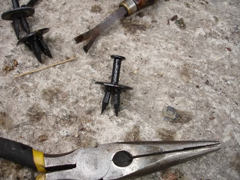

14) Assorted plastic rivets to reattach various plastic parts

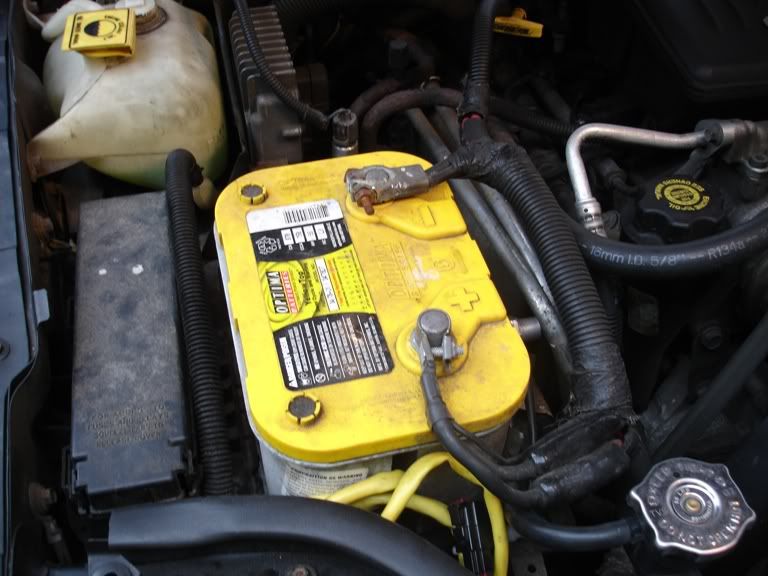

1) Disconnect the negative battery terminal (deep 12mm socket)

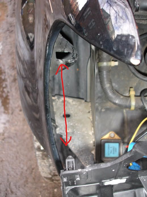

2) Remove the 3 plastic rivets from each fender well that attach the fascia to the splash shield
3) Remove the 10mm (use a deep socket) screw from each fender well that attaches the fascia to the fender

5) Remove the 3 plastic rivets at the lower fascia, which attach the fascia to the metal bumper bracket
a. My metal bracket was pretty well corroded from the radiator leak and no longer connected to the fascia so I replaced it
6) Remove the 4 large plastic rivets that attach the lower splash shield to the unibody (2 on each side) or remove the radiator skid plate bolts and skid plate if equipped

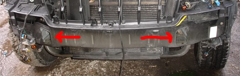

9) OPTIONAL: Remove bumper bracket, which attaches to the lower fascia and to the radiator support lower cross member (3x10mm bolts)
a. This makes it much easier to access the lower portion of the radiator and drain petcock

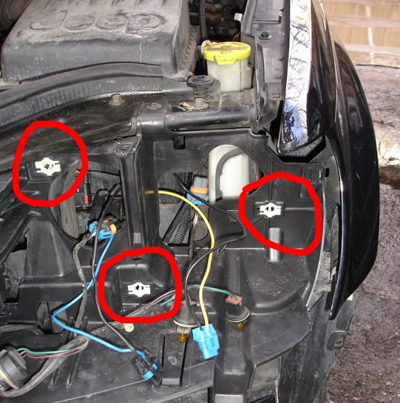

12) Remove the long headlamp retaining screw from each side (7mm)
13) Remove headlamps by pulling firmly forward to dislodge the 3 ballstuds from the tabs on the header panel
a. The fist time I did this, I broke the yellow plastic ball stud mounting tabs (either because it was cold out or they were old and brittle) and had to buy a new header panel because they donít sell the tabs individually

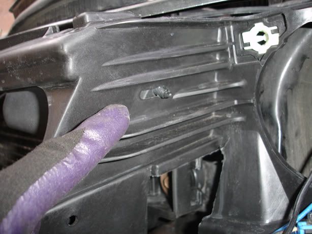

17) Remove the single rivet holding the air box inlet to the header panel (driver side)

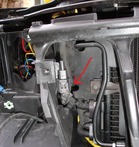

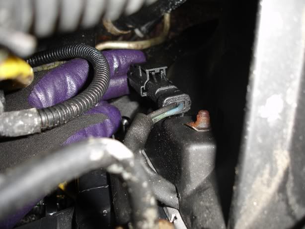

18) Disconnect the temperature sensor
19) Pull the header panel slightly forward and carefully disconnect the headlamp wiring connectors by sliding out the red retaining tabs and pulling apart the wiring harness

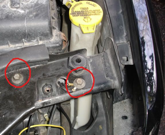

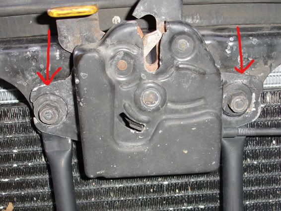

22) Remove the upper cross member bolts (2x10mm per side; 4 total)
23) Remove 2x13mm hood latch bolts
a. Mark outside of bolt heads for reinstallation to line up hood latch correctly
24) Remove the upper cross member from the vehicle and set aside

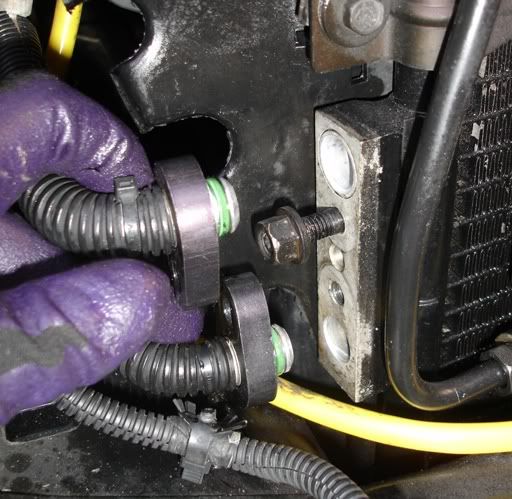

29) Remove the 3/8” rubber transmission hoses that run to the transmission oil cooler by sliding the metal clamps towards the center of the hose. Leave the hoses attached to the metal lines that run to the transmission (towards the rear of the vehicle).
a. You will lose a small amount of transmission fluid when you disconnect the hoses. I simply plugged the holes temporarily with a small rubber cork to prevent fluid loss.

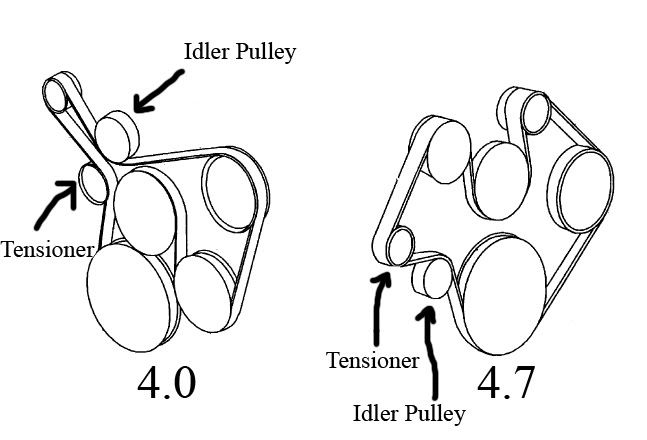

34) OPTIONAL: Remove the fan belt by using a 15mm socket to rotate the belt tensioner to
the right, which allows enough slack in the belt for it to be removed
34a) OPTIONAL: Replace the water pump
34b) To replace the fan belt, route the new belt CORRECTLY through all of the pulleys but around the outside (left side) of the idler pulley. Then hold the tensioner to the right again and move the belt inside (to the right) of the idler pulley.

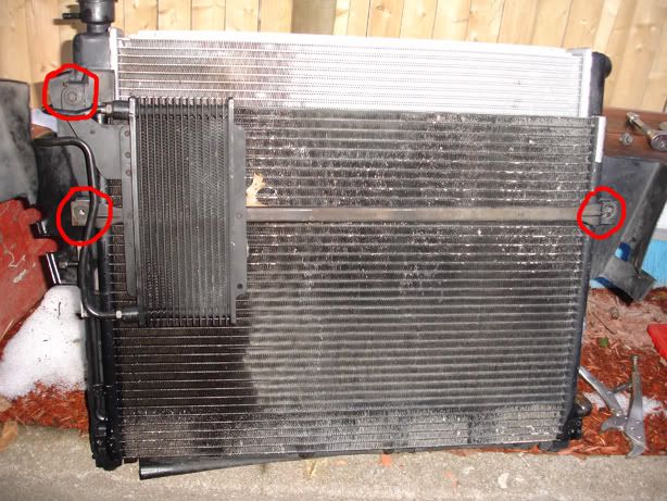

1) Remove the fan shroud and e-fan from the old radiator (4x10mm)
2) Place the shroud and fan on the new radiator and HAND TIGHTEN the 4 shroud bolts you just removed (you will need to temporarily remove one of the bolts to route one of the aux cooler lines in a later step)
a. You may need to reuse some of the metal retaining clips from the old radiator if your new radiator was not supplied with any. These are necessary to attach the fan shroud to the new radiator and are available at any auto parts store.
3) Remove the 3 metal transmission oil cooler lines from the old radiator/auxiliary cooler and set aside
a. 2 of these will need to be disconnected from the auxiliary transmission oil cooler prior to removal
4) Remove the auxiliary cooler and condenser from old radiator by removing the 3x10mm bolts and sliding the assembly up and out of the mounting tabs located on the lower portion of the radiator
5) Install the condenser and auxiliary cooler on the new radiator
a. You may need to reuse some of the metal retaining clips from the old radiator if your new radiator was not supplied with any. These are necessary to attach the condenser/auxiliary cooler assembly to the new radiator and are available at any auto parts store.

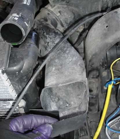

6) Remove the 2 plastic air diverters from old radiator and install correctly on the new radiator
a. These are very important because they ensure that moving air is routed THROUGH the radiator and not AROUND it

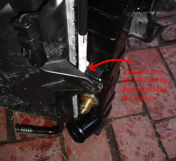

7) (Re)install the long auxiliary transmission cooler line
a. This line runs between the lower port of the auxiliary transmission oil cooler and the rubber transmission hose underneath the vehicle
b. You will need to route this line BETWEEN fan shroud and radiator (this is why the bolts were hand tightened earlier)

d. DO NOT OVERTIGHTEN this fitting because both the line and the auxiliary cooler are made of aluminum and can easily break/dent/crack if over-tightened
8) Install the upper radiator transmission cooler line from radiator
a. This line runs between the upper radiator fitting and the upper port of the auxiliary transmission cooler
b. This line loops up/over the radiator
c. Use thread seal tape on the threads
d. DO NOT OVERTIGHTEN this fitting as both the line and the auxiliary cooler are made of aluminum and can easily break/dent/crack if over-tightened

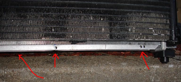

10) Remove the lower plastic air diverter from the old radiator and install onto the new radiator.
a. My new radiator did not have the correct holes in the bottom lip to reinstall the plastic air diverter so I used the diverter as a template and CAREFULLY drilled 7/32Ē holes into the bottom lip and used plastic rivets to attach the diverter.
