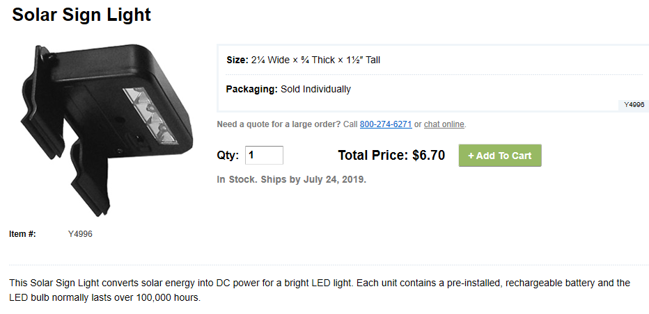

Nice, I had thought about doing something similar in the interim until I can fab a rear bumper. Not sure about Washington but in CO they'll pull you over if you License plate is not illuminated at night.

Here is what I used to "solve" that light problem:
https://www.safetysign.com/products/...light?s=sk1s41
Krakken likes this.
