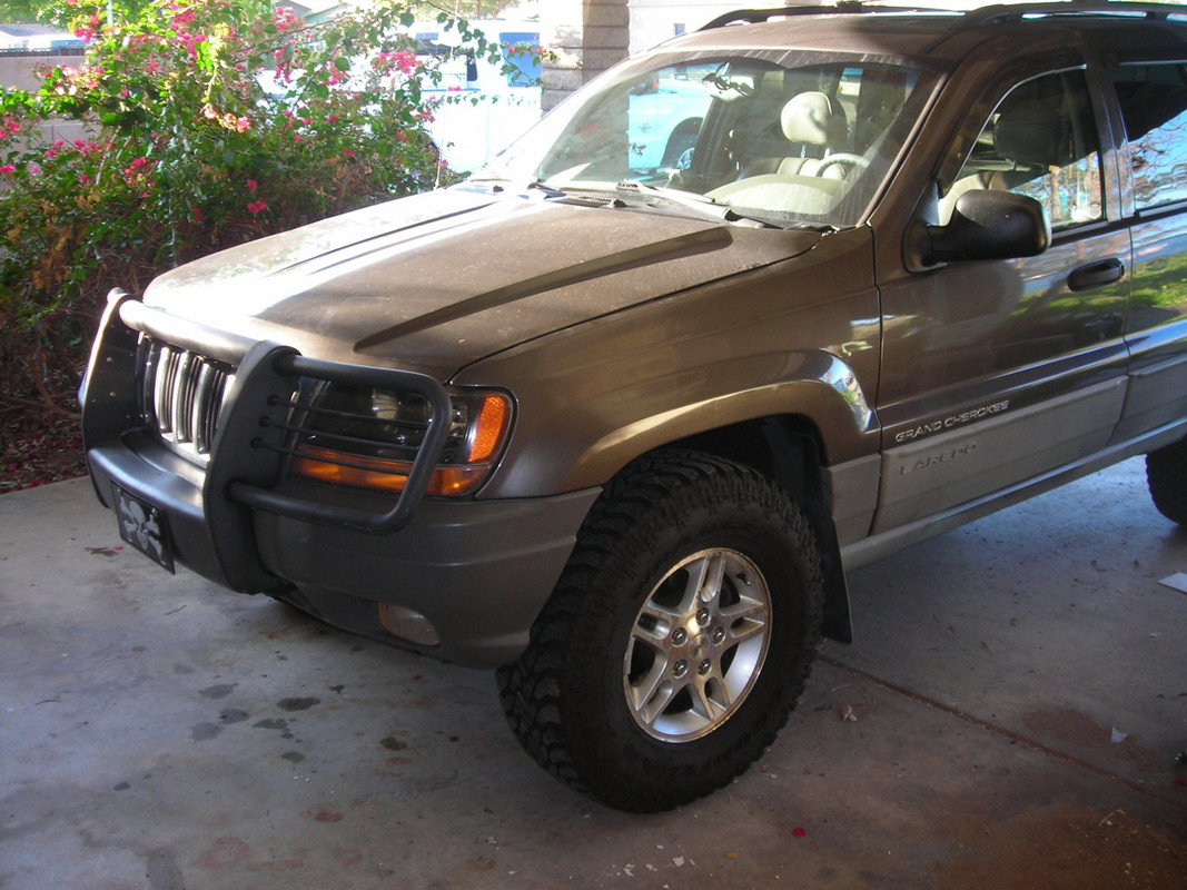

Soooo, I have this brush guard:
And I could use some advice for mounting recovery hooks, as it rather gets in the way of the normal mounting points for them.
I'll eventually replace the whole front bumper, but in the meantime, I'd like at least tow hooks, though I'd prefer shackles.

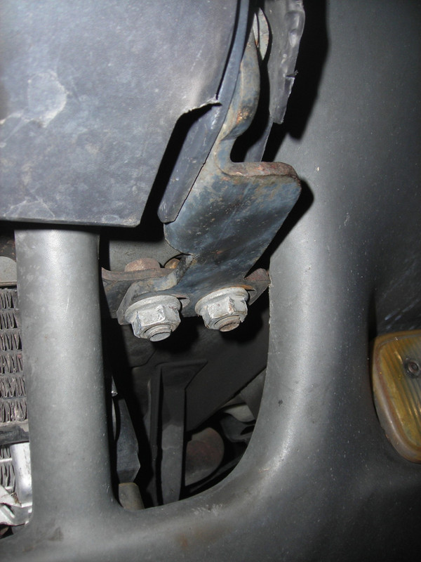

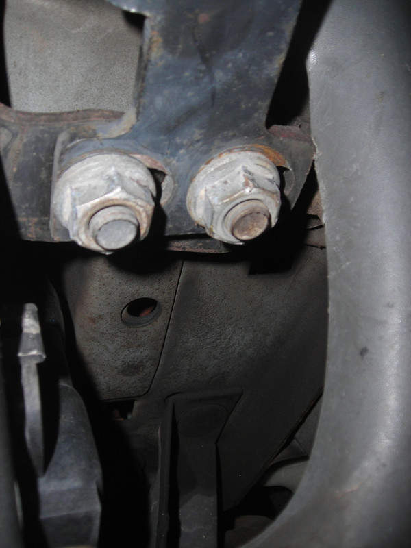

Let's see if I can post images yet:
The brackets take three holes, but the hooks themselves only take two.

Image went all broken, they seem to be having site problems. Here's a different one:

Those two bolts are not intended to be used to support the full weight of your Jeep in your bumper. The tow brackets actually mount to 3 bolts in the bumper... spreading out the load to a larger area of the bumper.
Outside of cosmetics, I don't think I'd use those.
