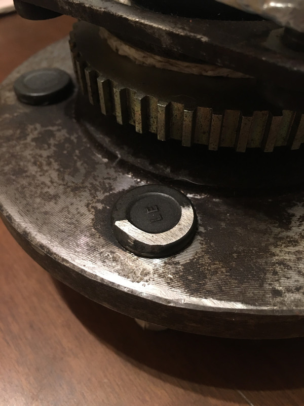

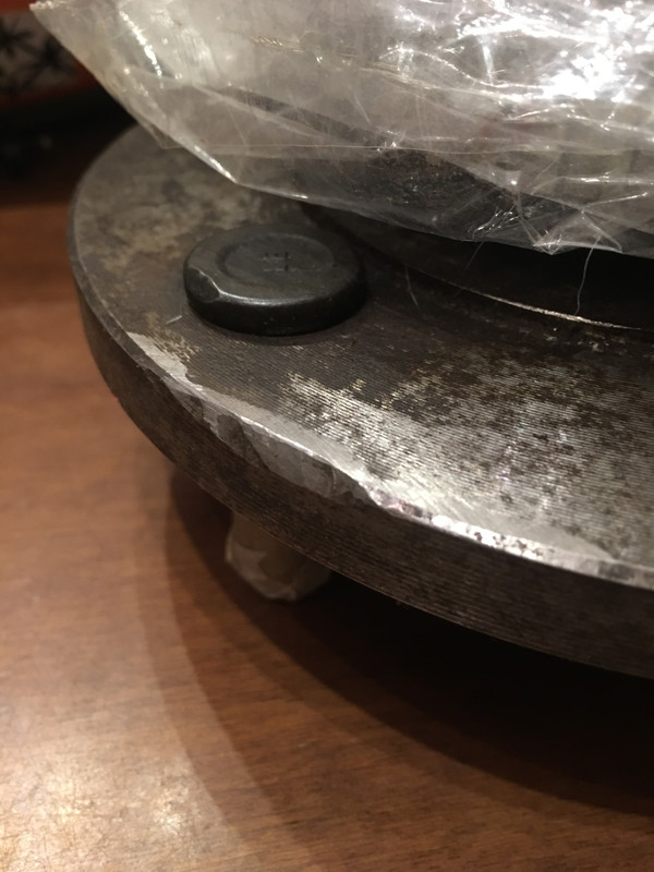

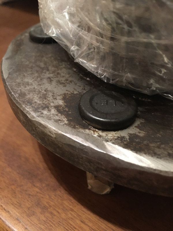

Just to complete infos about the shaft, here some pictures of the wheel plate:
and yes...., a puller..., a puller was enought to avoid this disaster.....
Grand Cherokee WJ 4.7 V8 HO. m.y. 2002

I would not be bothered by those hammer marks in the least myself....Yes, a puller is a better way to go, but what if you break it on the trail? A hammer comes out and makes marks just like that...
