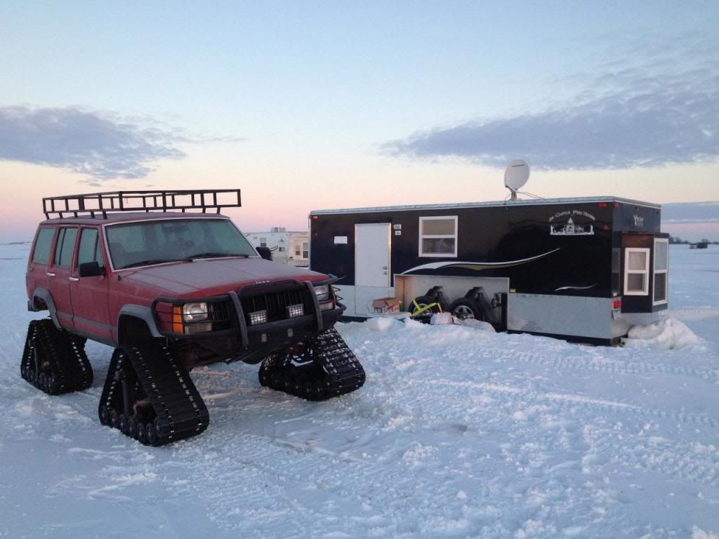

For context, here is a pic of how the XJ last year ended up.
[IMG][/IMG]

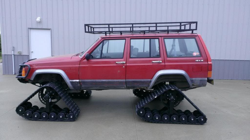

I'm not in front of the jeep right now; but here is a better pic from the side; from centerline of the hub to the ground is ~21 inches from memory for reference; so basically you are trying to fit 42's; which are worse in the rear due to the shallower angle as they are long tracks vs the shorties in the front.
On the XJ in the front i'm not having any clearance issues; but you can see I've cut a fair amount.
Yep; the clearance issue is only in the rear and only at the front of the rear tracks where it contacts right below the rear doors. I also only have impact issues when i'm fully loaded (house/4 dudes/gear) and we hit large snowbanks/ridges. This is where I think if I could get greater load capacity I'd be better (stronger springs)
Running with 2 dudes for example; I don't rub at all.
Here's a pic from the side that shows it better
[IMG][/IMG]

So on a WJ if you go adjustable control arms front & rear you could stretch out the wheel base & move the tracks away from the rockers, then just hack the plastic bumpers. Whats the distance from the axle centre to upper most part of the track?
for reference, my WJ with a 4" lift & 32"s, happ to do some measurements off it if you wish.

the clearance issue isn't going to be between the highest track point and the jeep; rather it'll be contact between the jeep and the track directly ahead of or behind the track in line with the axle
i'm guessing that the impact will be the leading edge of the rear tracks; so lengthening the wheel base would help; also going with a non long track would also help
I suppose I could try putting the short tracks on the back and see how big of a difference it makes; the load capacity is the same its just if you want the floatation
