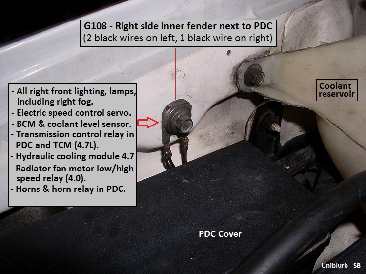

G108. Right side inner fender next to PDC. (3 bk wires, 2 eyelets)
All right front lighting/lamps including fog, electric speed control servo, BCM, coolant level sensor, trans control relay in PDC & TCM (4.7), hydraulic cooling module (4.7), radiator fan motor low/high speed relay (4.0), horns & horn relay in PDC,

i think i possibly found the ground wire that actually goes to the socket #85 for the transmission relay, using UniBlurb awesome pictures and diagrams i was able to use another schematic to trace that wire from the harness all the way to where its is supposed to be bolt to the body, it appears that it was actually resting on the ground bolt and when i would drive or any jolt it would momentary disconnect thus possibly losing ground directly to the relay, if this is the case i can i further up on the harness connect it to another grounding point like the other stud on the driver side of the engine block pretty much in the same spot just higher on the engine ?
ground G104 to the socket via harness passed the C102 harness by the firewall it turns black and yellow but from the ground point thru the harness it starts out *** solid black
20171107_122645.jpg   20171107_122337.jpg   20171107_122456.jpg   20171107_122530.jpg

Good find Irivera and real nice photos! Is that G104 ground on your 2000 4.7 on the far back passenger side of the block rather than the left/driver's side block like my 04 4.7? If so I'll add that location info to the write-up.
I don't have the 2000 WJ FSM but have the 2001. It shows G104 for the 01 4.7 the same as mine, on the far forward side of driver's block under the oil filter adapter. And as I found it's actually mid-driver's side block on my 04 4.7.
Can't see why you can't run that broken ground wire from harness to the tall/large stud to left of the driver's side of the plenum. And there aren't any other grounds on that stud anyhow.
I was going to wait until I cleaned my G104 on driver's side block to post a photo of it. I couldn't get a very good photo of it a week ago since it's clear back in there but will post it anyhow. I'll likely jack up the driver's side body to get to it. Here's the not-so-good photo of it with bolt half-hidden in the shadow.
2004 4.7L WJ Limited, 96 4.0 ZJ
