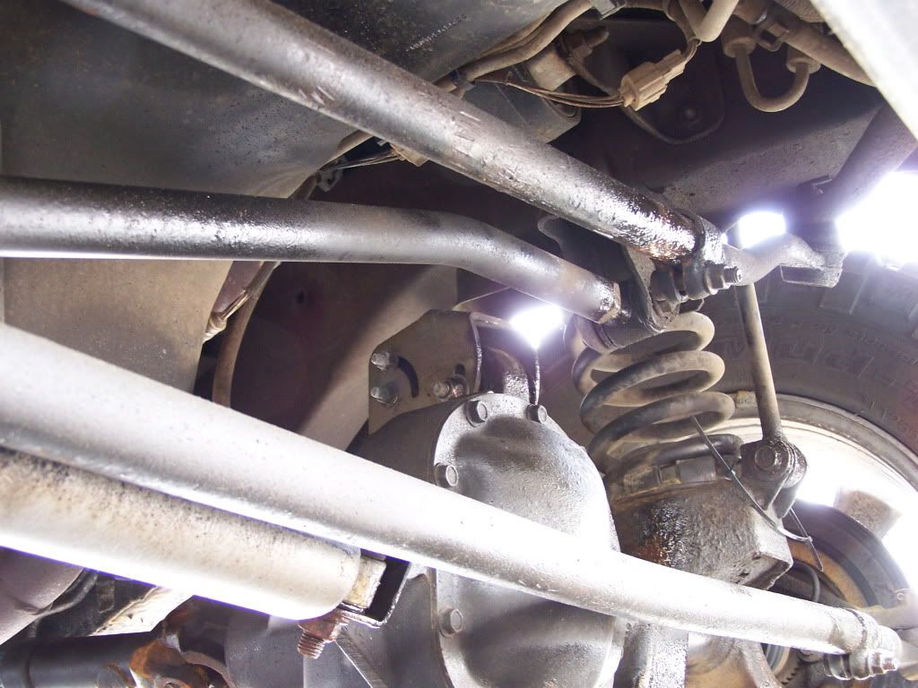

Can someone post a picture of their IRO Adjustable trackbar on their WJ for me? If possible can you just make sure you can see the whole trackbar. Which way is it mounted? Thanks.

don't have a picture on me but the side that's adjustable attaches to the frame/body the non adj. side attaches to the axle. you want to set it so when your jeep sits flat the lower end that's straight near the axle is parallel to the axle

here ya go

Thank you sir I had it in correct!

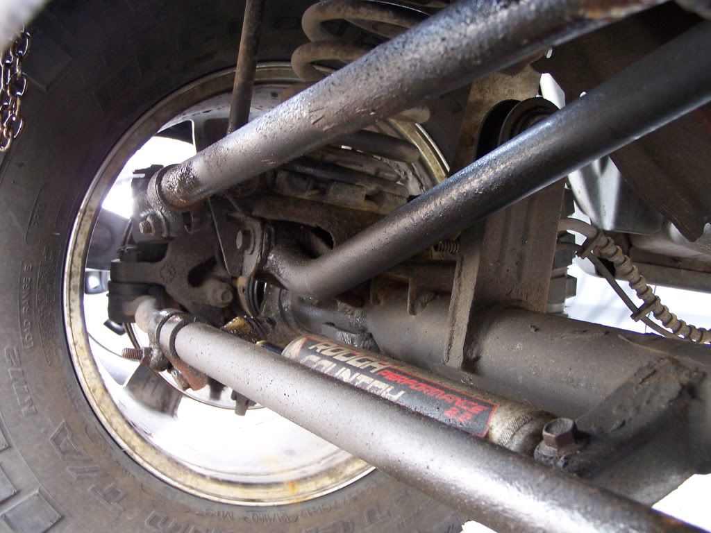

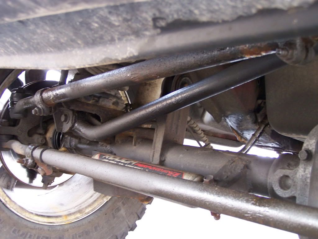

firman33 if you are looking at your track bar does that bend by the axle go really far down into the axle? can you try maybe taking a more level picture? Thats how mine is installed but it looks like mine is bent more than yours.

Sorry, i forgot yesterday lol, I hope this helps

Yea mine has been installed correctly it is just I have to check that bend near the axle bc I feel like mine is a little lower.
