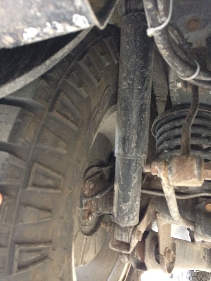

Got my Duratracs 265/65R17 mounted up with only a 1in upcountry lift. So far I have major rubbing on my discos when I turn hard to the left or right. I might try putting them on the other side of the sway bar and bolting down the top so only the bottom disconnects. Also, I have a tiny bit of rubbing on the front bumper while turning/flexing. My plan is to get a skinnier depth 4.5in fog light and put it in the hole. I'll be trimming the bottom uf the bumper up soon as well... but so far pretty happy with these tires. Also I was able to change diff fluid on my front and rear and add slip additive.
Tab bit of tire rub on the rear shock, but nothing I'm too worried about.

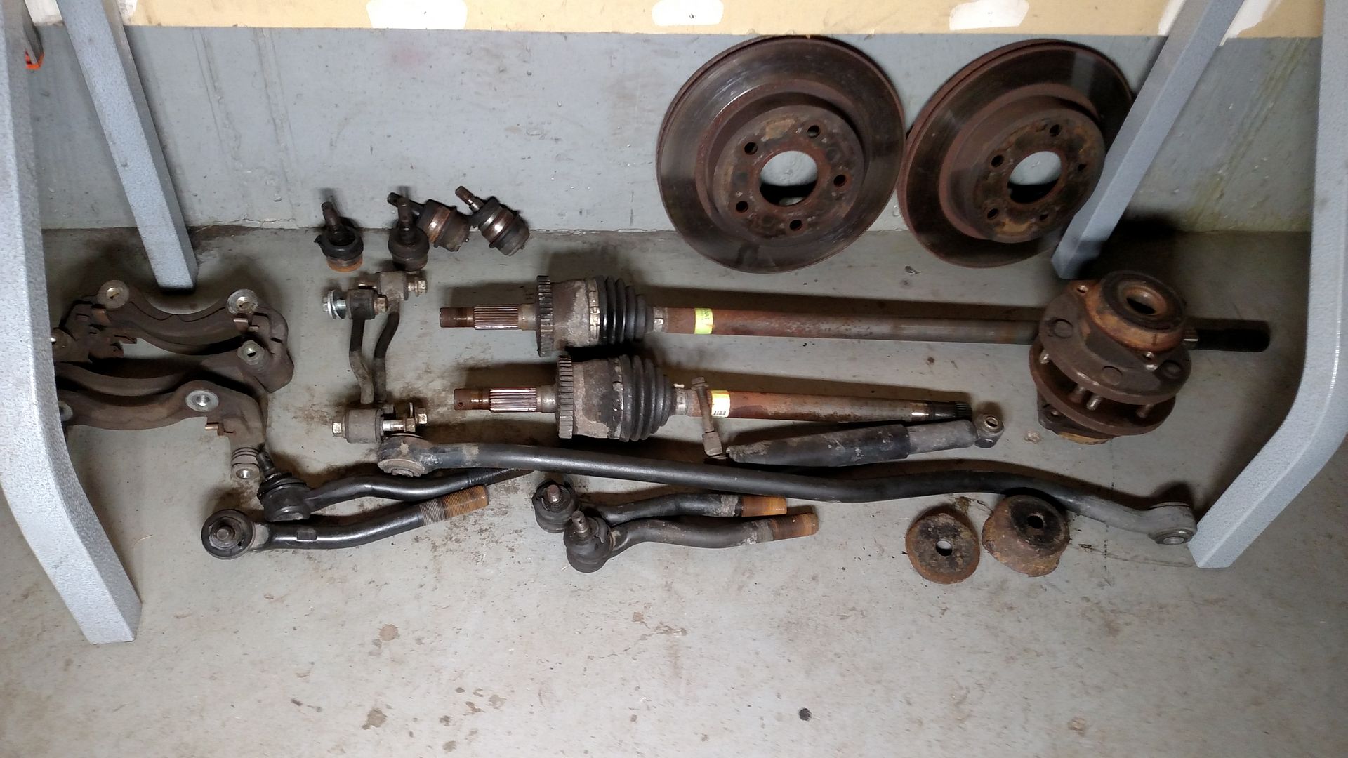

What to replace on front suspension/steering after 140k miles
Well when I got the Jeep, there wasn't a dirt/bumpy road around to drive on to test the suspension.. After going down my first dirt road a couple months ago I could hear a clunk as it hit bumps. Looking at the suspension components.. it seemed that all of the parts were still OEM. Here is my report of the suspension / front axle components that were definitely bad or just old and time to replace.

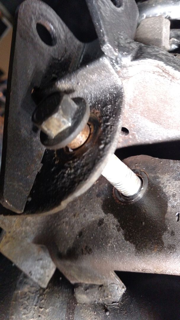

Track bar bolt hole - This was ovaled out on the left side (see pic). I think this was the biggest culprit to the clunk noise.
Wheel bearings - These were pretty much done, but not horrible. They just didn't turn as smooth as the new ones.
Tie Rod Ends - Both bushings were shot.
Drag link ends - bushing on the wheel side was shot. Bushing on the pitman arm looked good.
Spring Perches - Rusted out
Ball Joints - lower ball joint on both sides was loose and wiggly. I replaced all 4.
The rest of these items seemed to be ok but I replaced them anyways
Axle Shafts - decided to replace these while I had the hub apart.
Track Bar
Sway bar links
