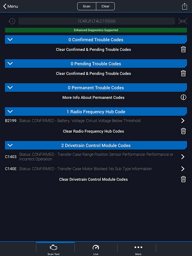

Well that didn't take long. "SERV 4WD" light on. 691 miles on the odometer. 2020 Grand Cherokee Trailhawk 5.7, owned for one week. Not even doing anything questionable. The driveway in to my shop is steep with loose gravel. I can get regular vehicles out by gunning the motor a bit while on the concrete, building some momentum and easing up the hill. With the Jeep I put it in 4x4 low (just because I hadn't put it in 4x4 low before) and backed out. Went about 75 feet. Could not get it out of low gear. Got the trouble light. Had to power down & restart the vehicle to get it out of low gear. Plugged in my code reader and got codes C1403 and C140E.

the codes are pretty descriptive, "motor blocked" and "incorrect position", although not recommended to drive in 4LO on grippy terrain, I'm not sure how the user could have done this by that...unless some the "binding" energy was stored in the transfer case gears and was released upon unlocking with an added force. Did the light come on while you were driving OR during the shift to-from 4LO/4HI?
To bring this thread full circle.... The dealership found a bent pin on one of the 4WD connectors. They repaired it, test drove it, and the problem did not recur. So that seems to be solved.
