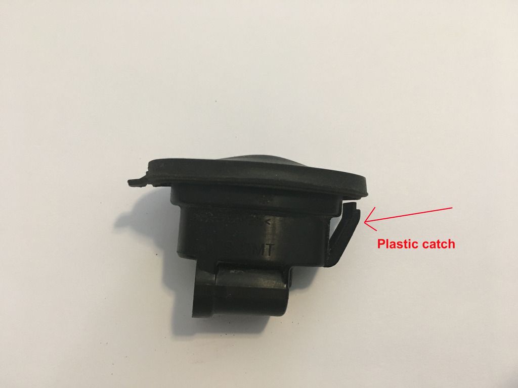

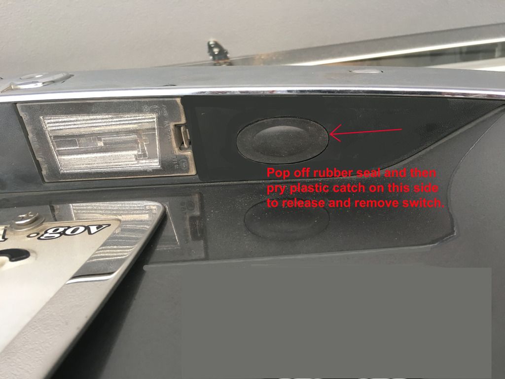

I found it!
To remove and replace the rear hatch window switch is a fairly easy job to do. I thought I was going to have to pull the inside trim of the hatch off to do it, but that wasn't the case.
The switch is a pry out / push in install.
On the RIGHT side of the switch, pry the rubber seal off until you can get a SMALL screwdriver between the switch and the hole to release the plastic catch.
Unplug old switch wiring and plug new switch into wiring.
Then the LEFT side must of in first (plastic tab points into the hole) and then just press up and the plastic latch will "click" so you know it's in.
Total time, 5 minutes!
