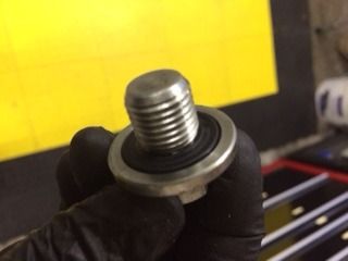

Be sure to clean the gasket on the drain plug, mine had some gunk on it:

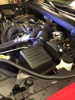

Remove the engine cover by pulling straight up on it:

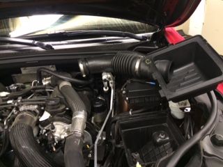

Then loosen the hose clamp on the intake by the cowl area and unclip the airbox clamps. You can then swing the airbox up and out of the way. I left it attached since the MAF wire has a troublesome little plastic clip on it.

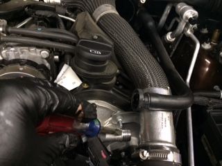

There is a vacuum hose also running directly over the top of the oil filter. You can unclip it by squeezing the connector top and bottom and disconnect it. Then swing it up and out of the way. Connection is at the tip of my screwdriver below:

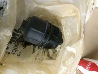

Use an oil filter socket (or a 1-1/16in socket fit fine) to remove the oil filter canister cap. You will tilt it to the side just a bit and hear the vacuum pressure release. Have a plastic bag handy to drop it into so oil doesn't drip everywhere.

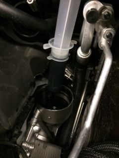

Now here is the biggest lesson I wanted to pass on. There will be a few ounces of oil left in the filter canister. If you drop the new filter and cap back on it is going to overflow as it pushes down. This would have been a huge mess. I used a 60cc syringe to remove the remaining oil.

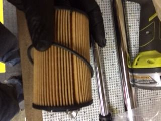

You will have to pull on the actual filter pretty hard to get it out of the cap. The base of it snaps in. When you put the new one in, be sure it clicks into place. Make sure your new filter comes with a new o-ring (this could be an issue once aftermarket companies start producing them. The Mopar comes with one). Remove the old one from the cap, lubricate the new one with oil and replace. Lubricate the small o-ring on the end of the filter as well.
The new filter and o-ring as it comes out of the box:
Do not over tighten the filter cap since it is plastic. It only takes 25nm.
