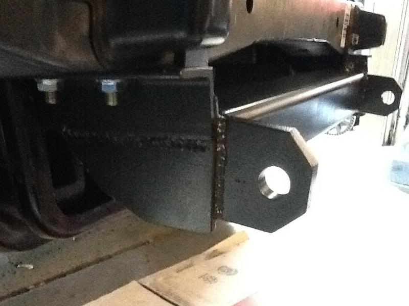

One question...
Where are the best options in the frame, etc; to screw the bar to where the halogens are going to be...
Looked for "factory" points like for the hitch in the rear, but couldn't see any....

Most things like bull bars, recovery points, and even steel bumpers use the factory tow hook locations. If you could bolt your light support bar there, it would be solid. Here is a photo from my Jeep when I installed a recovery system made by AtTheHelm. I had the bumper off but you can see where it attaches. The tow hook holes are under the crossmember, but the bolts going through the front of the crossmember I drilled, if I remember correctly.

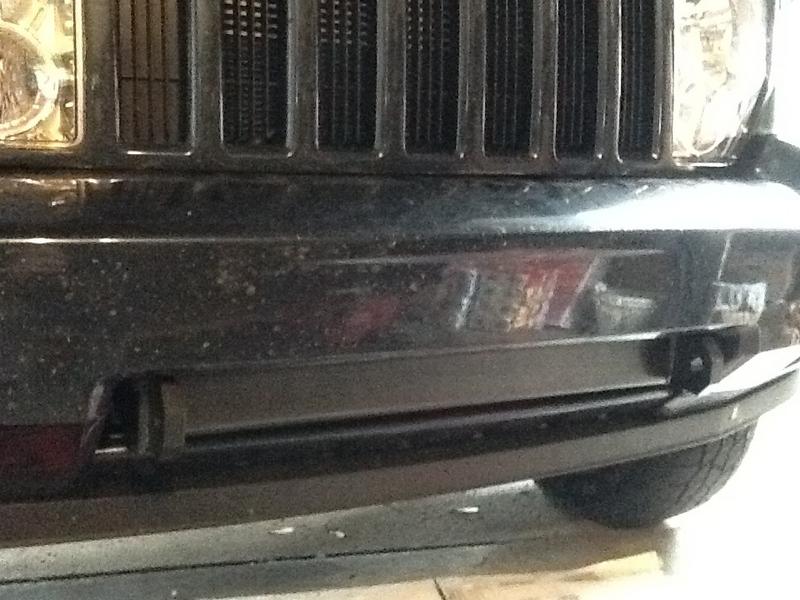

With the bumper skin on, for context.

Thanks for the design idea...
I have something on where to start with the design...
Very well appreciated...

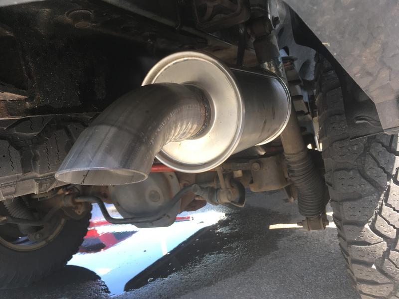

A clunking and rattling sound turned out to be a rusted-through exhaust pipe. The resonator broke loose! So today I got it replaced.

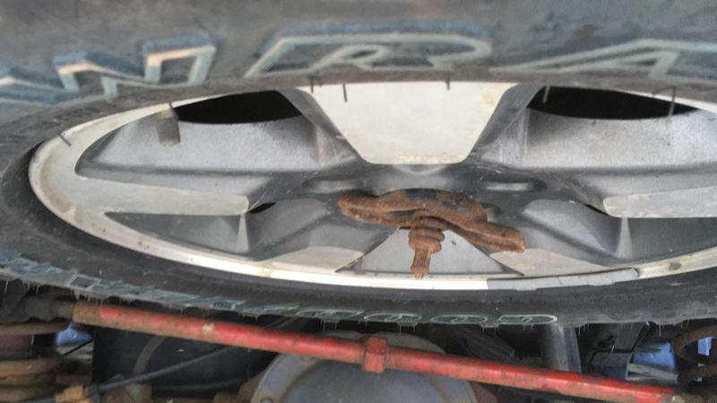

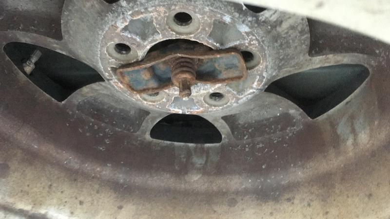

While I was down there I noticed my spare tire was installed upside down from the way I like it.
This orientation leaves the polished side of the rim open to damage from the road or trail. Also, the spare tire hanger can mar the surface where the center cap goes.
Luckily, no damage to speak of.

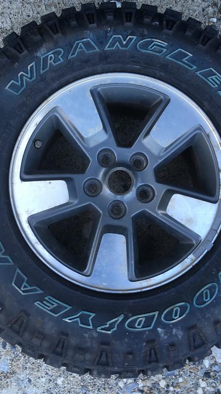

I reinstalled it properly by my way of thinking.
The only potential issue of keeping the spare in this orientation is not having access to the valve stem to check the tire pressure, but I carry an air compressor and can fix it if I ever need to use the spare.
