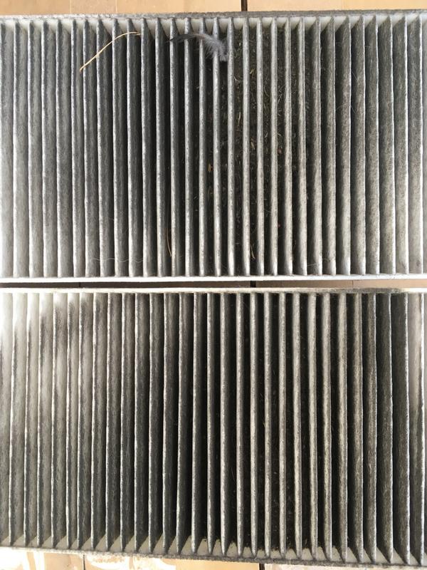

... and if it has an in cabin air filter, check it. The one in my daughter's 12 was blocked.

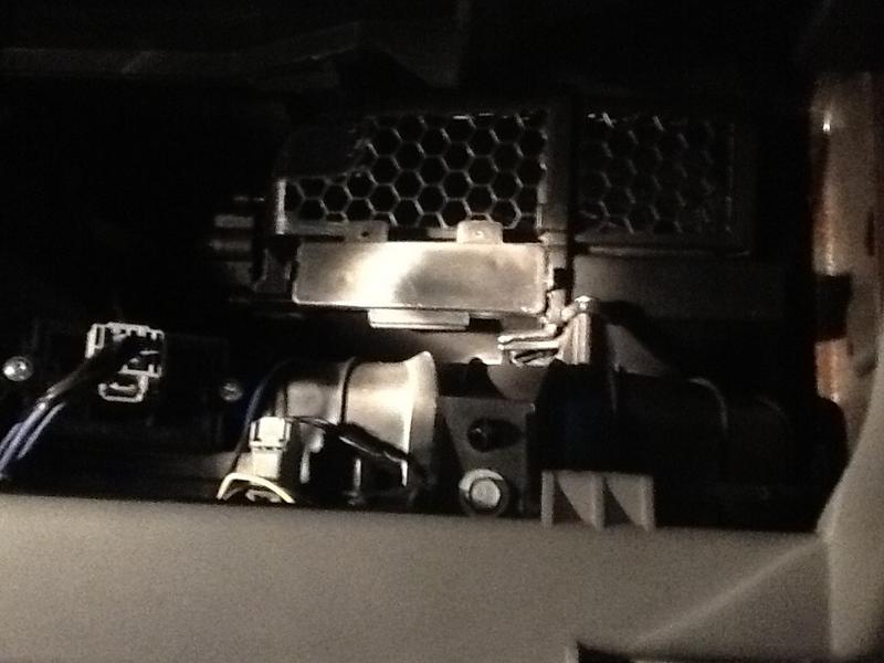

There is a cabin air filter. It’s located behind the glove box. Open a small rectangular plastic door and the filter will come out in 2 pieces. You’ll be glad you changed it.

I'd be embarrassed to post pics of how dirty the cabin filters were in mine LOL...even a few pine needles stuck in there!
I got them replaced but still working on getting heat (although the fan runs way better now!)

I checked my air filter location, where everyone tells me to check it out, and there is no place for me to change the cabin air filters. Any suggestions? I belive it is eiether located at a different place (Which I cannot gind) or theis model simple came without a cabin air filter. Here is the picture>
joseblesa is offline
post #14 of 15 Old 09-16-2019, 04:13 PM
lfhoward
lfhoward's Avatar
2008 KK Liberty
Join Date: Nov 2012
Location: Philadelphia
Posts: 1,333
Looks like yours didn’t come with that option, unfortunately. However, you can retrofit it! That’s what I did on my 08.
