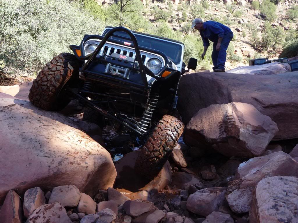

You need lockers to get threw this haha
[IMG][/IMG]
