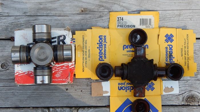

Spicer makes many different types of u joints even for the same application. Brute strength would one with out grease fittings since there is a hole threw the center of the joint(good 1/4 mile runs). Spicer also has the tipple seal ones(Spicer life i believe) they are available in greaseable and non. It depends on your application but i would not use any other u joint. When i got my daily driver 18 years ago(non jeep) it had front axle joints where history. At the time didn't think too much about at and replaced them with "precision" ones. Well they didn't last two years! Then i replaced them with the greasable spicer life ones, Well they have been on there for the last 16 years with no issues. Pic of the actual joint that was replaced with the Spicer next to it...
littletoes likes this.

Great picture V8GCZJ!
Thank You!
