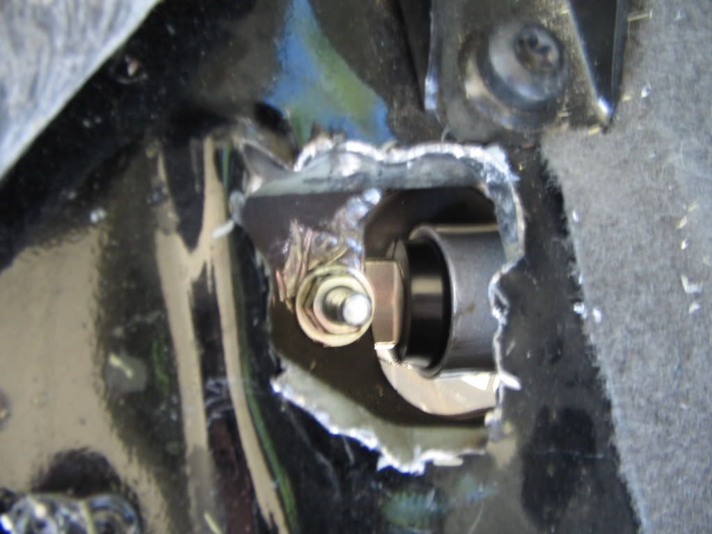

I broke a bolt off at the right rear upper shock mount. Tried to remove it by drilling a hole into the bolt and turning with an ez-out. The ez-out broke in the bolt. After much cursing and soul searching I did the only thing that I could. I cut a hole in the tub to access the welded nut and dremmeled it off.
The hole is still there. I think I'll make a removable access plate for it.

you could have just taken off the body mounts up to just in front of the doors, then jacked up the body and stuck your dremel in there...no need to cut the tub next time!

Should I tack weld the nut and washer to the frame or is it ok like it is?

I left it as it is with the new hardware...I figure if I ever have to get at it again, I only need to lift the body enough to get a socket on it.
The reason it was tackwelded in the first place was just to make it the same effect as a nutsert. But the bolts are small enough and weak enough grade 5 hardware that they just rust and snap...I broke all 4 of them
As for your hole, I would just weld a plate over it and then paint it and call it a day. I doubt anyone will ever even notice it once you patch it up.
