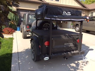

A few more photos - With the Jeeps out of the garage I took a few photos with a better view of the trailer.
One of the swing-down stabilizer jacks I picked up last week at an RV surplus outlet is leaning up against the trailer frame at the rear. They're extra long and they'll be perfect, mounted to the underside of the frame they'll have more length than necessary.

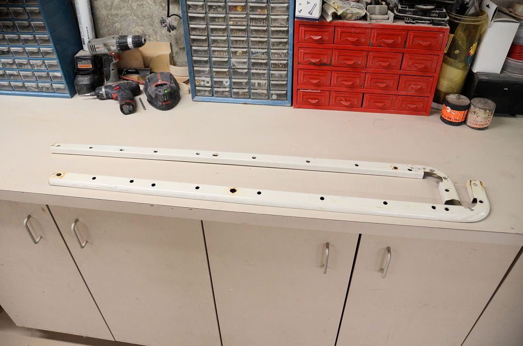

When I made the pop-top for my Jeep-tub trailer I used factory TJ soft top rails on the top of the tub to secure the canvas in the same way that the factory soft top secures to the Jeep. I've written about that before.
And I put soft top rails on top of the camper top as well so the pop-top canvas would work on top of that.
If you plan to do a canvas top or something similar on your Jeep-tub/Dinoot trailer, you might keep your eye on your local u-pull junkyard for TJ's. The rails are spot-welded to the tub, but it's easy to drill out the welds to remove the rails. My local junkyard charged $3.00 each for these. Enough TJ's are showing up in junkyards these days that it' wasn't hard to pick up all the rails I needed pretty quickly. Even though I don't have a current need for more rails I keep my eye on the new arrivals web page at the local u-pull; any time a new TJ shows up in the yard I'll go grab the rails for future projects.
