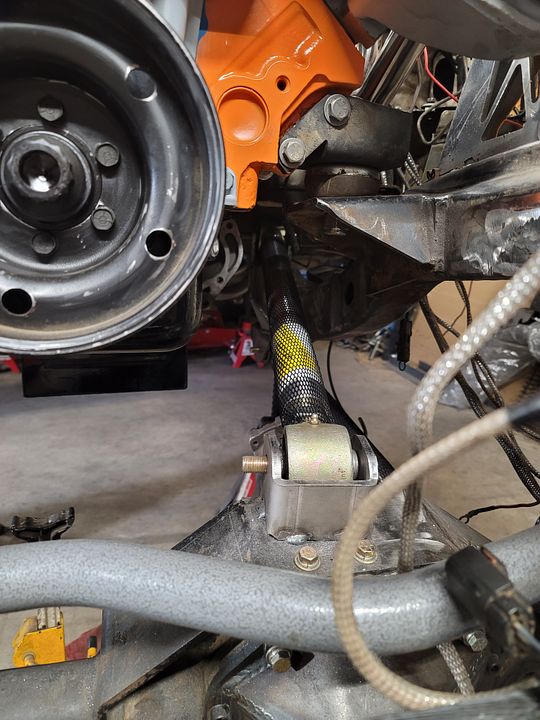

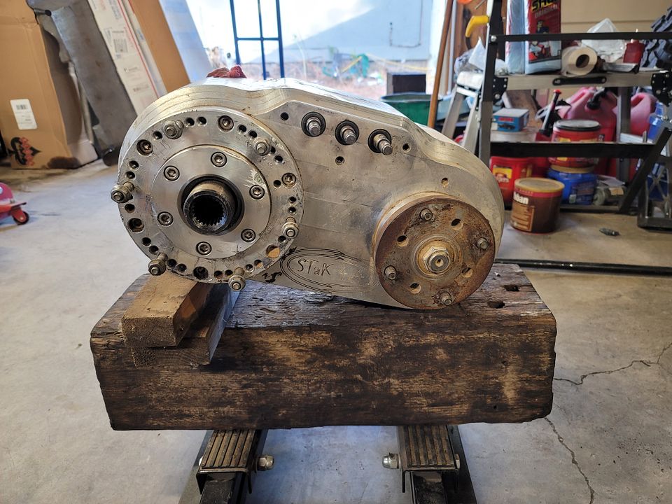

This is one sexy SOB but let me tell you it's HEAVY too.

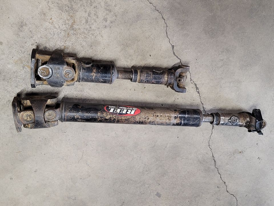

It's 150 lbs of beef. But I got it installed so I could measure for my driveshaft lengths & route wiring.
Rear shaft is 23 1/4" long
And the front is 38 1/2" long
I'll have to take my old shafts over to Yakima to a driveshaft shop and have them lengthened.

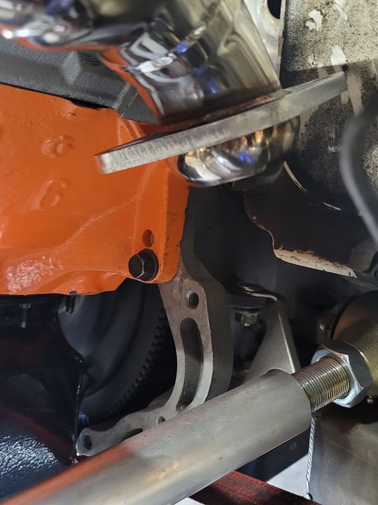

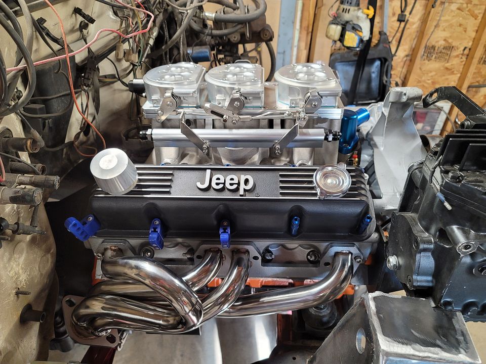

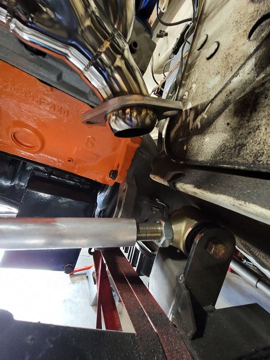

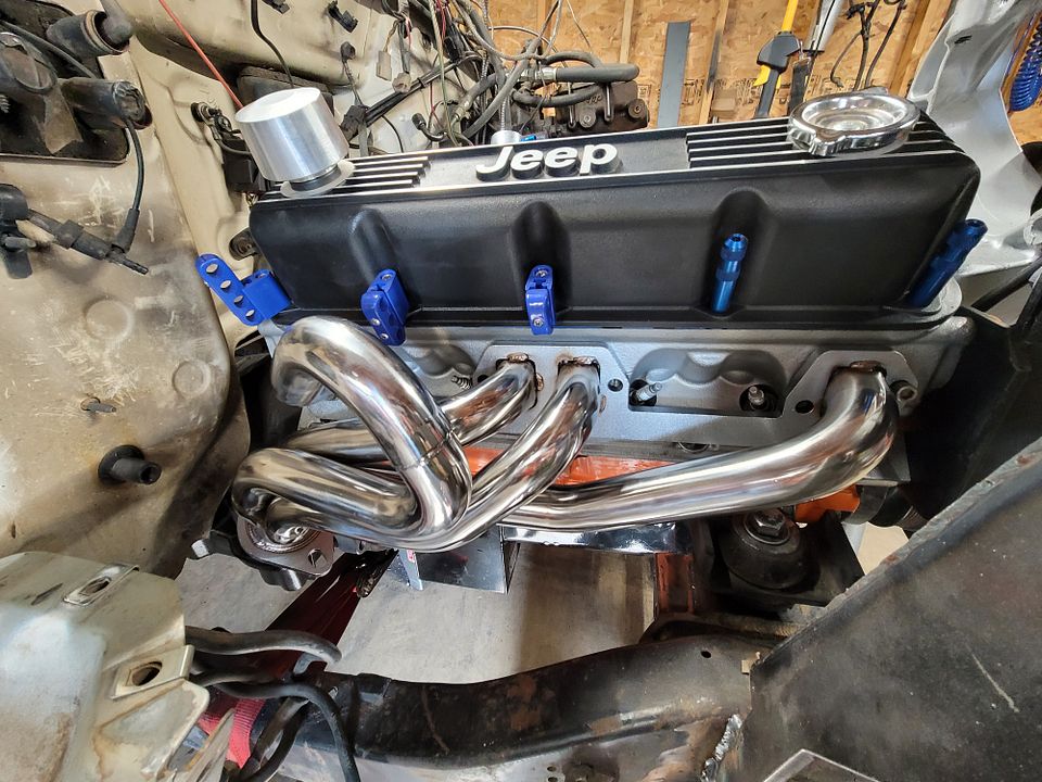

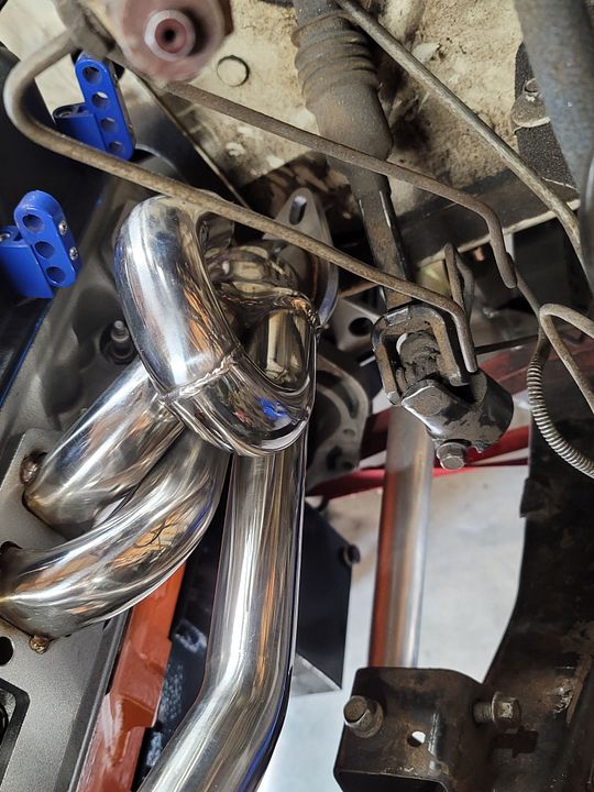

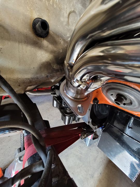

Since I had the engine installed I decided I'd slap the headers on and see how they fit.
Drivers side MIGHT be a issue.
If I take the lip off the tub there might be enough room.
Passenger side of course will not be an issue.
And then had to drop the intake on so I could get the wiring laid out to each sensor since they aren't in their stock locations.

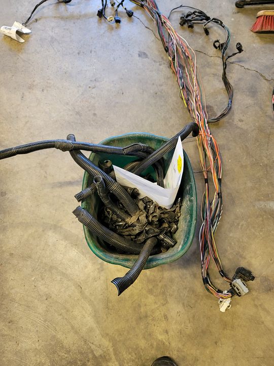

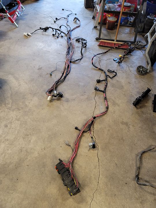

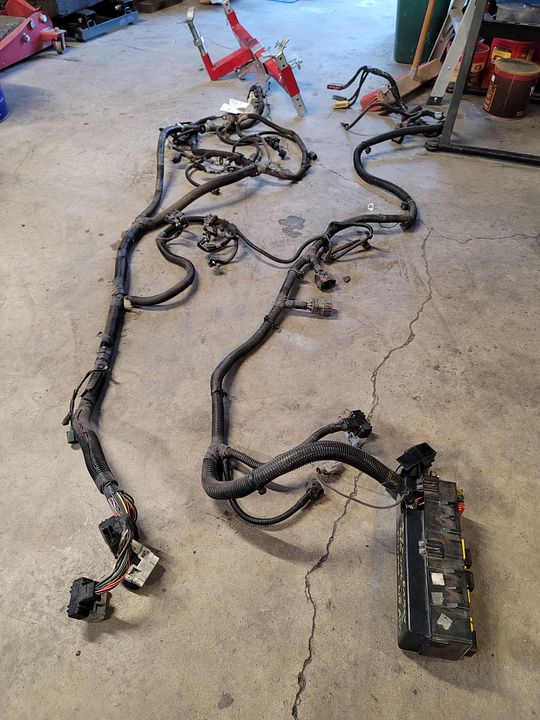

And then comes the wiring. Here is a Dodge Ram 1500 wiring harness and a Jeep TJ early 1997 build harness that I'm going to blend together over the next few days. OK maybe over the next week...
Stripped all the old plastic loom off both harnesses.
What a flippin mess.... Old brittle & greasy mess.
I'm going to reloom it all with a loom kit from Painless Wiring.
Taggin all the sensor plugs with shoe tags.

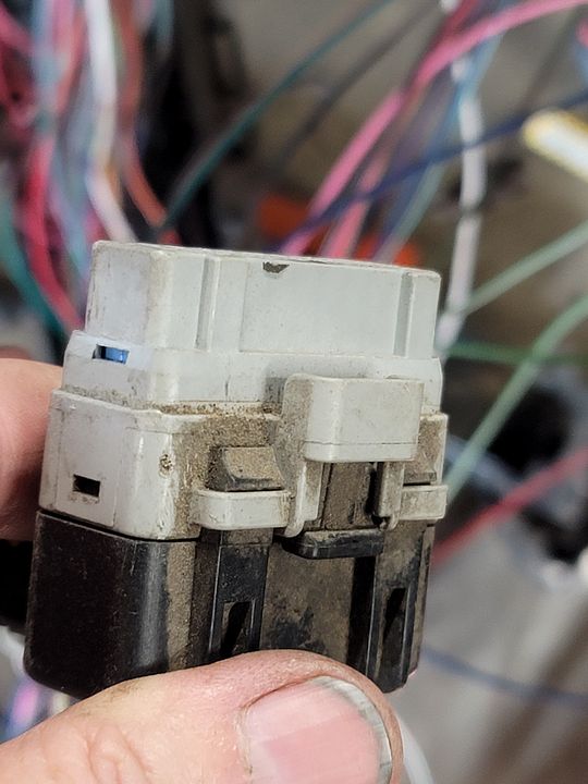

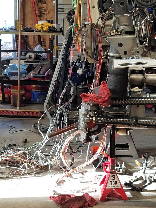

Worked on the wiring some more today but still didn't do any cutting yet. I'm trying to understand and map out exactly where the what and why of where each wire is going. I have my old harness that Evan from Backwoods Off-Road that made the engine run and everything worked but it was having issues. So I'm cheating a little but at the same time I'm also doing it my own way. One of the things I am doing differently than how many do this swap is that I am using the Dodge wiring harness and blending in the TJ harness.
This is what I was staring at most of the day as I traced wires.
When using the Dodge wiring harness you don't use the gray PCM plug but instead you use the TJ plug.

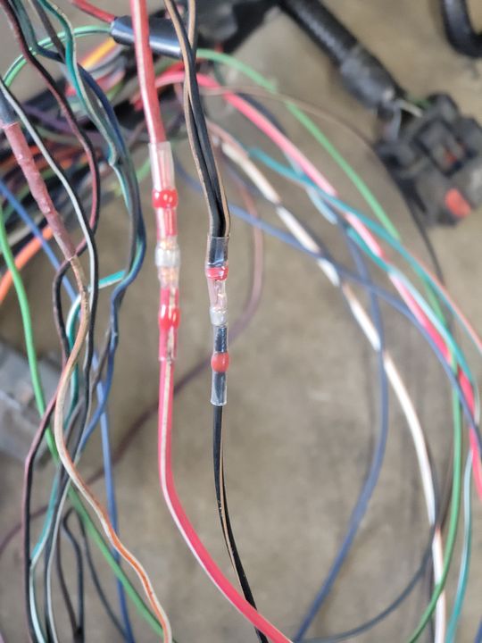

Finally decided it was time to take the plunge and cut some wires. I had everything figured out and knew where each wire needed to go so I got the side cutters out and took a leap of faith.
The first cut was a little nerve racking but then the second one was a breeze.
By cutting those wires I ended up with this no longer being a part of my Dodge harness.
I've got all the wires taped together for now and once I get it laid out and get things looking neater and routing is cleaner I'll splice the wires together.
Here is the old wiring harness from Backwoods Off-Road. It'll take some parts from it before I toss it.

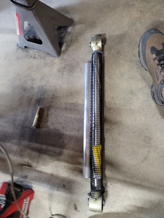

Got the replacement upper link in from WOD today. So I got that installed.
The old link and the new link side by side.
And the upper link installed.

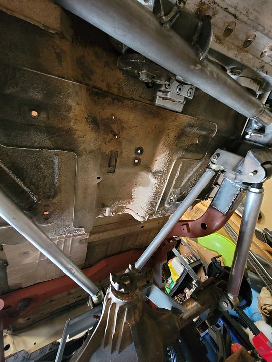

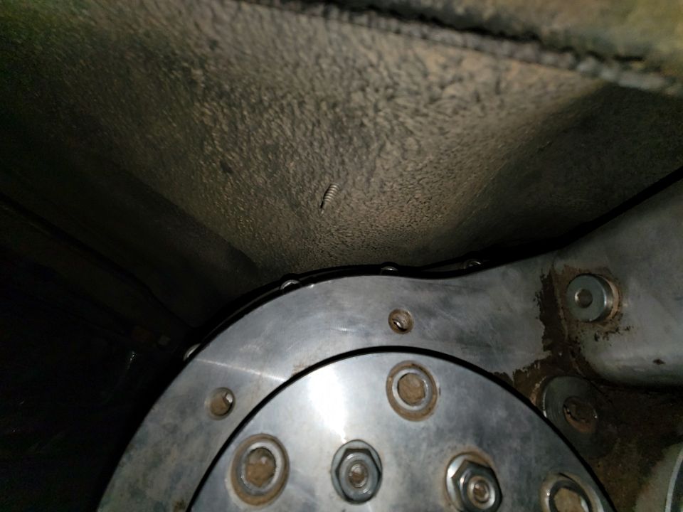

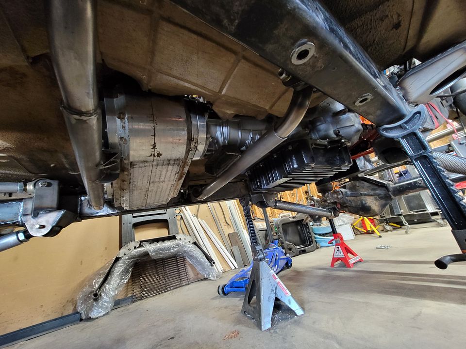

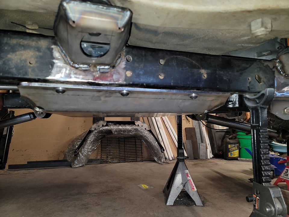

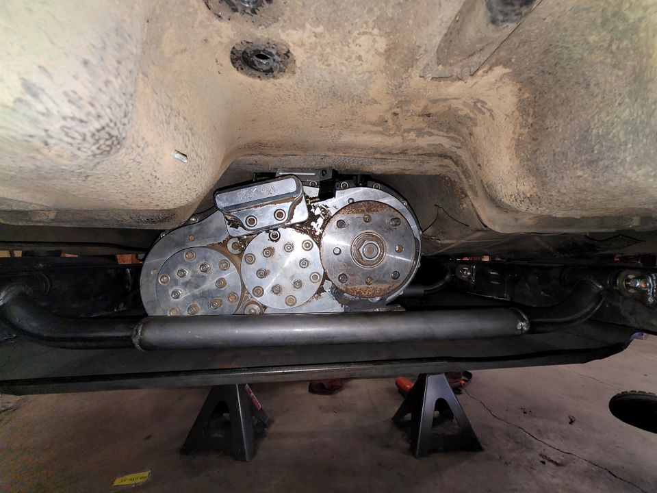

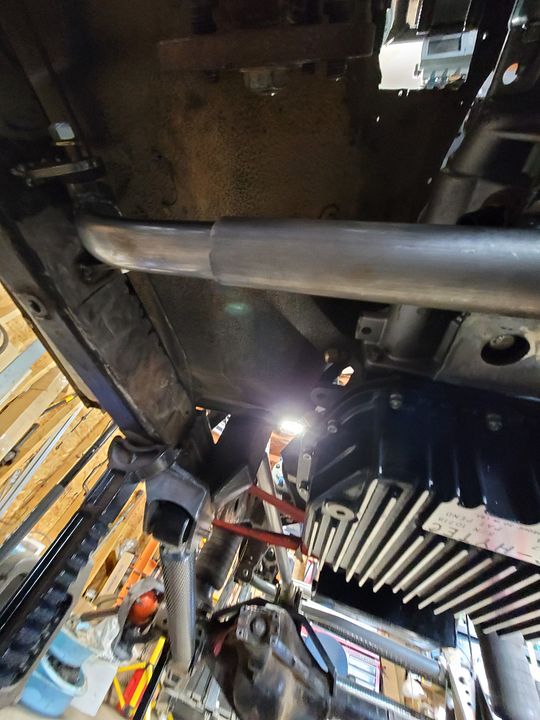

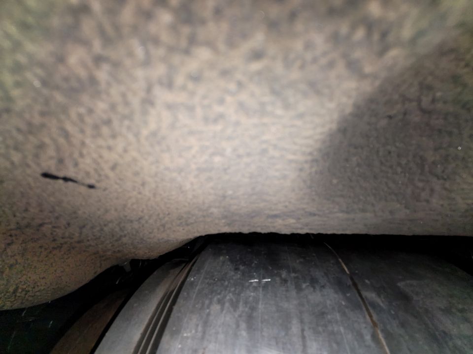

Well I started the day off under the Jeep. I'd crawled under it to verify my driveshaft lengths and then while I was there decided I would throw the belly skid back on to verify clearances.
The crossmembers all fit fine and there aren't any clearance issues.
I have about 1/4" around the top of the STaK t-case.

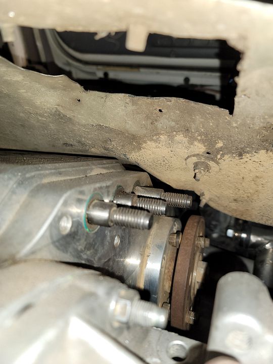

Here is a shot from the inside since my floorboard is still open.

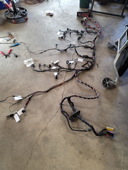

Then I decided I'd tackle the wiring. I'd taped the wires together that needed to be spliced but wanted to lay the harness out and make thing neater. So I got it laid out on the floor of the garage and got the routing neater and started to splice all the wires together.

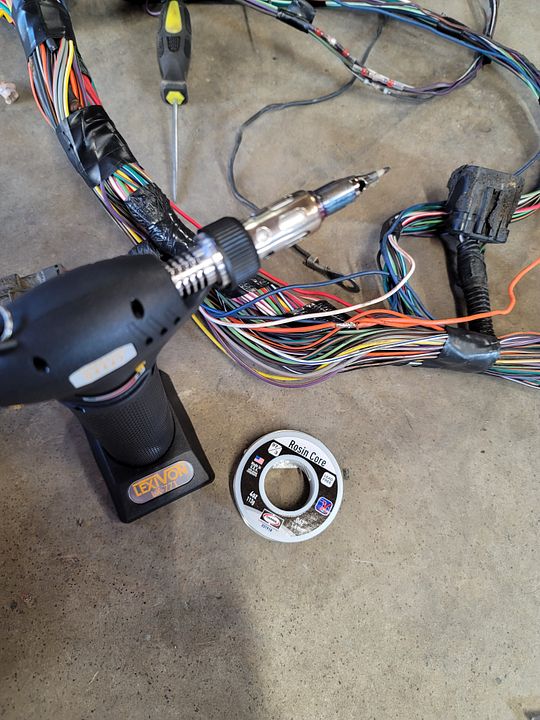

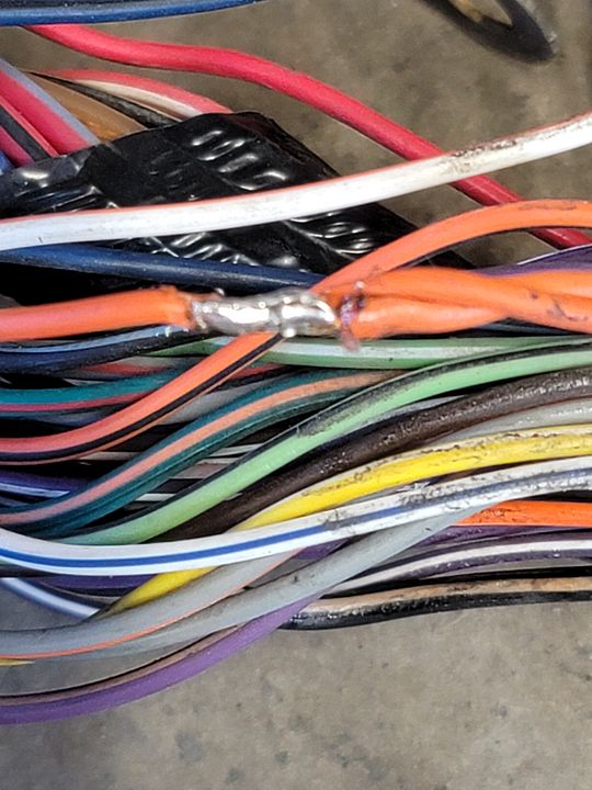

Then I needed to solder one joint where I was connecting a wire into a line that wasn't cut. So I got to break out my new torch/soldering iron.
It worked great and I taped it all up once I was done.
Then I went thru and did a final taping of joints and it is now ready to be installed into the Jeep. Once I'm ready to fire up the engine and verify that the wiring is all good and it runs plus the gauges all work then I'll put the loom on.
