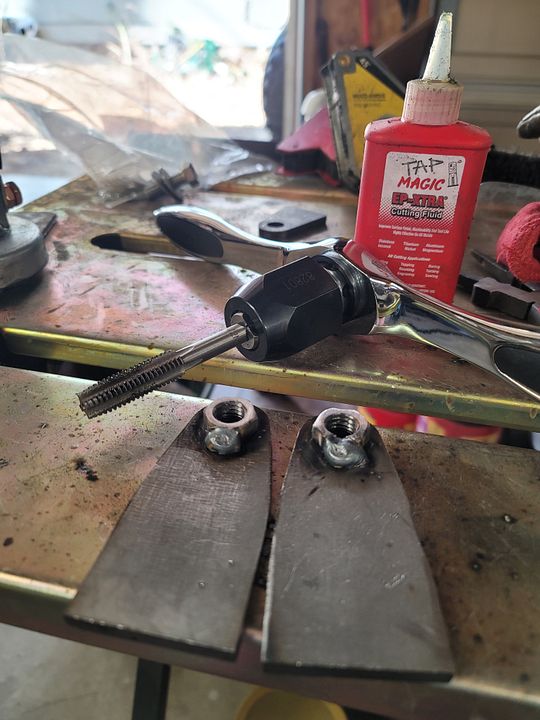

post #634 of 805 Old 08-31-2021, 07:16 PM Thread Starter
wildman4x4nut
wildman4x4nut's Avatar
Join Date: Dec 2004
Location: Cle Elum
Posts: 1,627

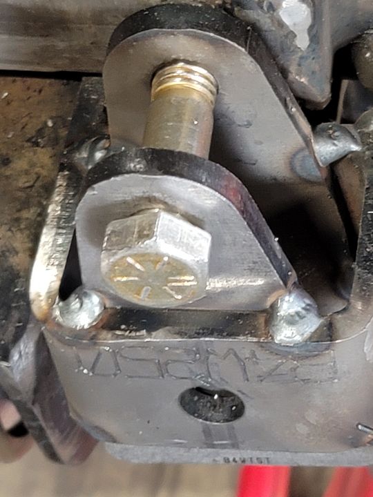

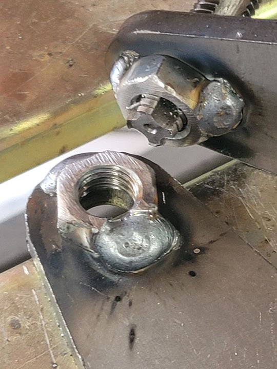

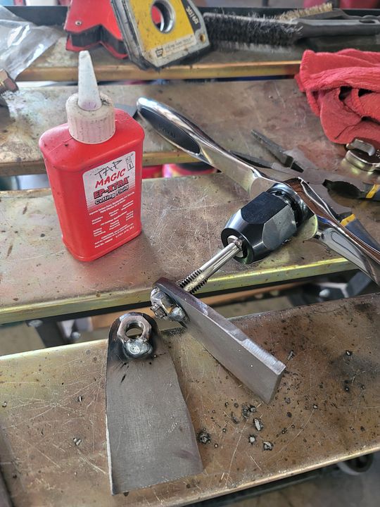

A member from the Wrangler TJ forum had suggested that I weld some nuts to the backside of the shock tab since I didn't have much clearance between it and the spring pad. Of course I was looking at it and over thinking the whole thing.
So I dug around in the ton of coffee cans with nuts and bolts and found two nuts the correct size and welded them onto the back of the tabs.
After I got done welding the nuts on I ran a tap thru both of them to make sure the threads didn't get buggered up from the welding.
Once I'd chased the threads on both nut I started to play around with making sure the tabs were positioned just right for the bolt to screw in easily. So I'm still messing around with them but it was time for a break.
So I know what I'm doing first tomorrow and then I'll tack everything together and double check fit.
WILDMAN
Cle Elum, WA
wildman4x4nut is online now

post #637 of 805 Old 09-01-2021, 12:30 AM Thread Starter
wildman4x4nut
Join Date: Dec 2004
Location: Cle Elum
Posts: 1,627
Went back out and worked on the mounts a little more. I took some bolts that were too long and cut them down so I have the shoulder of the bolt that shock will ride on. Got the tabs setup where I can screw the bolts in by hand.
Drivers side bolt will need to be shortened just a hair or I might just throw a washer on it instead.
Passenger side is better.
So tomorrow morning I'll tack them in place and make sure nothing shifted. Then I can put the shocks back on and start to cycle the suspension. Once I get that all checked out I can finally order the new front control arms.
Wide Open Design builds them out of aluminum and also sells aluminum steering linkage. I've never tried running aluminum drag link or tie rod before and am thinking I might order some just to see how I like it.
WILDMAN
Cle Elum, WA

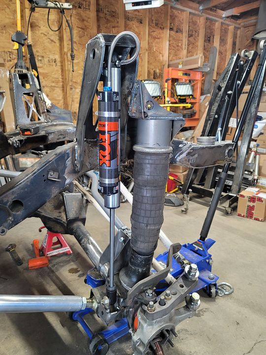

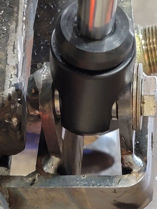

post #640 of 805 Old 09-01-2021, 06:52 PM Thread Starter
wildman4x4nut
Join Date: Dec 2004
Location: Cle Elum
Posts: 1,627

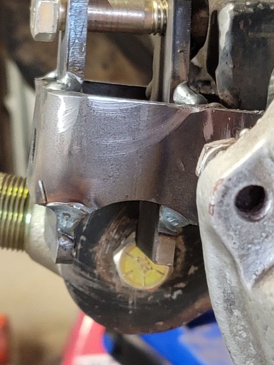

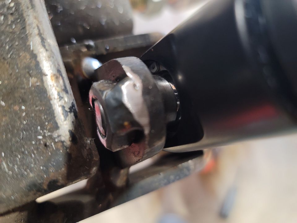

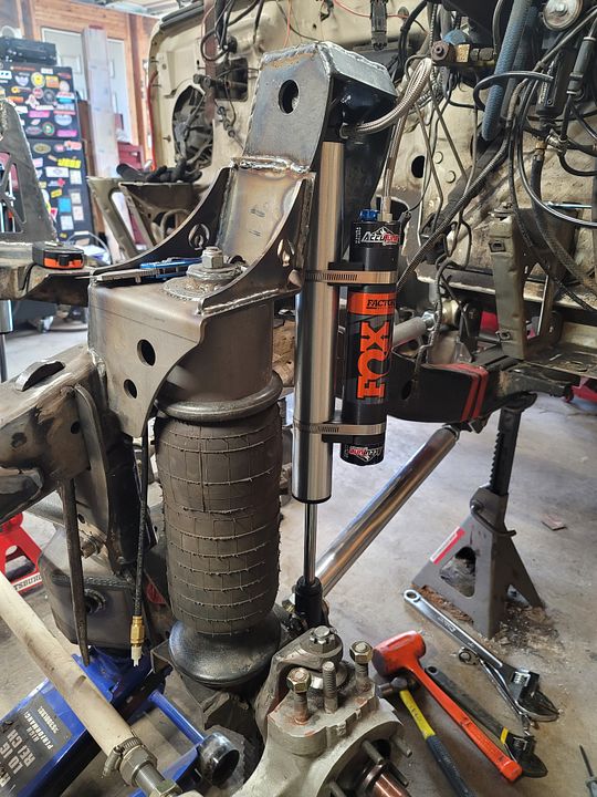

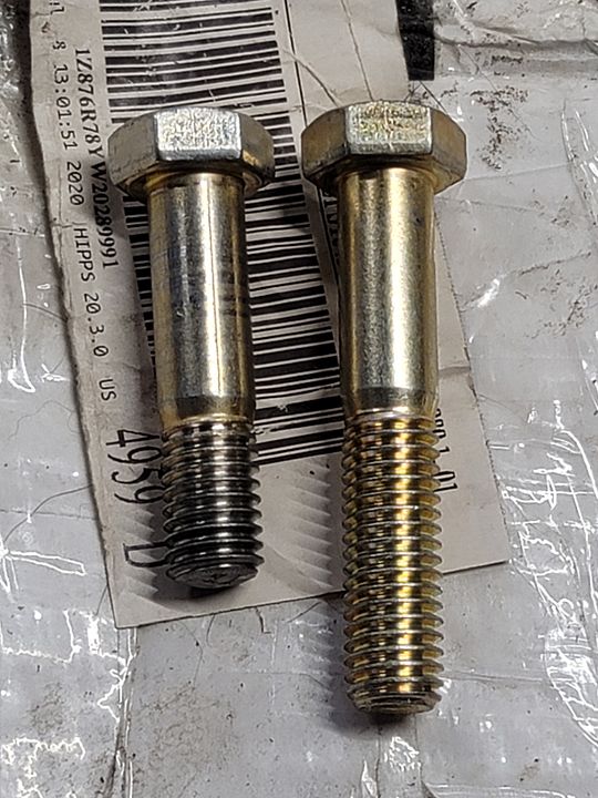

Here is the bolts I shortened up for the lower shock mounts.

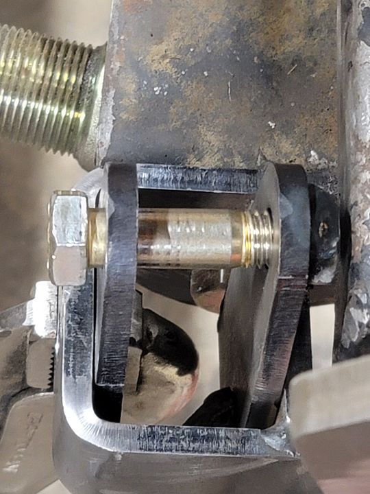

Then I tacked the shock tabs on.
Then I mounted the shocks back up to check for proper fit. I have the reservoirs mounted onto the shocks right now just to get them out of the way and not have them hanging around. I don't know if that will be where I leave them or mount them onto the frame.
Passenger side
And the Drivers side
And the lower shock mount bolt. I threw 2 flat washers on for now but will change them out.
The bolts just reach the back of the nut.
Thinking if I made the bolts just a little longer I could stake the threads on the bolts to help them not walk back out.
And now I need to decide if I need/want limiting straps and if I do where and how to mount them. I know I need to use something like a double shear tab.
EDIT: After some discussion over on the Wrangler TJ forum I don't need limiting straps. I'd swore someone had suggested them to me a while but but I could be getting having one if I have driveline bind confused with needed them.
So no limiting straps

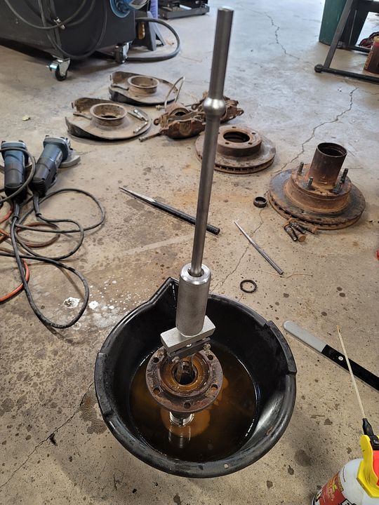

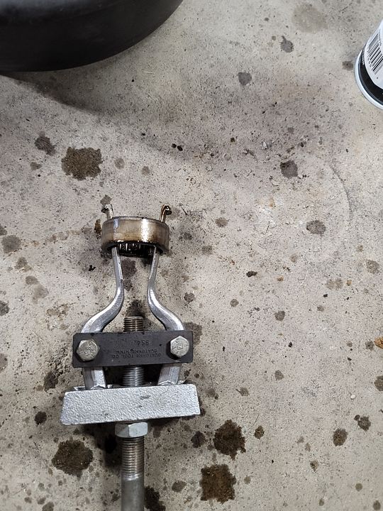

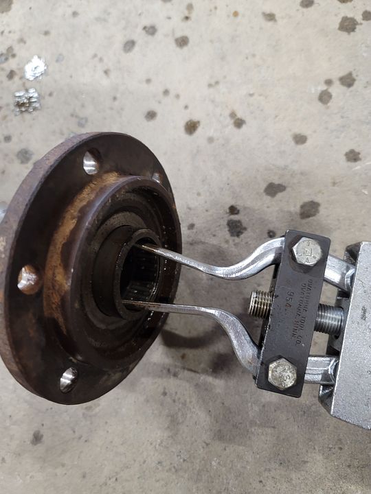

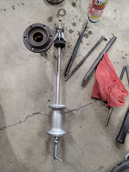

Well today started off with GOOD intentions and plans to get things ready so I could put my front axle back together. My axle was in bad shape when I had taken it apart from sitting and since I'd buried it in mud right before that everything was rusted. I needed to remove the inner spindle bearings but couldn't get a punch on then due to the design of the spindle. So out came the puller with slide hammer.
First one came out pretty easily.
WILDMAN
Cle Elum, WA
post #645 of 805 Old 09-04-2021, 08:53 PM Thread Starter
wildman4x4nut
Join Date: Dec 2004
Location: Cle Elum
Posts: 1,627

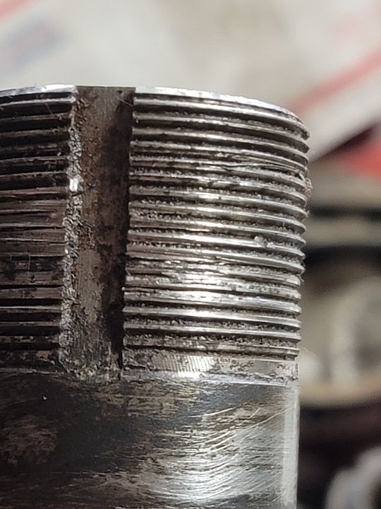

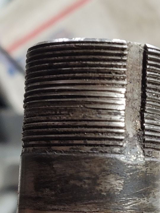

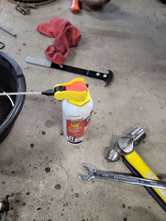

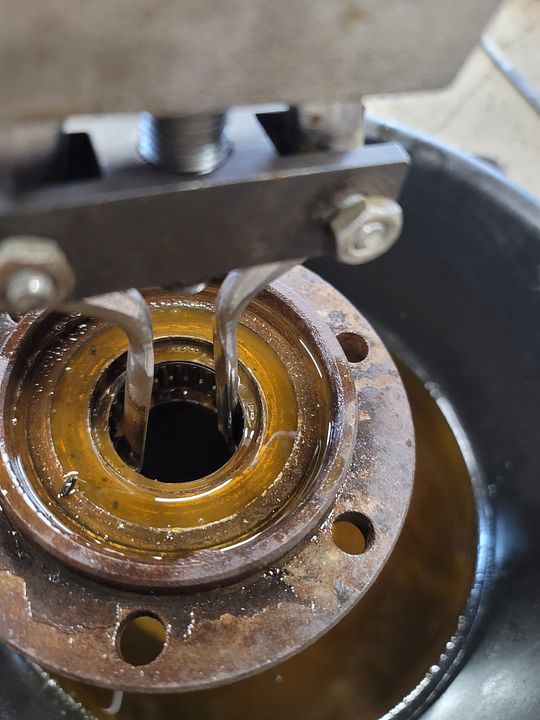

Lots of PB Blaster was used on both but the second spindle was not gunna give it up.
So I had to get out the BIB dog and use it to get that bearing out.

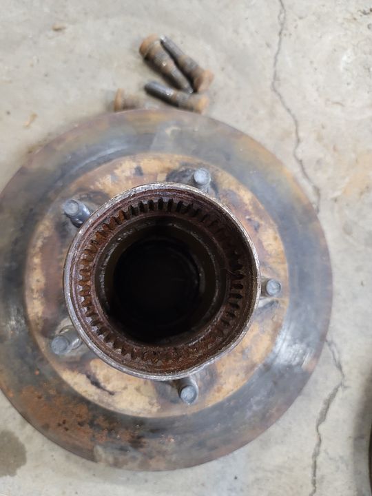

Now I should have been paying more attention to the spindles BEFORE I started working on them. One of the spindles has buggered up threads so I'm gunna have to order a new one. And while I probably could have gotten by with only replacing one I went a head and ordered two and I'll have a spare.

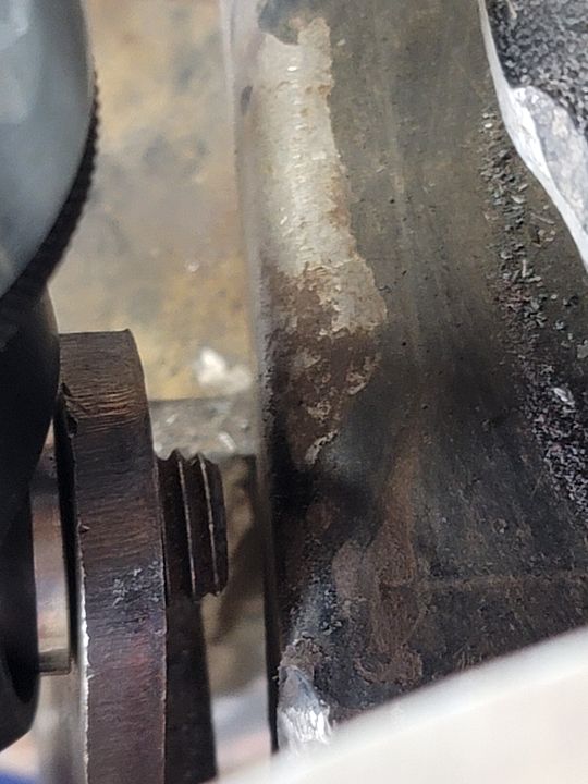

Then I started looking at my hub & rotor assemblies and noticed one of them is bent (not round) so I'm gunna need a new one of them also. So yep I ordered two new ones.
