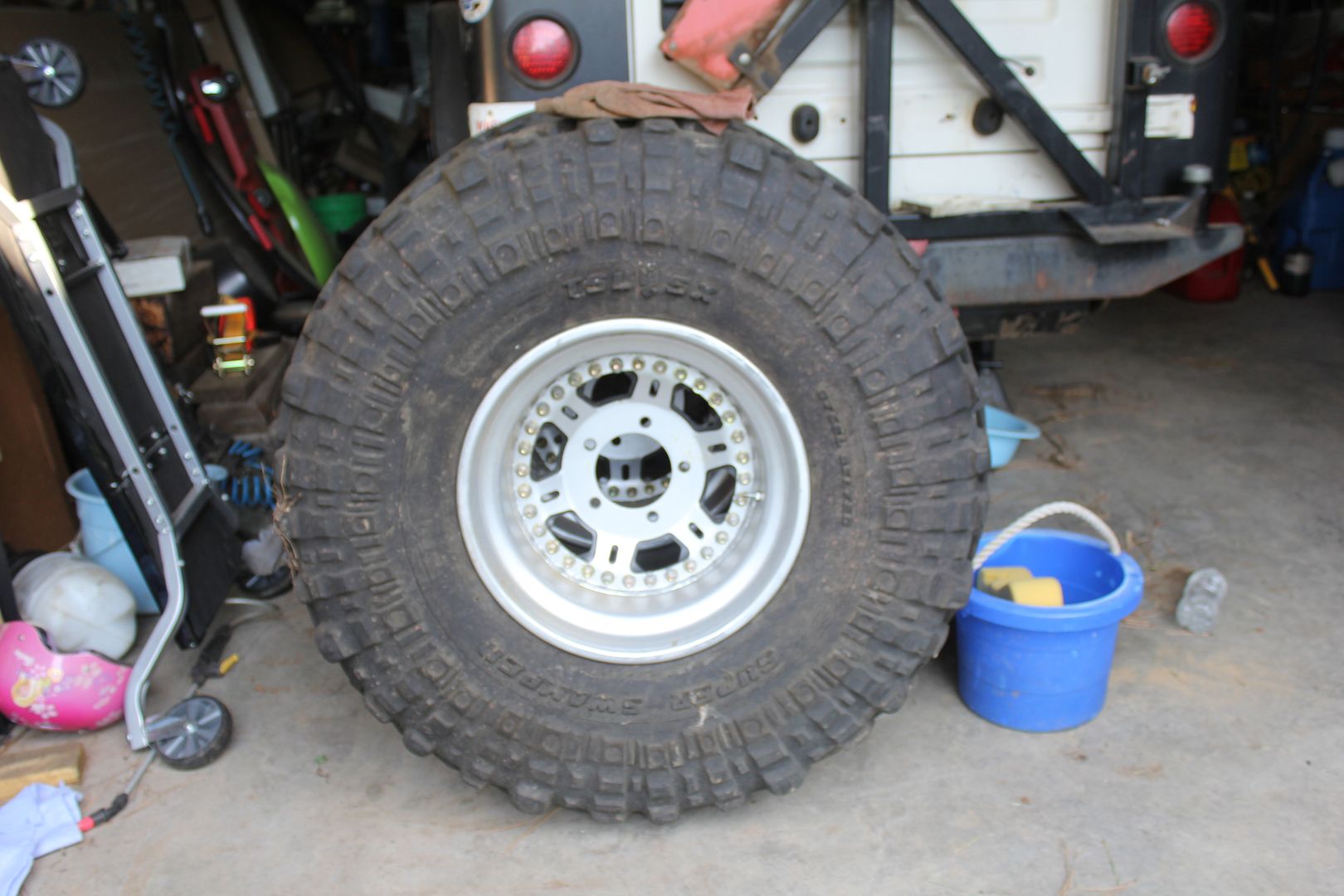

The vendor I got the centers from said he had gotten a batch of bad steel and that was the only thing he could figure out what happened. I had him make me 4 new rims instead of trying to make my own again. And he paid the freight because of the bad centers. I don't have any pictures of the new rims yet. But I'll get some and post them up soon.

When the rim broke on me I drove the Jeep to the main road and had stopped while I was thinking if I should try driving it back to camp. Well when I stopped and had pulled to the side of the road I had left the engine running. Now I had been having issues with the engine overheating and had installed a aluminum radiator to try and cool the engine. Well it worked sort of................................................ ............It kept the engine at 210* or close to it. Just as I was thinking I would try to drive back to camp I saw smoke coming up from under the hood. The wiring for my electric fan was on fire. The fuse hadn't popped instead it had burnt and so had the wiring around it. So because of the continued overheating issues I parked the Jeep and that is where it has been since 2010. I didn't have the money to get new rims or fix the engine at the time.

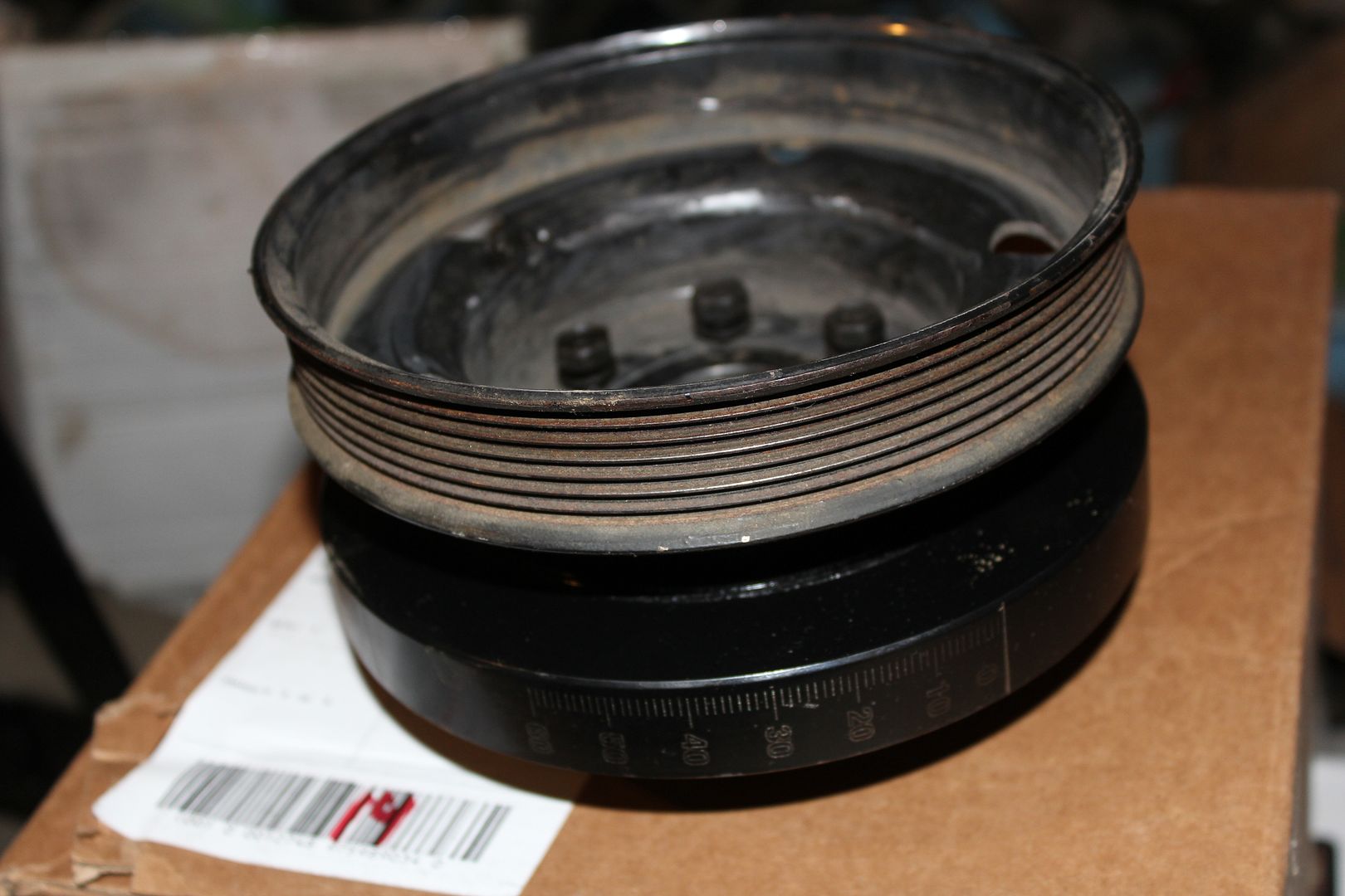

New harmonic balancer.

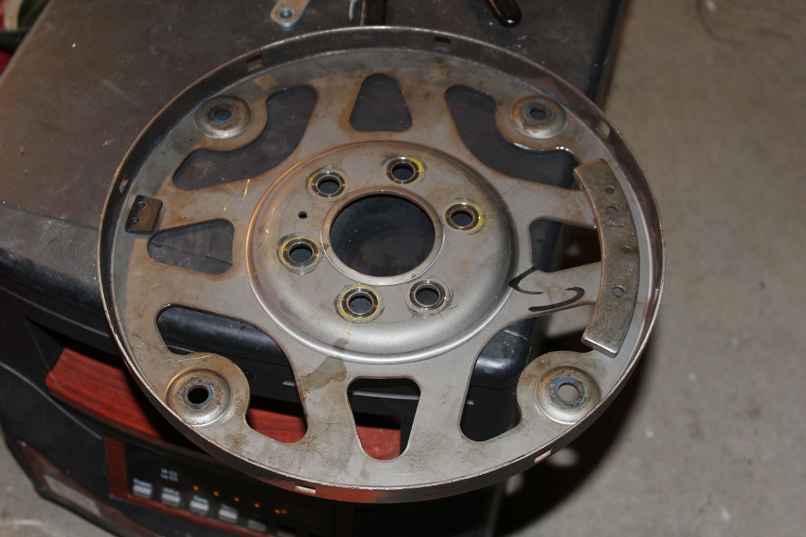

Container with the bolts for the flex plate & harmonic balancer. Got to love ARP stuff.

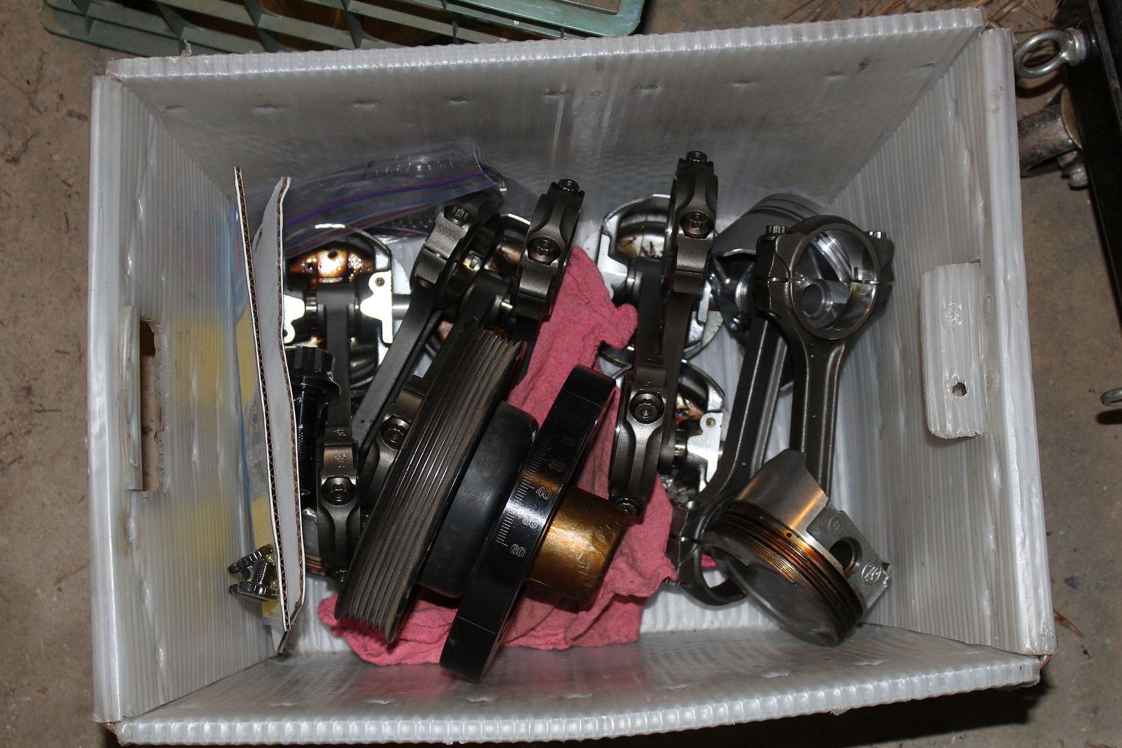

Container with pistons & rods, harmonic balancer & ARP bolts.

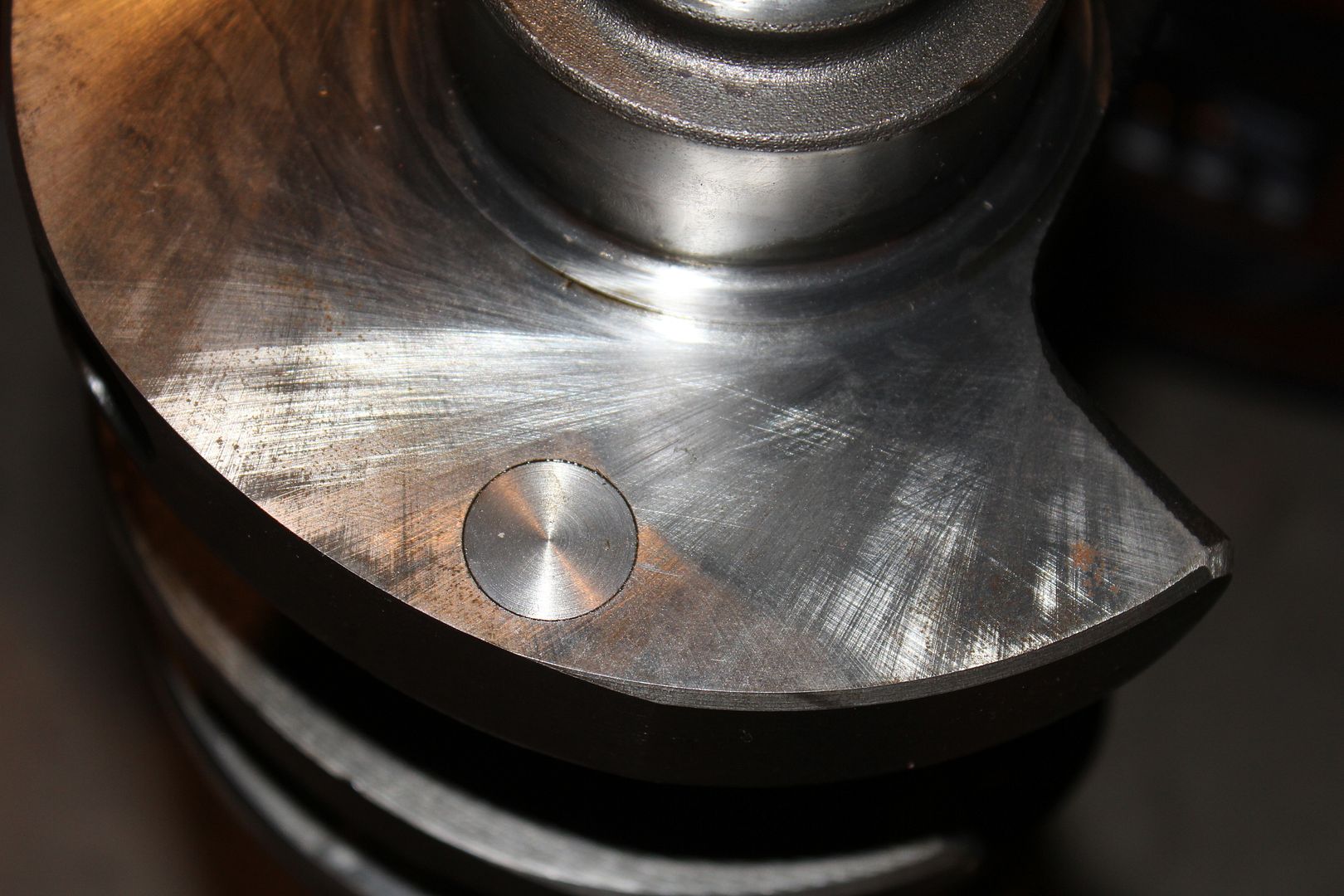

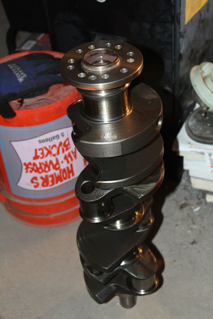

Now I have a question for all the guys who know more than me. Which is just about everyone.............................. :icon_dopey: Don't these weights mean that this is a internally balanced crank?
If it is a internally balanced crank then I think we have a problem Huston.
The shop that put this engine together for Derick C must be idiots if that crank is an internally balanced crank. Might explain some of his issues he had with the engine.
Here is the crank. I would think if this was a Scat or Eagle crank there would be something saying so on the crank.

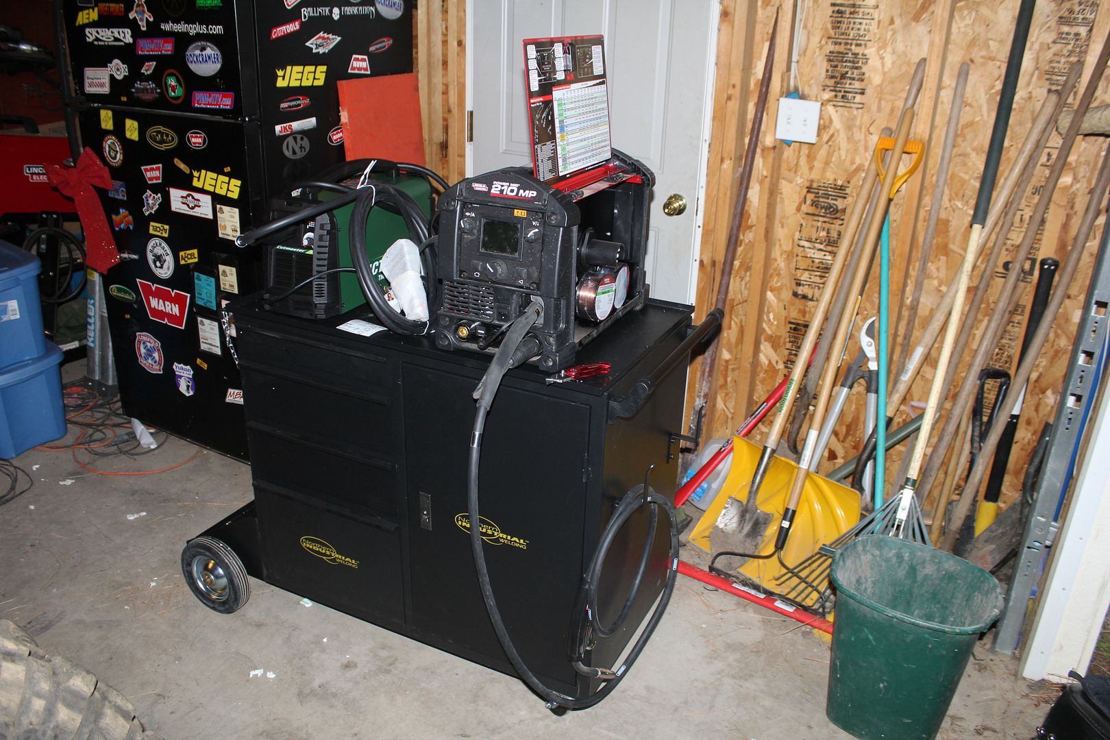

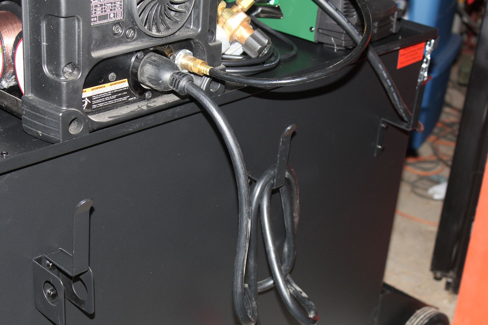

Well I didn't get anything done to the engine today but I did get my new welding cart put together. On top of that I got the my new welder on it and the plasma cutter too.
The reason I picked this cart is because it has, 5 hooks for cables.
3 on the back plus a bracket to hold the mig gun.
And then 2 more on the end below the handle.
It also has compartments on the door for your smaller welding parts.
And the top drawer is divided up for more small parts. I plan on using the door for mig and tig parts and the drawer for plasma cutter parts.
I cannot get this picture to work. I'll keep trying and maybe at a later date it will be working.
And then on top of that it has space for two tanks instead of just one. This way I'll have a tank for mig and one for tig on the cart.
Overall I am very happy with the cart and it is made very well. I got it off Amazon but it comes from Northern Tools.

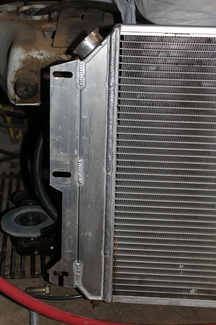

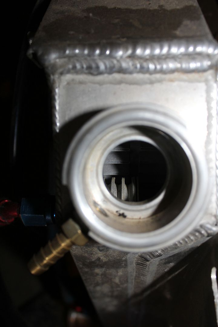

Okay all I have been looking at this radiator now for the past 6 months since I pulled it and want some opinions from others. If you look you can see the filler neck on the passenger side and the upper radiator hose on the drivers side. But the filler neck is the same height or just lower than the upper radiator hose. This doesn't seem right to me as how are you going to get the radiator completely full with it like this. Am I just confused or am I correct and this is wrong?
Just a few more pictures of the radiator.
If I decide to just use this radiator I still need to take it in and get the side mounts moved down 2 1/2" as the radiator sits to high.

so you plan on getting the v8 back together, new rims address the rad and youll be done ?
as far as the rad, i suppose you tilt the jeep up on the filler neck side. or fill it, and burp the **** out of the hoses and hope that a few heat cycles it will have sucked back in enough fluid and burped out all the air to be completely filled. but yes that does look very odd.

you could always add in a inline rad cap in the top rad hose. and just weld the fill hole closed and or just run another rad cap and just twin the lines together. but im probably missing something here, as are you. but it does seem like a silly design that could have been easily corrected by the designer of the rad.

Yes well like I said I have been looking at this damn thing now for 6 months and the more I look at it the more I hate it. I took some more pictures and I want everyone to look at the drivers side tank. Notice how small it is? I don't know squat about radiator design but that just doesn't sit right with me any more than the filler neck. And yes the simple solution is to just add a filler in the top hose.

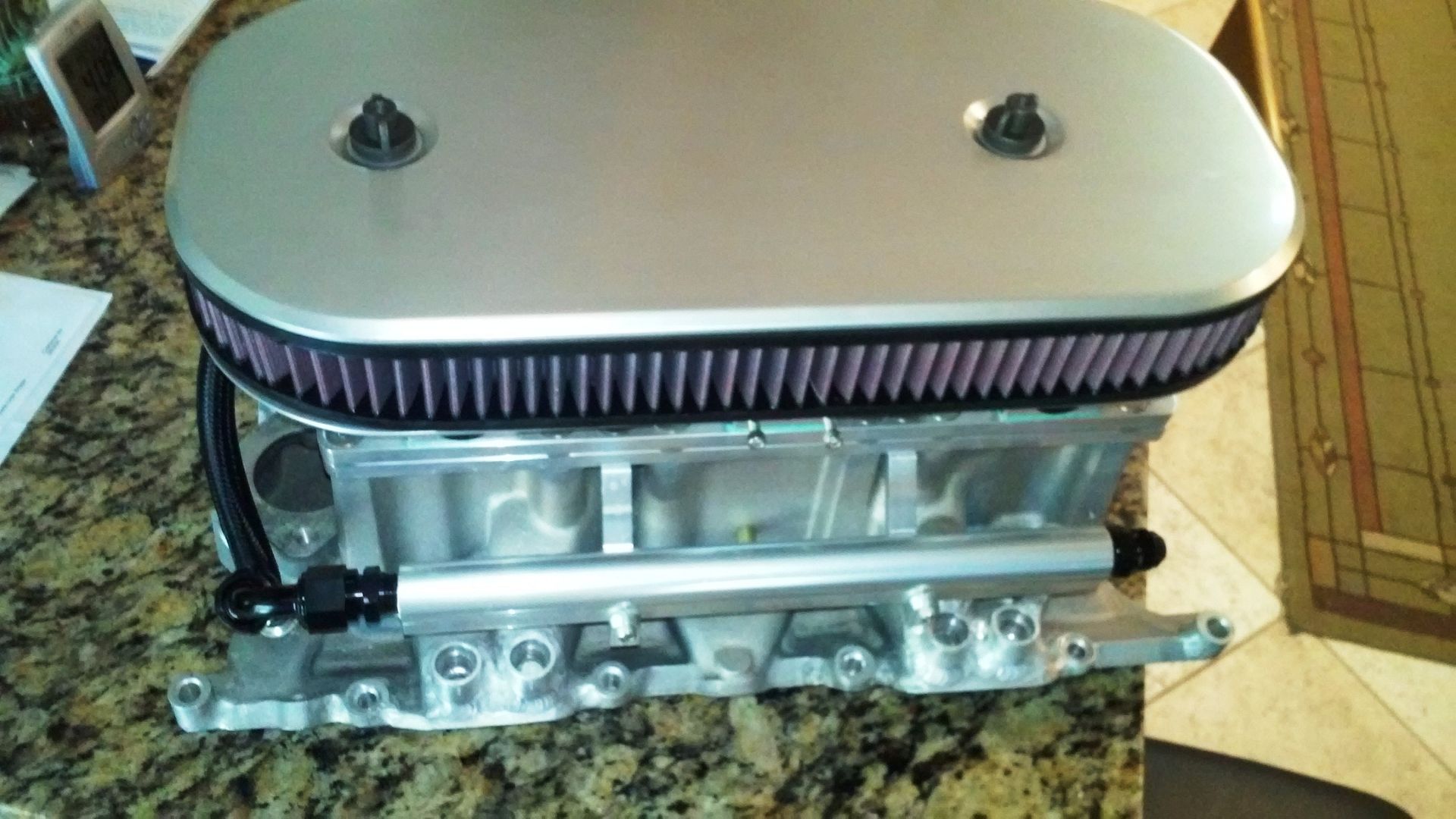

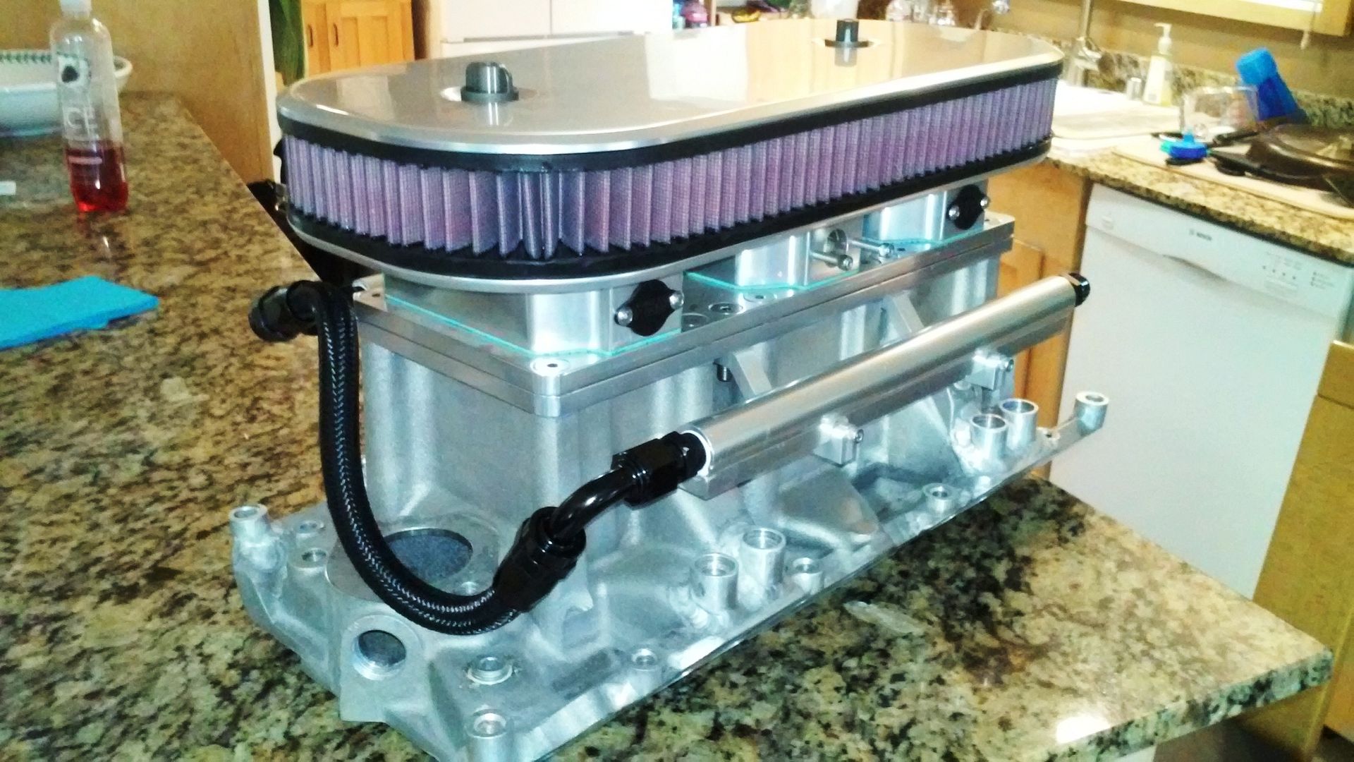

Well it has been a long time since I have done any updates to this thread. Not a lot has been happening other than I got my new intake manifold for the engine when I finally get it done. My hopes and plans are to have the engine into the machine shop next month. I should have it back in March and then I can start putting the engine back together. I need to get it done before June as I am going into the hospital for surgery and won't be able to do any work for a few months after.
Here is my new intake manifold.
This intake is made by F & B Throttle Bodies, http://www.fbthrottlebodies.com/ Now the last time I talked with them I was told this might have been the last intake they would be making for the Dodge magnum engine because the intake manifold they modified was not being produced any longer. It isn't a cheap intake as it sells for around $2,600 but I lucked out and got a heck of a deal because the intake was used. They are great people to deal with and I can't wait until I get my engine assembled and installed so I can hear it run.
Enjoy and I'll update as I get things done.
