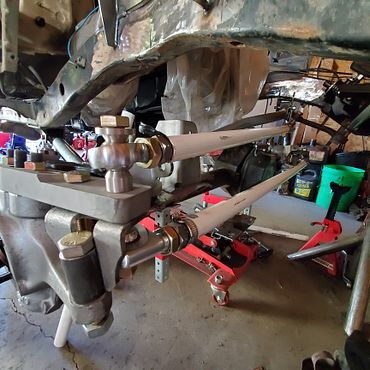

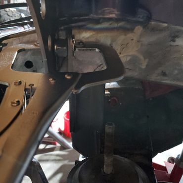

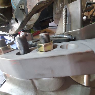

Worked on the trackbar placement over the weekend. Things are going to be TIGHT trying to get all this stuff in limited space.
Picked up some parts today on my way to my doctors appointment so can try and mock up the steering some tomorrow. Pitman arm just barely fits.
The axle side bracket for the trackbar just fits against the Rubicon Express spring pad.

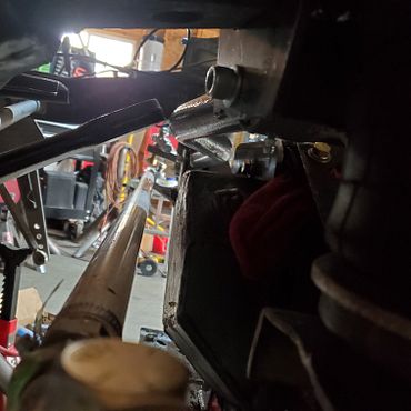

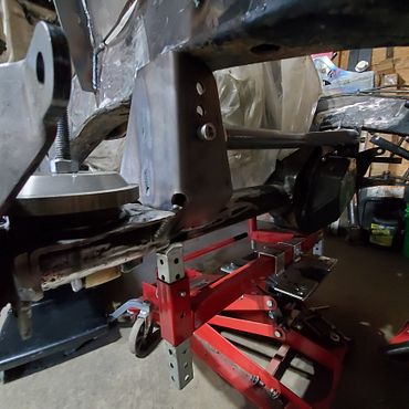

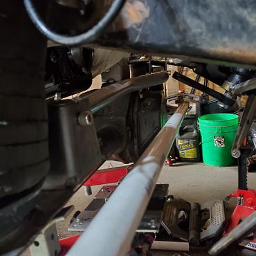

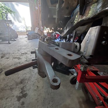

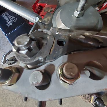

Messed with the trackbar a little more yesterday to give the pitman arm a little more space. So I moved it about a inch towards the rear of the Jeep.
Also install the diff cover so I could check it's clearance to the trackbar also.
I'm going to need to cut down the axle side bracket as it is hitting the frame and won't let it go to full stuff.
I had thought I was going to be able to mock up my steering but the PVC piping I have is the wrong size so I need to make another trip to towm.

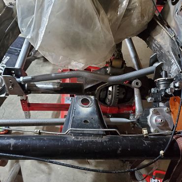

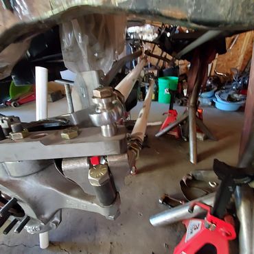

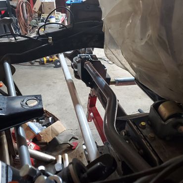

Started to try mocking up the steering between yesterday and today. And HUSTON We Have A Problem...........
The Black Magic swaybar raised mounts don't work with my high steer arms. And just to NOTE: These items were designed for TJ axles and not my Ford D44 axle.

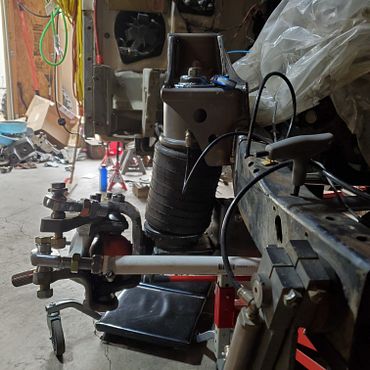

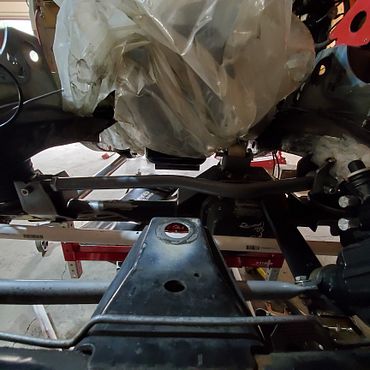

WOW, trying to get the steering and other things in the front just seems to take FOREVER.

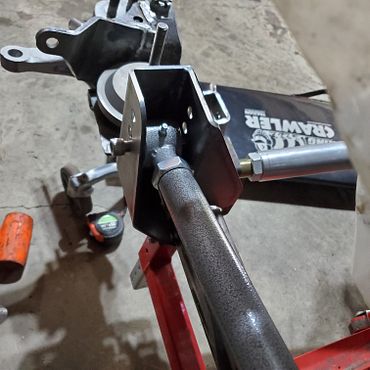

I started off my trimming the trackbar brackets at the axle and frame so they would clear. Then I tacked the axle bracket on and clamped the frame bracket on the frame. Moved back to where I had it to start with and everything clears.
Then I installed the air bags and inflated them to 8 PSI so I could see how they were going to clear everything. Plus with air in the bags it helps when flexing the suspension and allows me to see if they will touch or rub on anything.
So far all is good.
I compressed the suspension to 11" from the bottom of the bag to the top of the upper bag mount. This is where I want to set my compressed height of close to it. I will play with it some more tomorrow and see how much more I can compress the bags.

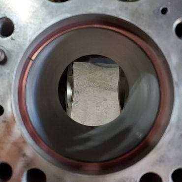

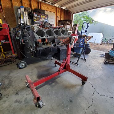

Yanked the block back out of the Jeep and got it mounted to my engine stand. This is just where the fun will begin.
So to start I need to file the piston rings so that they have a certain end gap clearance. Because of the KB pistons I am using and the Total Seal Gapless piston rings they require more gap than other setups. To make sure I got this correct I called Total Seal to double check the numbers that I was coming up with.
Top ring end gap is 0.036
And the second ring needs a end gap of 0.026
And the oil rings need a end gap of 0.015.
As I do the rings for each cylinder I am putting the rings in that cylinder. Once I am done filing all the rings then I'll install them onto that piston and set them aside while I clean the block. I still need to take the brushes to all the oil passages and water jackets. Then I'll paint the block and then assemble the engine.
